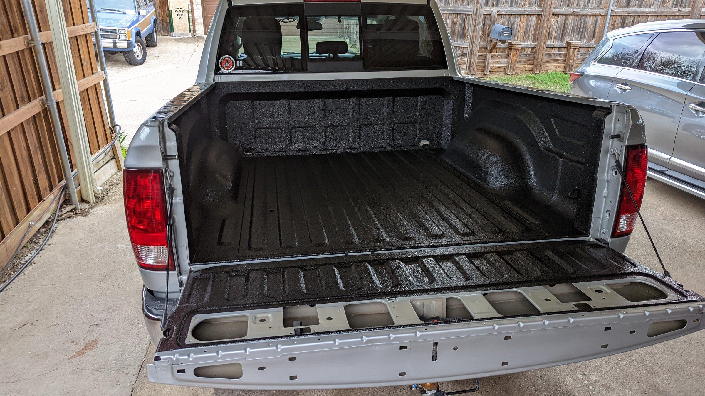

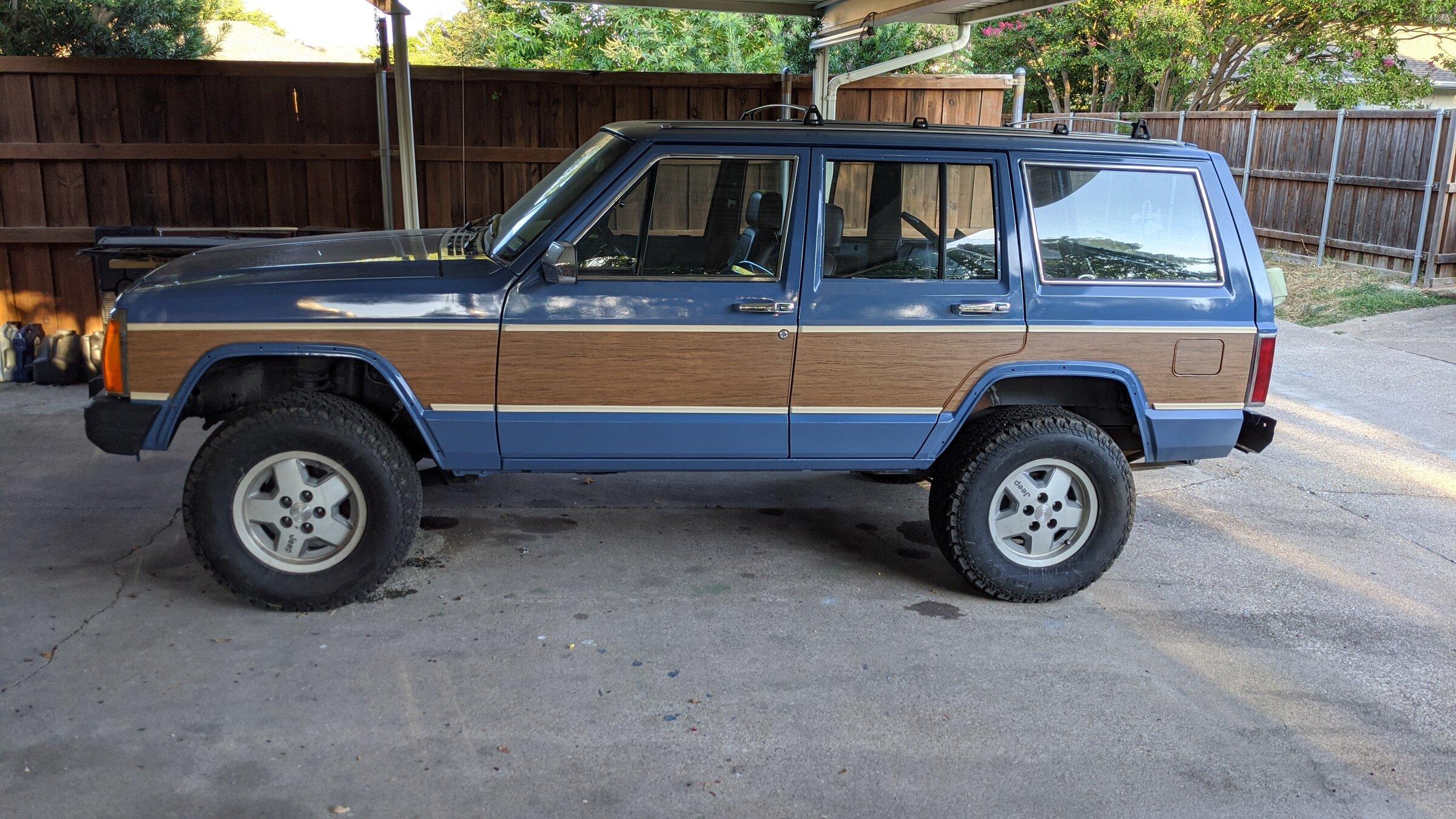

For what it's worth, I have used Monstaliner bedliner for both my Jeep rockers on my restoration project (rolled on, which it what it was designed for) and sprayed on with a cheap $10 schutz gun in my Ram 1500. It is a two-part catalyzed product and is 100% UV-stabile, so no fading. It's a really good product and not really all that expensive - you just gotta do it yourself. Best part - you can tint it into just about any color you want. They offer an array of colors that you can purchase (and free color chips), or you can go to a local auto paint dealer and get just the colorants (no fillers) for the color code you want. This is what I did for my jeep project to get a (nearly) exact color match.
