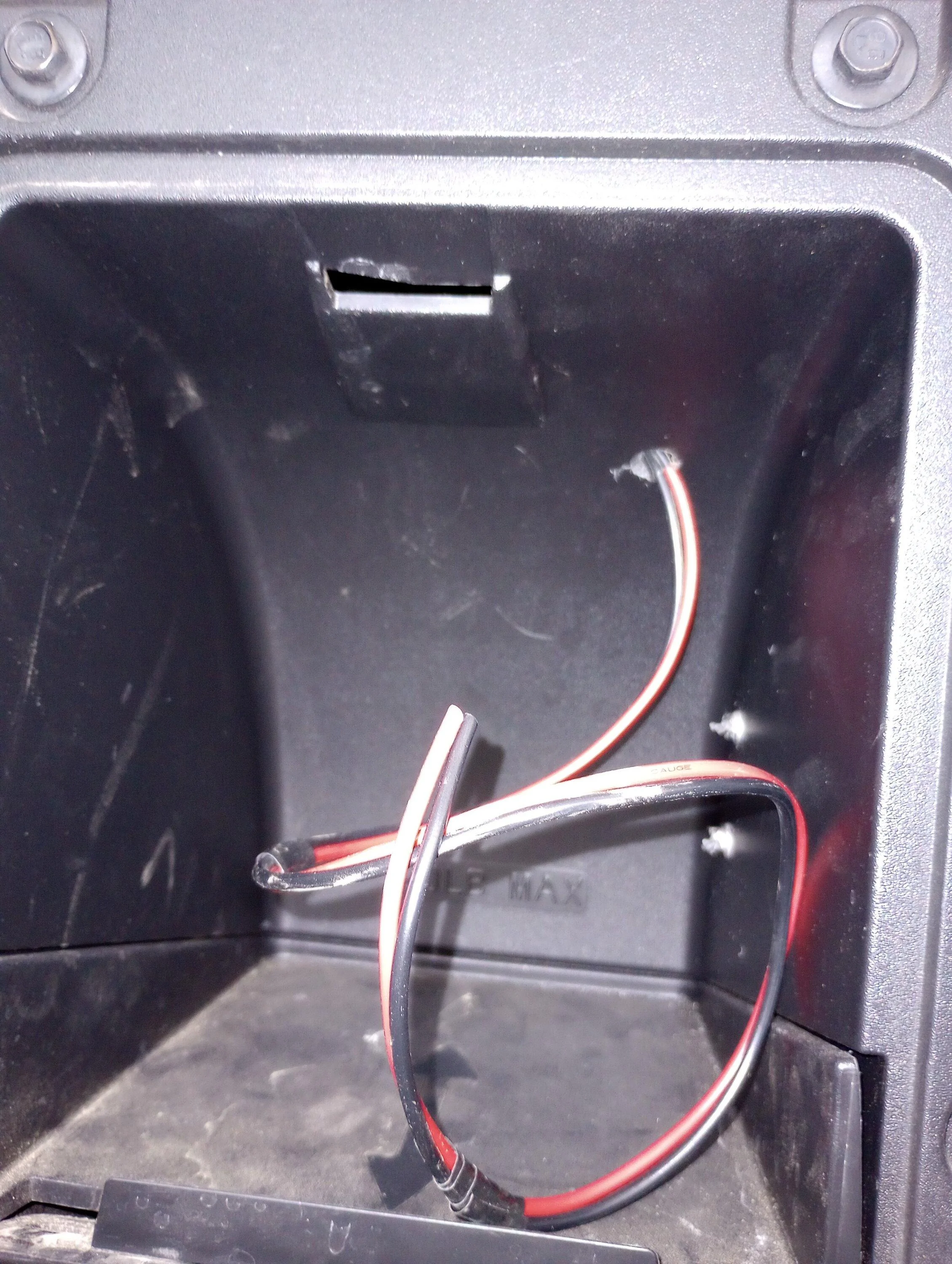

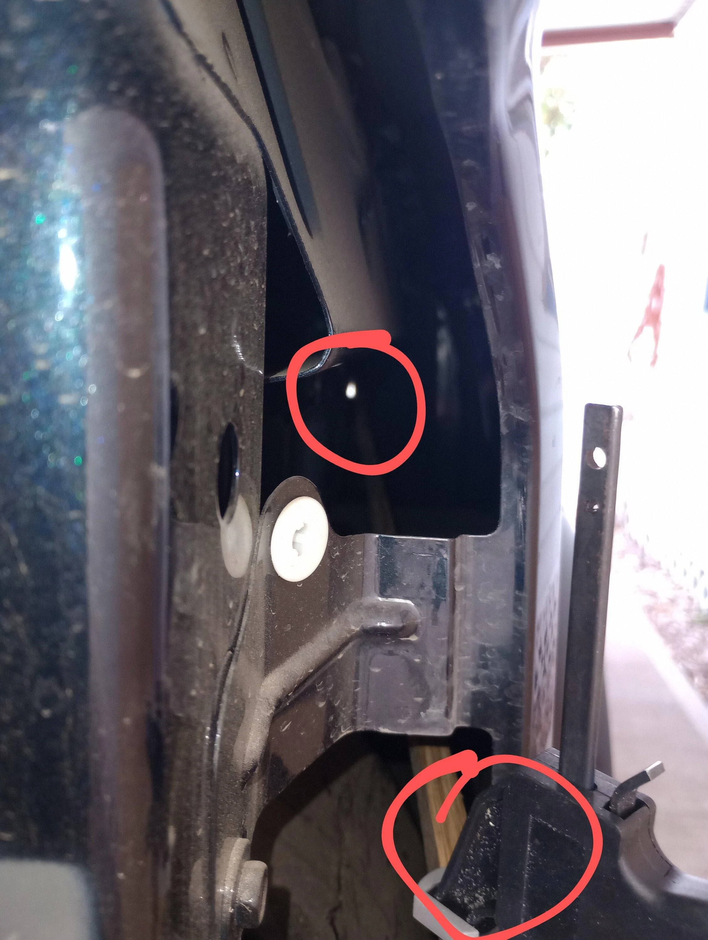

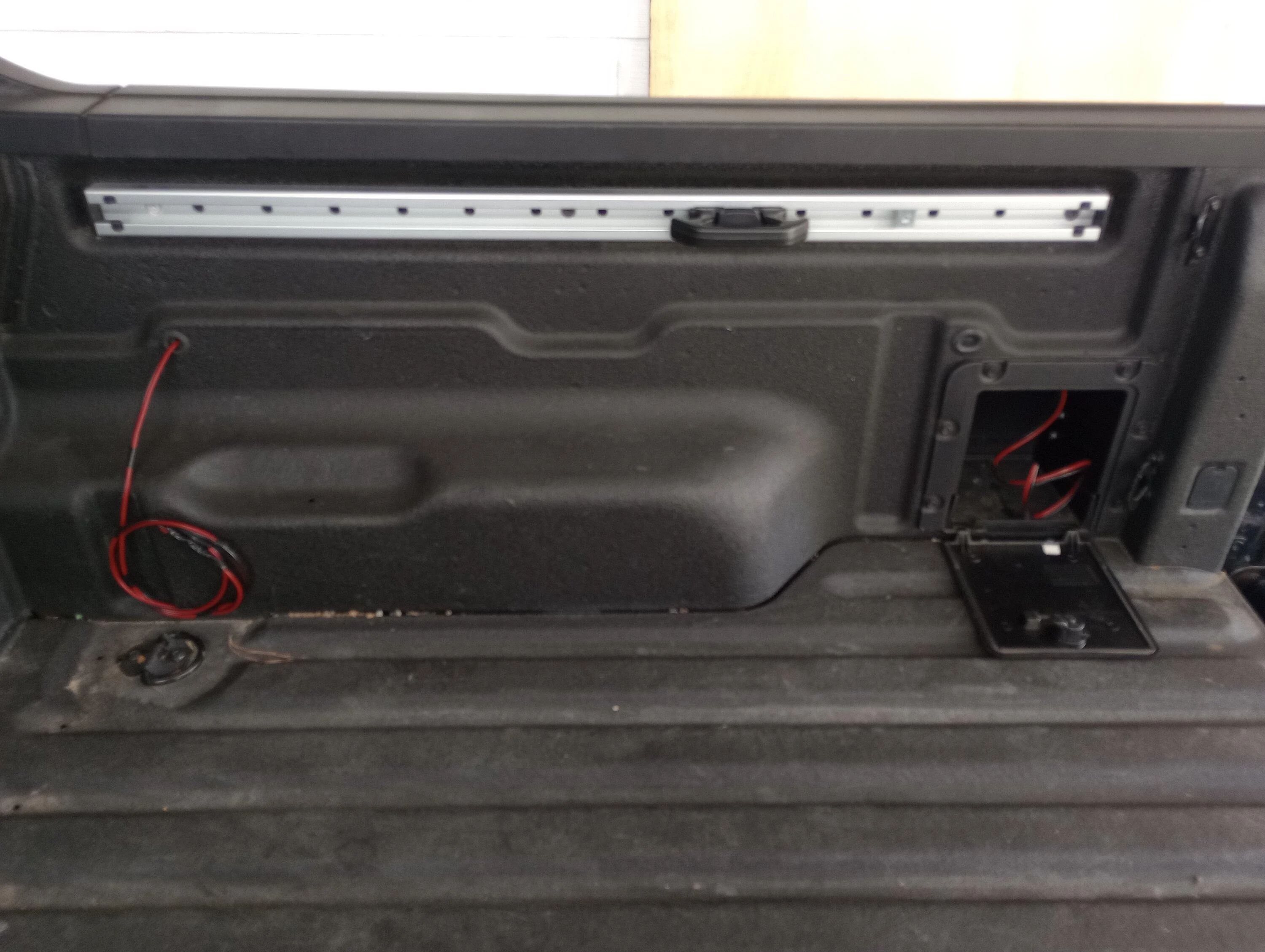

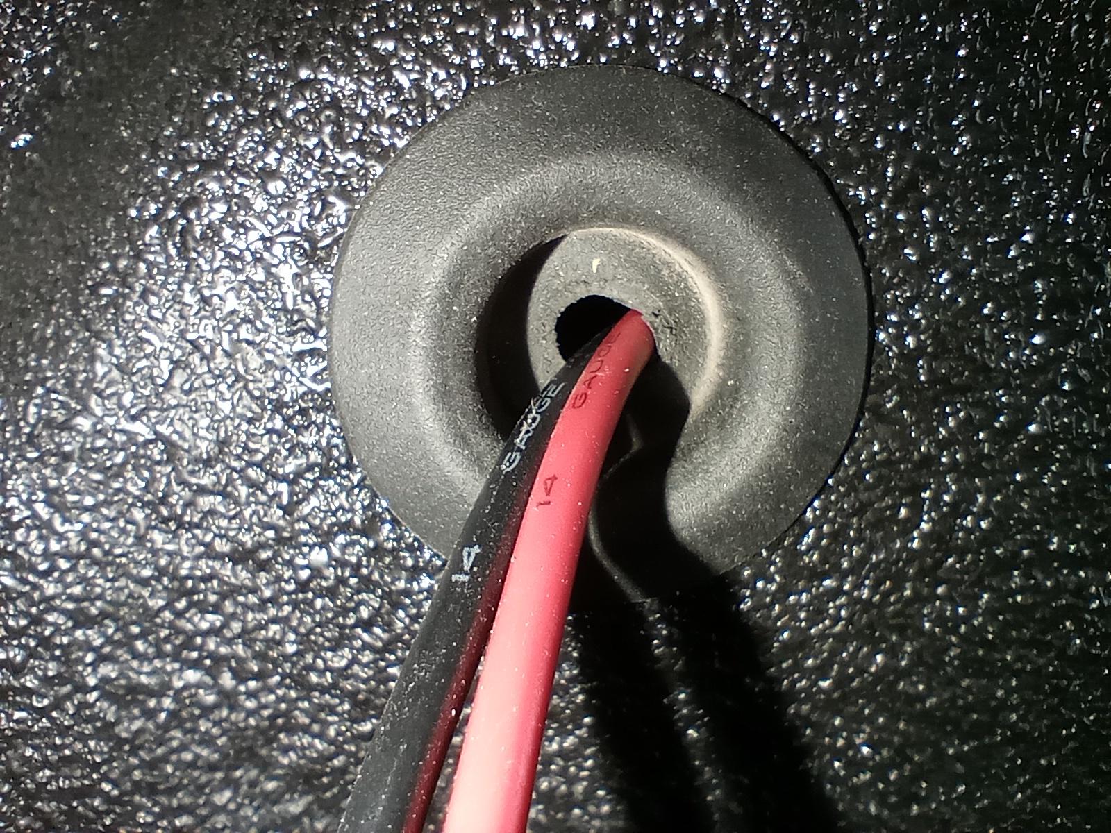

I answered my own question.
I pulled off the tail light and I was surprised at how open the sides of the bed are!
Since I was solo today, I pulled out the front grommet and put a flashlight on it. Then I used a piece of trim I had in the shop with a piece of string tied to it. I positioned it where I could see the light shining on it (lined up with the hole) and clamped it in place but it kept sliding down before I could get to it, so I used my roll of electrical tape as a cointer balance. 😂 I was able to grab the string with needlenosed pliers and used it to pull my wire to the rear cubby!!
