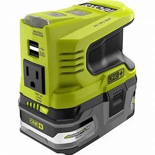

Speaking of portable power. As a test run at the beach one day. I ran my older 32qt fridge(OutSunny brand) on this lil ryobi 150 watt battery inverter with a 4ah battery. I got it almost down to temp on the 12v in our 93 ZJ then switched it to the inverter at the beach. I brought along a few batteries. I would run 110v for between 45-74 min on a 18v 4ah battery(of varying age). One day I want to get a inverter for my Ego chanisaw and whacker batteries. its 5ah at 56v. That could run for a bit longer.

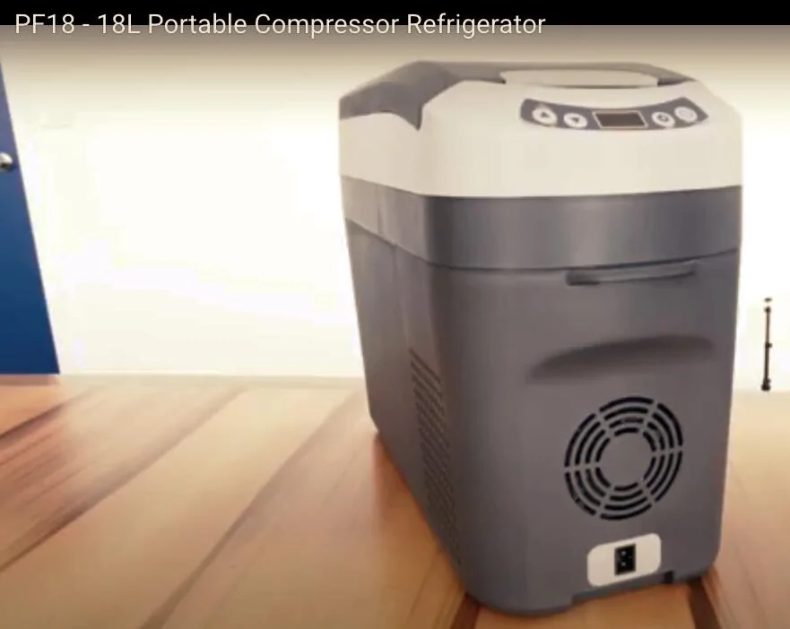

I am wondering why there is little to no information on the OEM Ford Portable Mini Fridge/Freezer offered as official FORD accessory for the Maverick and other Ford vehicles! it may be a winner, or it may be a bust, but I would like to see an operators/owners manual and some good reviews by actual users! You can see what little info there is on this Ford link: https://www.ford.com/product/portable-refrigeratorfreezer-by-indel-b-p2781858037 Prices range for $500 to $800 for the exact same pn form various dealers and ebay!! What gives? The pn is VLL3Z19J316A. Anyone have any info on it? Thanks all!
*** UPDATE *** I stumbled on this info just after posting the above: The Ford pn is VL3Z19J316A and a reference to another model or part#.. PB18. I searched for 'PB18' and got a hit for a 'PF18-18L'. It led me to a link for a portable mini fridge/freezer mfg'd by Radio Parts (radioparts.com). IT LOOKS LIKE A CLONE OF THE FORD TB18! Here is a video of it. Here is the owners manual. https://www.radioparts.com.au/Files...14BpK1wwefcbvFZFhwszXS1HYIaVscbarKSZmi7zHLbXf It is a 12v or 24v unit and just may be the prototype of what Ford now sells as the TB18??? Very interesting! I will try and post a pic for comparision.
