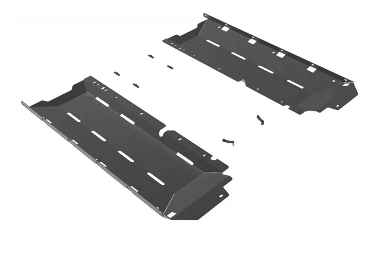

Looking for photos of dismounted under chassis components with the goal of upgrading off road protection. After market has been slow to meet the need.
Right and left side fiber mud/splash guards
Looking at JCR B-Sport EVAP and side skid plates as donor part that can be modded to fit. $400

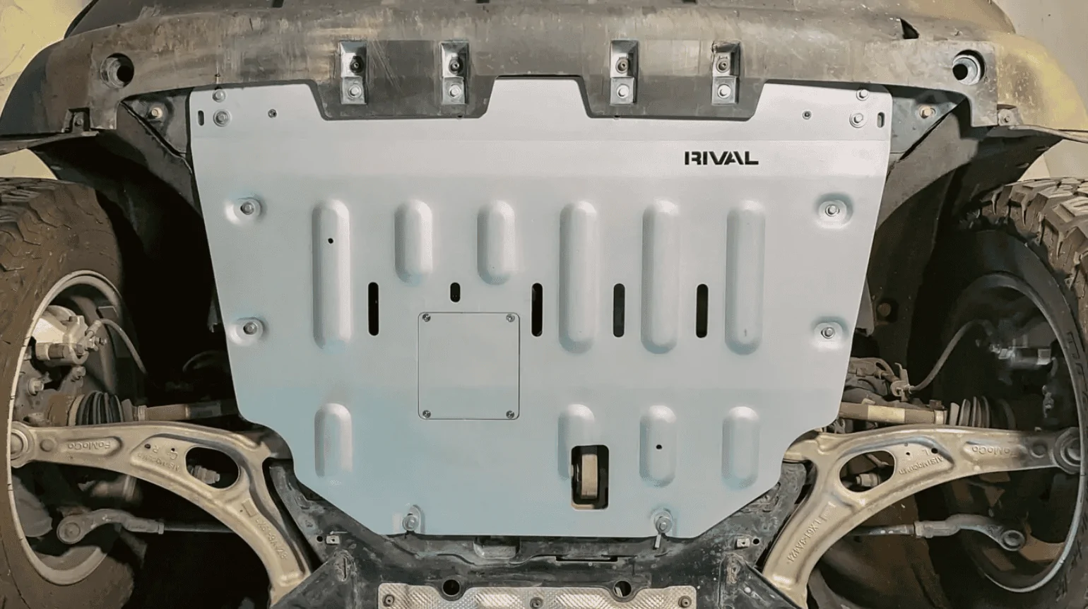

Tremor front skid plate
Looking at Rival aluminum front skid for non Badlands B-Sport for the same. $200

Appreciate the skid plate offer. Truth be told the front plate is of secondary interest since there is an existing one. I included it because it seems wider at the rear partially covering the front lower suspension mount and it's a pretty aluminum piece even with the useless trap door lol. The rear suspension mount looks to be out of danger as is. Even considering making it into a 2 piece depending on where the oil stuff is located.
The belly is where all off road Mavericks need the most help especially for the evap. If the belly is near as common to the Badlands as I expect the JCR parts will be a few mods from working. From watching their videos they seem to be heavy enough for some light bashing. They have a 90 day return so it's not a great $$ risk.
