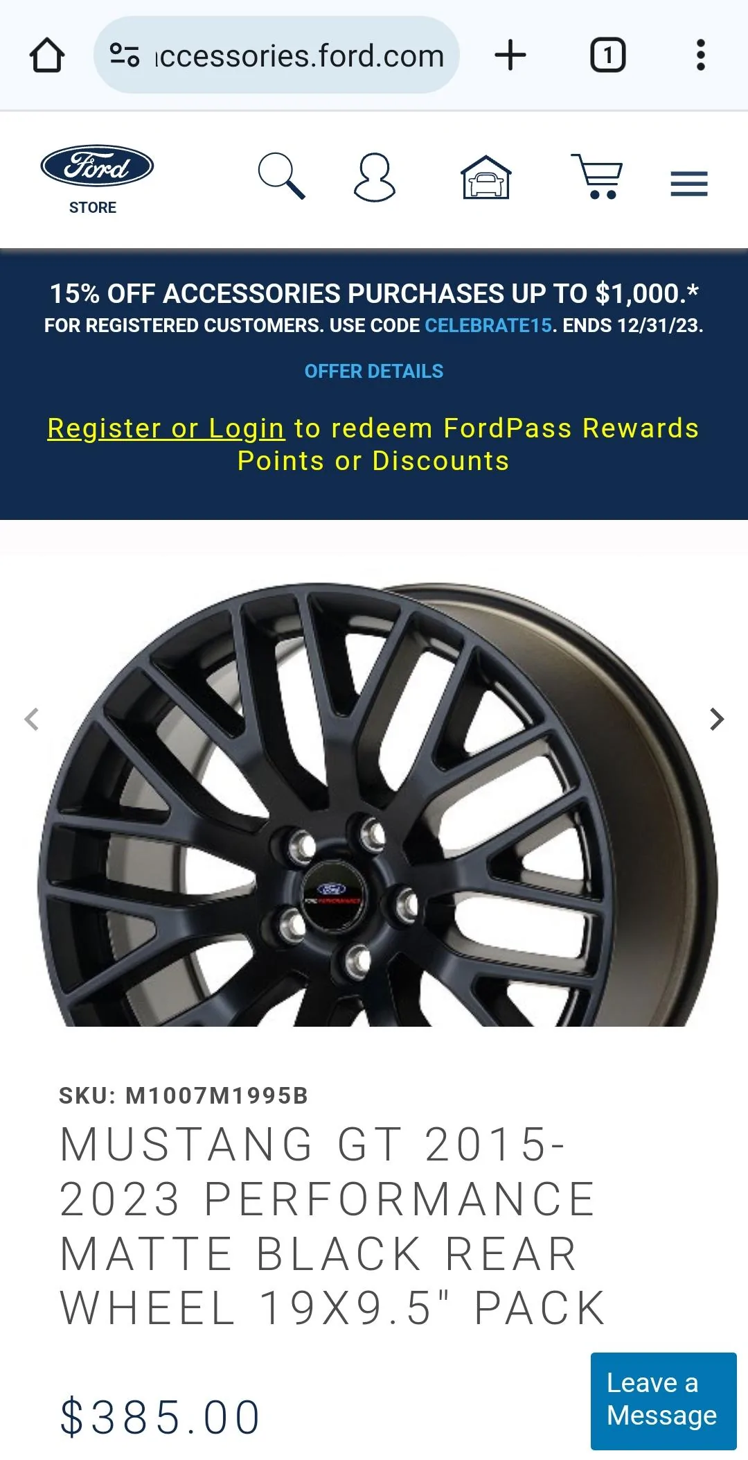

I asked my local dealership if these would fit my 23 Ford Maverick Hybrid and the service rep told they should. What are your thoughts 🤔

The Maverick bolt pattern is 5x108. The Mustangs are 5x114.3 (5x4.5).
Those wheels will not fit Mavericks.

Nope. That's the Maverick bolt pattern. Not the Mustang bolt pattern. I have both vehicles.

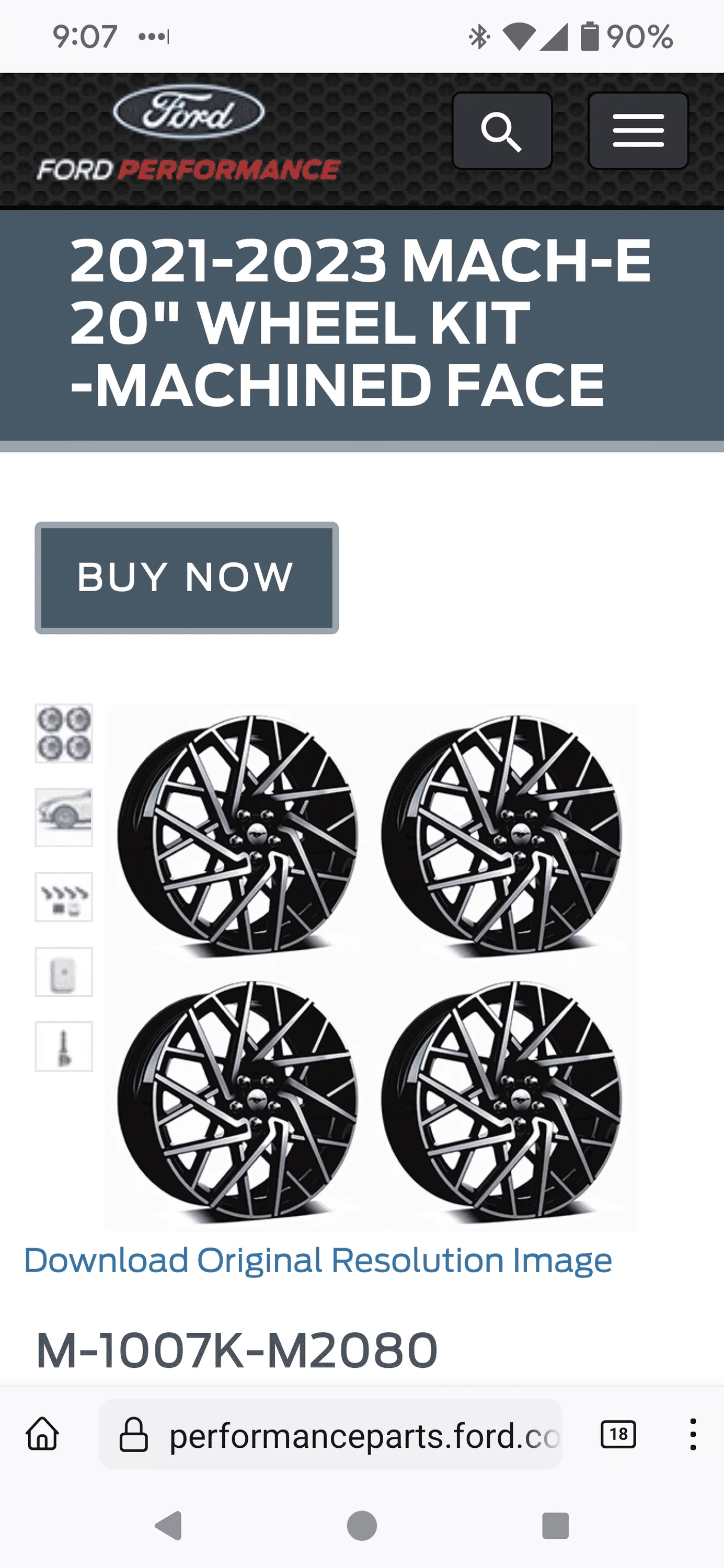

Mustang Mach E (Not a real Mustang) uses 5X108 bolt pattern. The Real Mustang Coupes use 5X114.3MM bolt pattern.

My first thought was that he was looking at wheels for a MachE, which are the right bolt pattern and offset.🤷‍♀️

Those are Mustang S550 coupe Performance pack wheels. Very different from Maverick fitment. Mach E wheels, would bolt right on.
