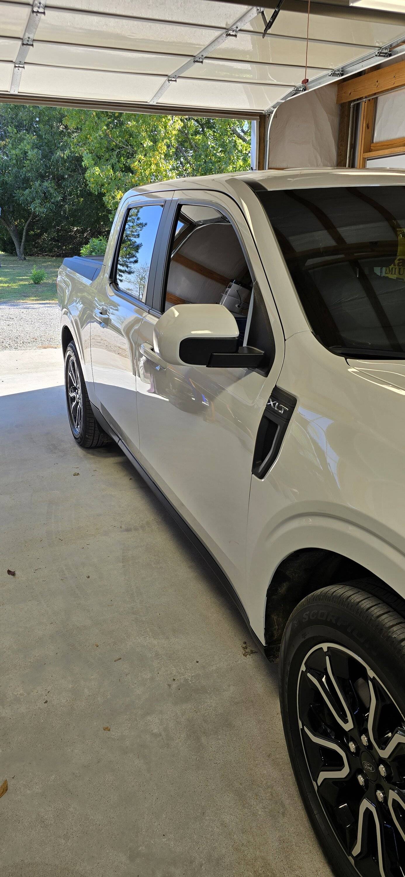

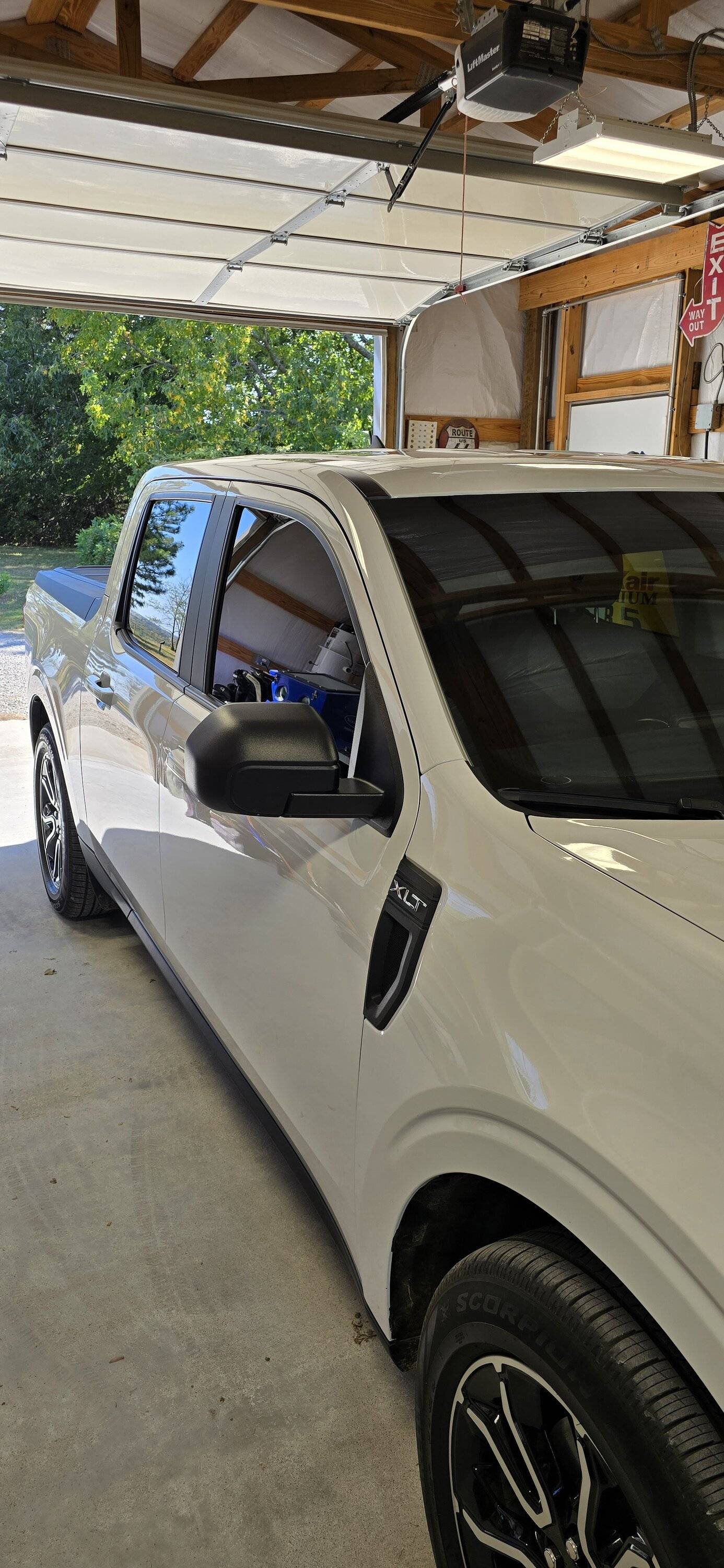

I wasn't too happy with my paint job on these, but I'm having them wrapped in PPF so the mistakes won't show. Anyway enjoy.

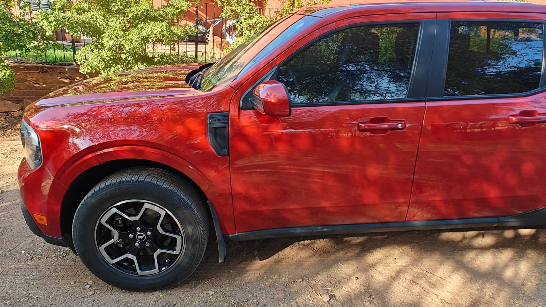

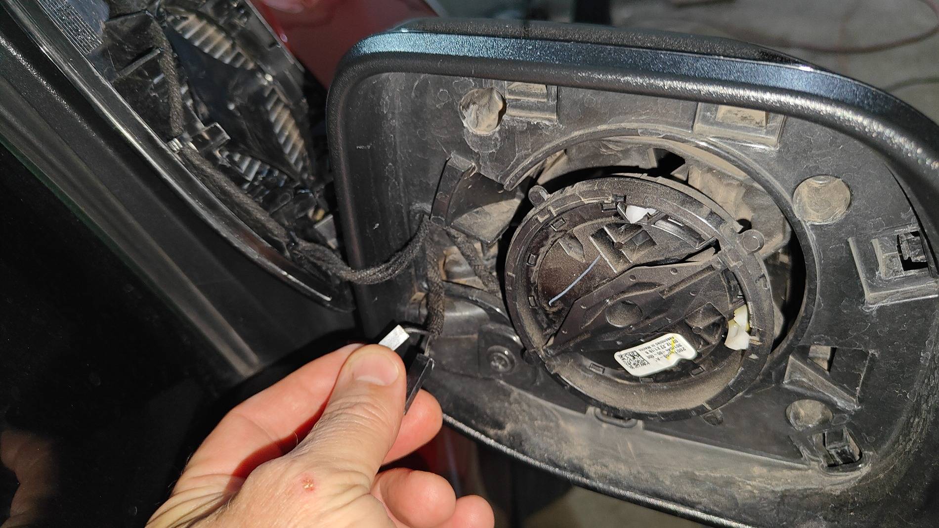

I did mine as well.. MY2024 Lariat w/ BAP... so the Mirror skulls/caps come glossy black. It's more work than you would think to remove them... Only did it becuase of recent repair work meant we were tackling the difficult Hot Pepper Red paint. I found a YouTube video that was useful for the steps and warnings it gave for removal.
Honestly, don't attempt it unti watching this video... It wouldn't have been my first choice, but it turned out to be the perfect tutorial for removing/installing the caps. His candor is priceless as it prevented me from making a few errors.
Little scary to pop off that glass and then start disconnecting wires undoing clips, screws, more clips and working everything off without breaking it... (again video helps)
Ford Maverick Painted and installed mirror caps IMG20250407191221
They came out fantastic. I am really pleased.. it definitely improves the fit and finish of my Maverick.

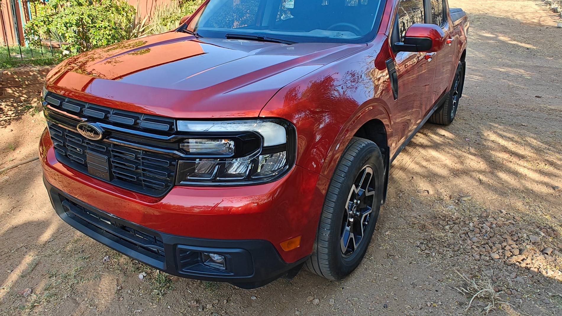

Ford Maverick Painted and installed mirror caps IMG20250410165252
Thought about doing the grill cross bar as we removed everything for the Dynamic Diode Elite Fog lights, but in the end decided to leave a bit of the BAP for the front end as it blends well with the darkened logo.

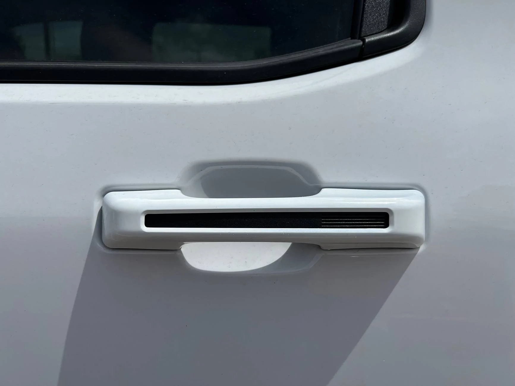

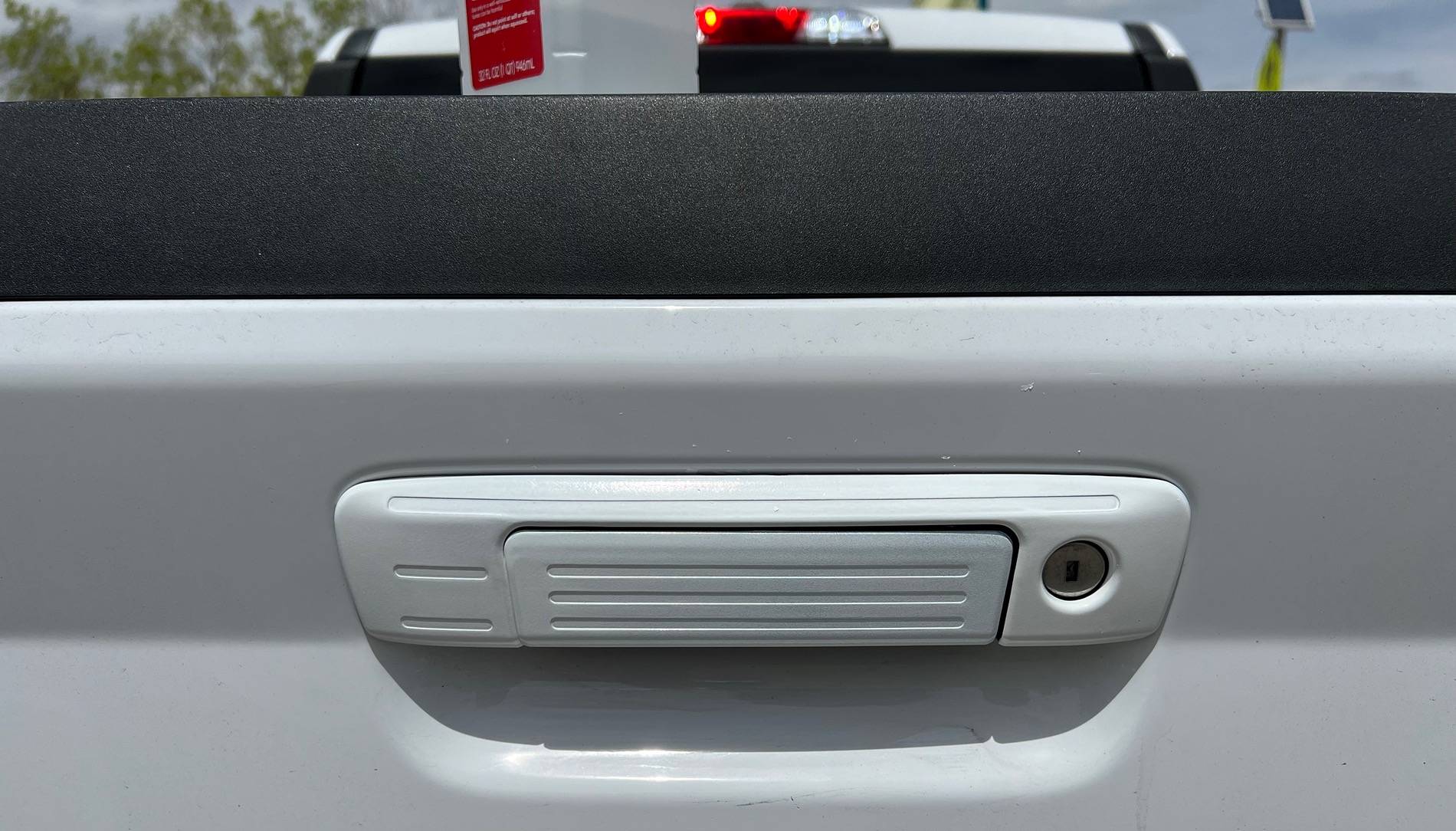

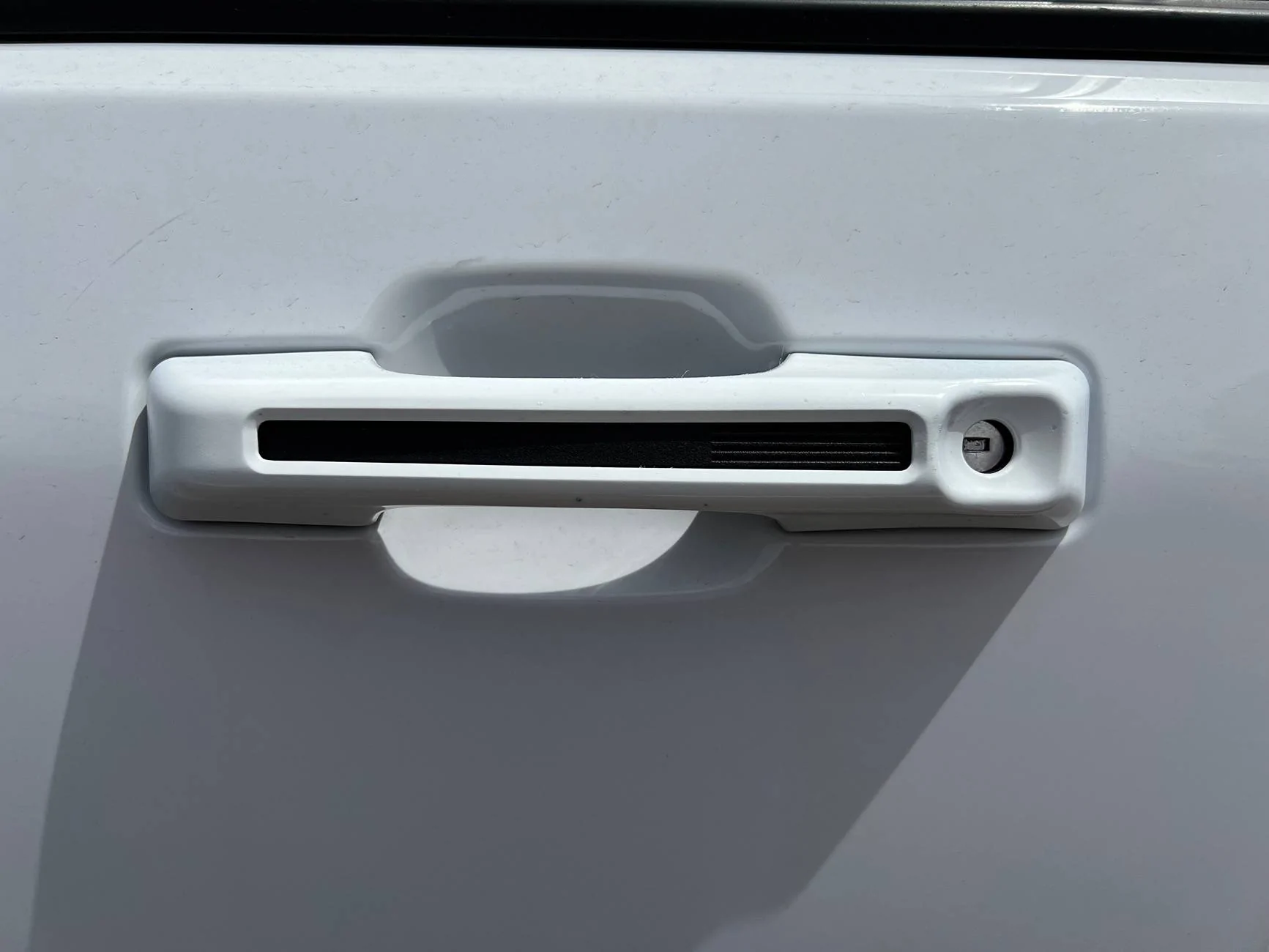

🤓 That’s the smart way, I got my mirror caps if I remember right on AMAZON. Also all the handles. 🤓
