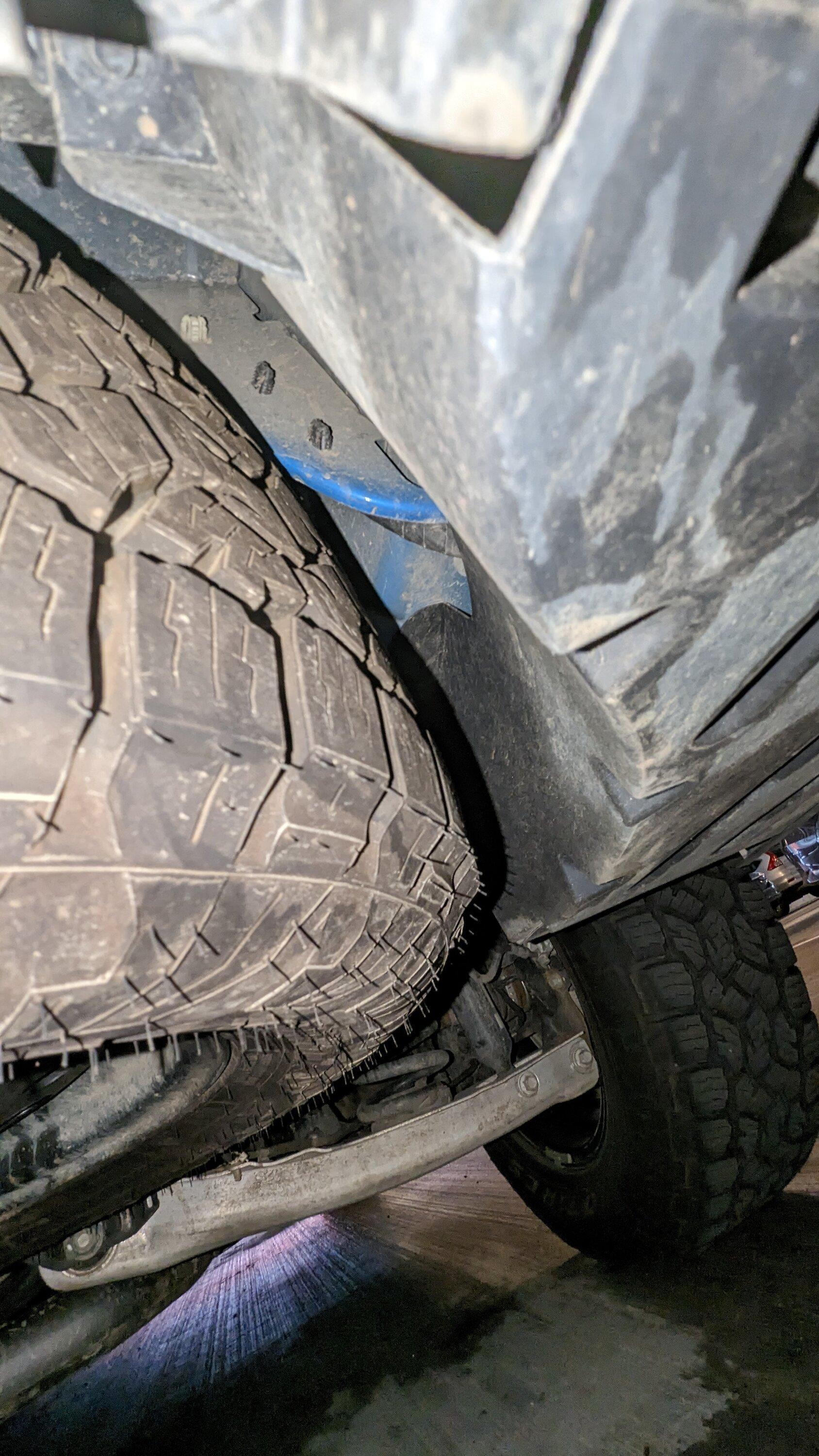

I think there is some debate about "fitting fine". The Maverick has some jagged metal "shark teeth" on the edge of the spare tire well that are supposedly there to puncture the spare in the event of a hard rear collision, thus reducing the chance of intrusion to the fuel tank. The larger wheels will sorta fit, but not within the OEM shark teeth. They end up having to rest on top of the teeth, thereby making them ineffective.

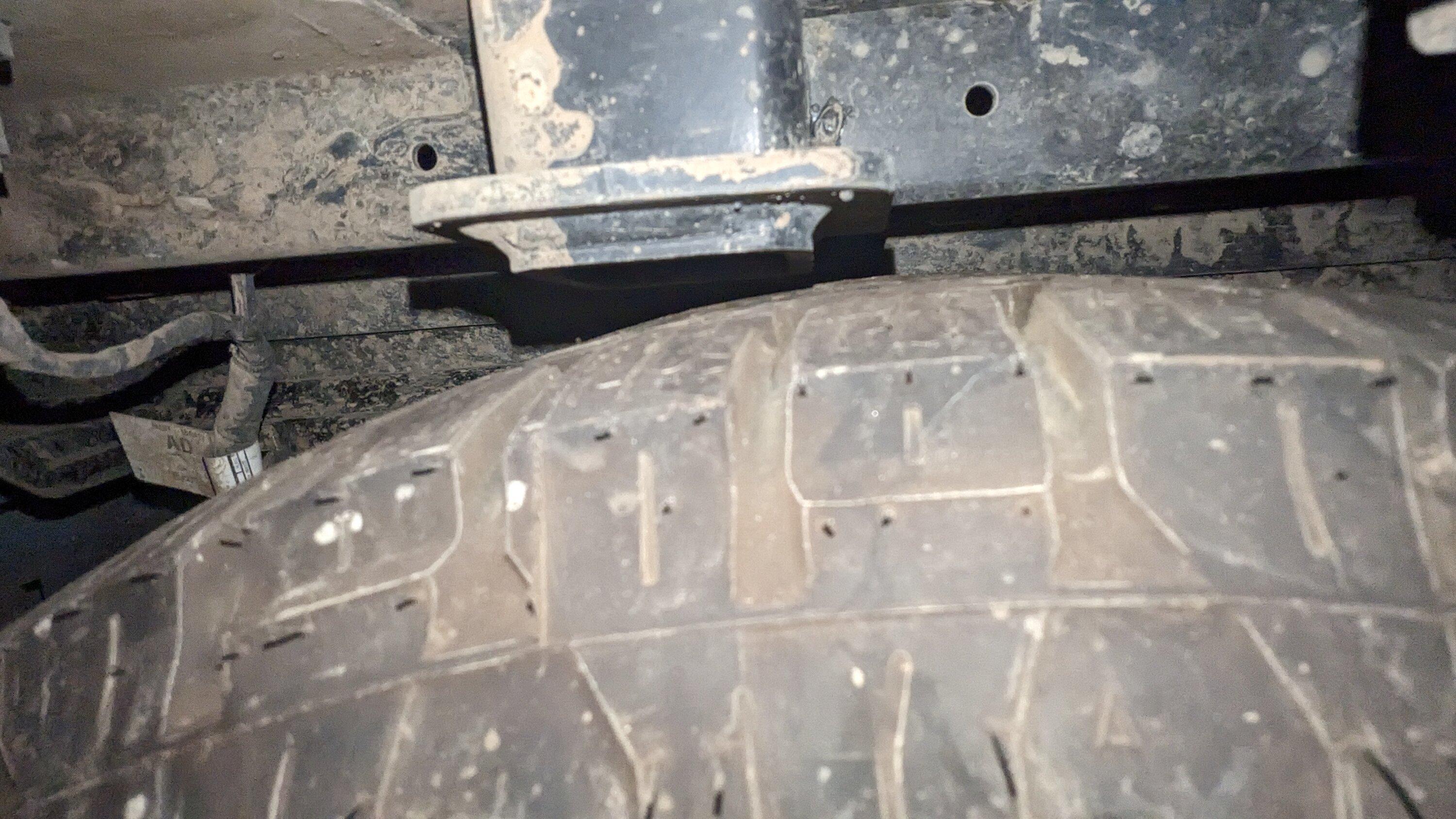

Folks are right...doesn't fit with the teeth. So yes, it is riskier than the smaller tires if you get rear ended. This is a 245/65R17 with no tow package.

I keep hearing about the tow package, but I'm not sure that makes a difference. The hitch takes up some room, but I think its the same with or without the 4k tow package.

There looks to be space between the tire and the hitch. I have a matching tire I need to get mounted.
