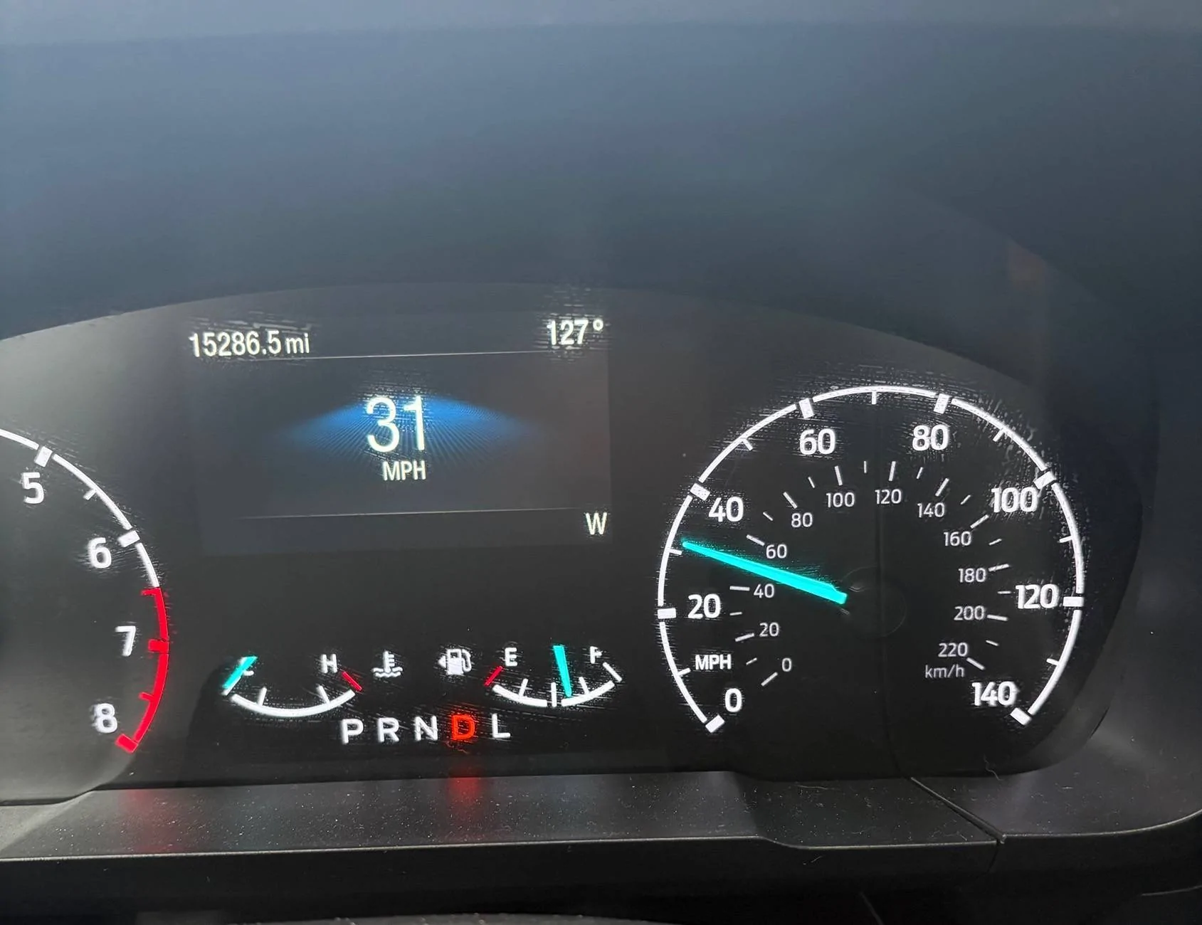

Posted this earlier on another topic. I’m driving a 22 XL Eco Awd 4k. I’ve had the same issue since day one and gave up trying to fix. When cold the truck would hesitate/buck/jerk. Tried taking to dealer several times and always ntf.
Recently I had a new issue (see pic) where my outside temp showed 127 degrees when it was 10. Heat set at 85 would blow cold. The dealer replaced the ambient temp sensor (inside fender liner) and after that my cold start/hesitate/buck/jerk problems disappeared.
Could be coincidence. Never changed trans fluid always run 87 octane..Just my two cents…
