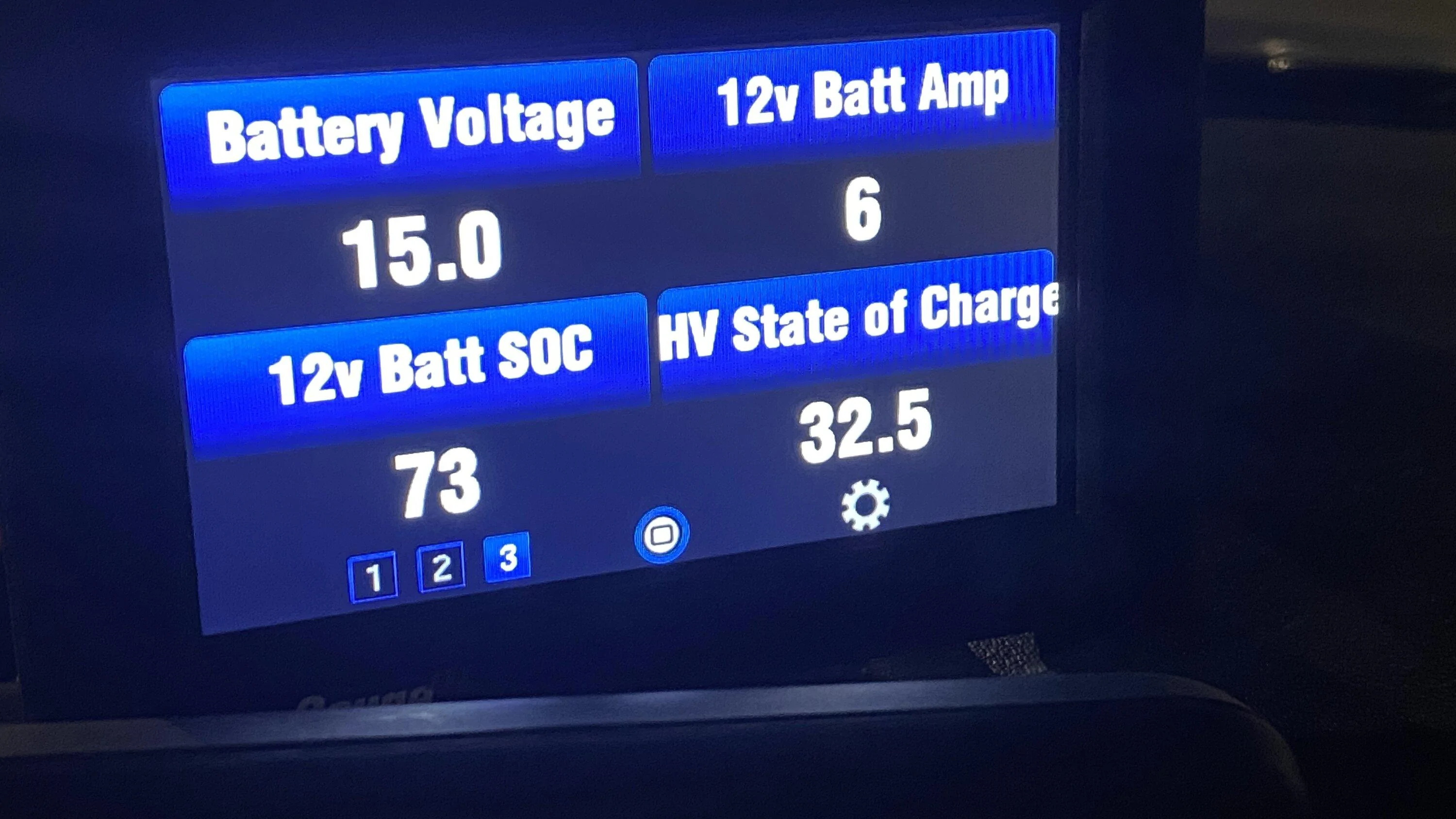

The suction cup can attach to glass, or the little side cubby, or the flat spot on top the cubby & tray behind the center screen. Then attach the unit with magnetic pad. The cord is a standard ethernet cord. I bought a 3 inch cord online for like $1.50. This 3 inch is always attached to my Scan Gauge. Then I bought a female/female ethernet "coupler". This always stays attached to the OBDII cable.
Now when I attach and detach daily, I only put wear & tear on a $1.50 cable and .99 coupler. I have no fear of damaging the pins or ports on the expensive unit or OBDII cable.
Ford Maverick OBDII Questions IMG_3564
I drilled a hole the size of an ethernet jack into the tray behind the screen. The wire is mostly all in the dash. The hole is not visible from either seat.
