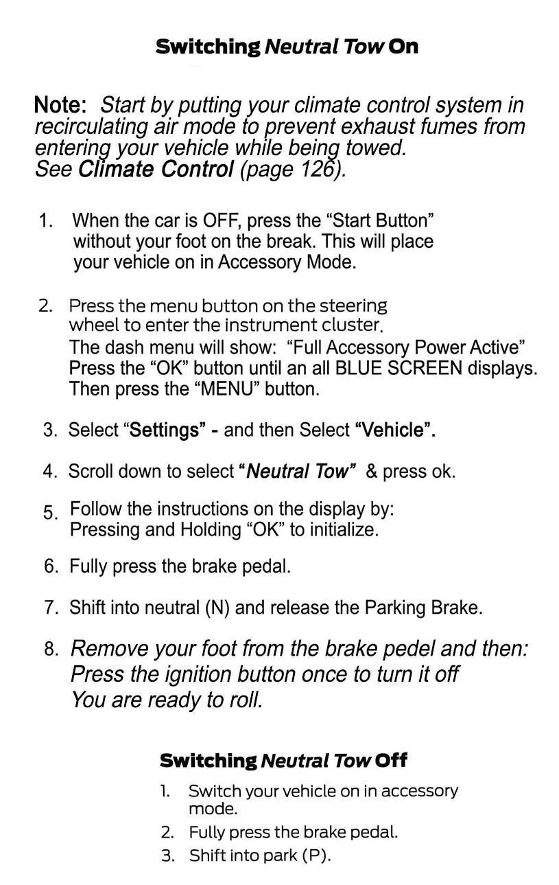

When I starred towing my Maverick, I had a hard time getting the instructions clear.
I made this instruction list. Try following it and see if it helps you.
Did all that. The neutral tow option was not there. After I stated the truck, ran thru menu the the neutral tow was back. I have put this truck in neutral tow many times. This is the first time this has happened. At least the glitch corrected itself after running thru the start menu.
