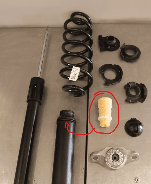

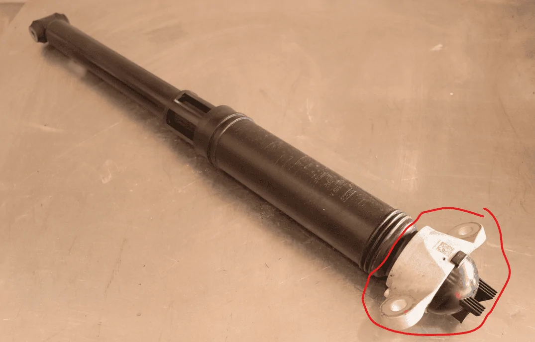

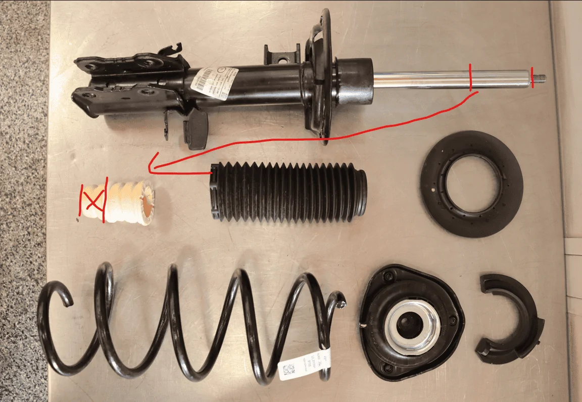

In front you will remove the dust boot and bump stop to trim while the front strut is apart, in the rear you remove the rear shocks and pull the top mount/dust boot off and replace it with the suppllied bump stop.

Rear shock:
Ford Maverick Lowered My Maverick, Where Are The Bump Stops? rear shock
Remove the plastic cover and unbolt the top mount from the shock, the bumpstop will be inside of the plastic dust cover:

The front bumpstop will be on the shaft under the dust boot, remove the plastic ring and first two ribs:
Ford Maverick Lowered My Maverick, Where Are The Bump Stops? front exploded vi
