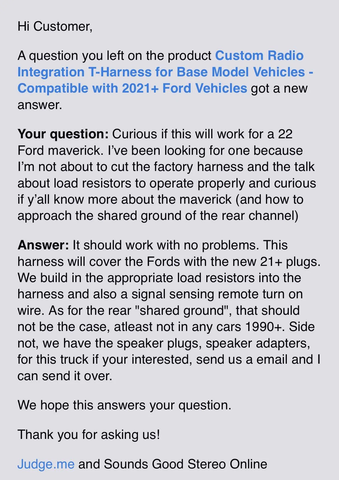

How did they handle the shared ground (gray/purple) for the rear speakers? Are they using the solid gray next to the green/purple wire? It would seem to me that it would be the negative for that speaker and I am beyond annoyed about the shared ground as it's causing some issues in my build.
Funny (not really, but) I’d been looking around for other loopback harnesses to see if any of them have addressed the shared ground, I messaged these other guys and this was their response (they are also extremely pricey)
