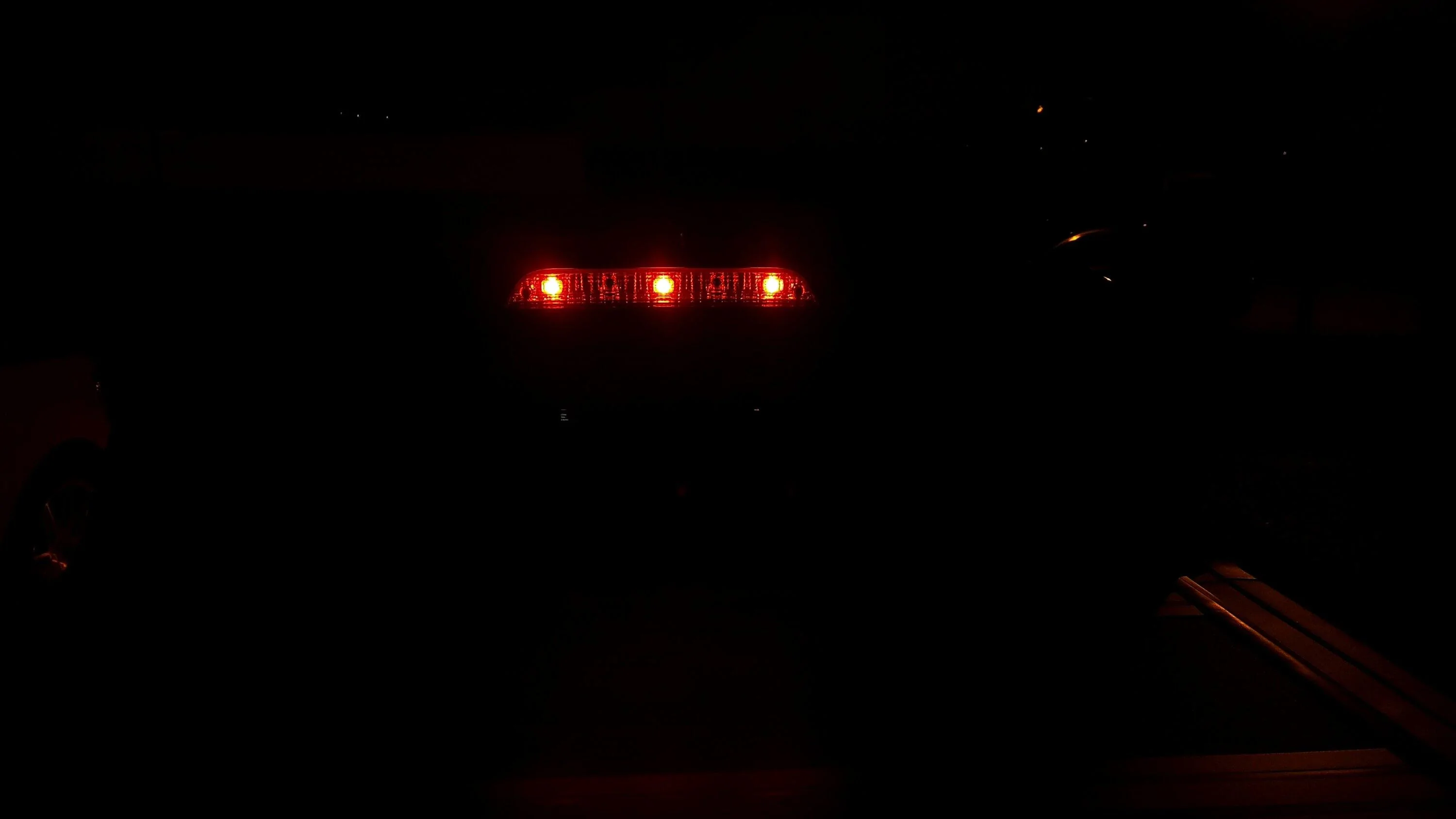

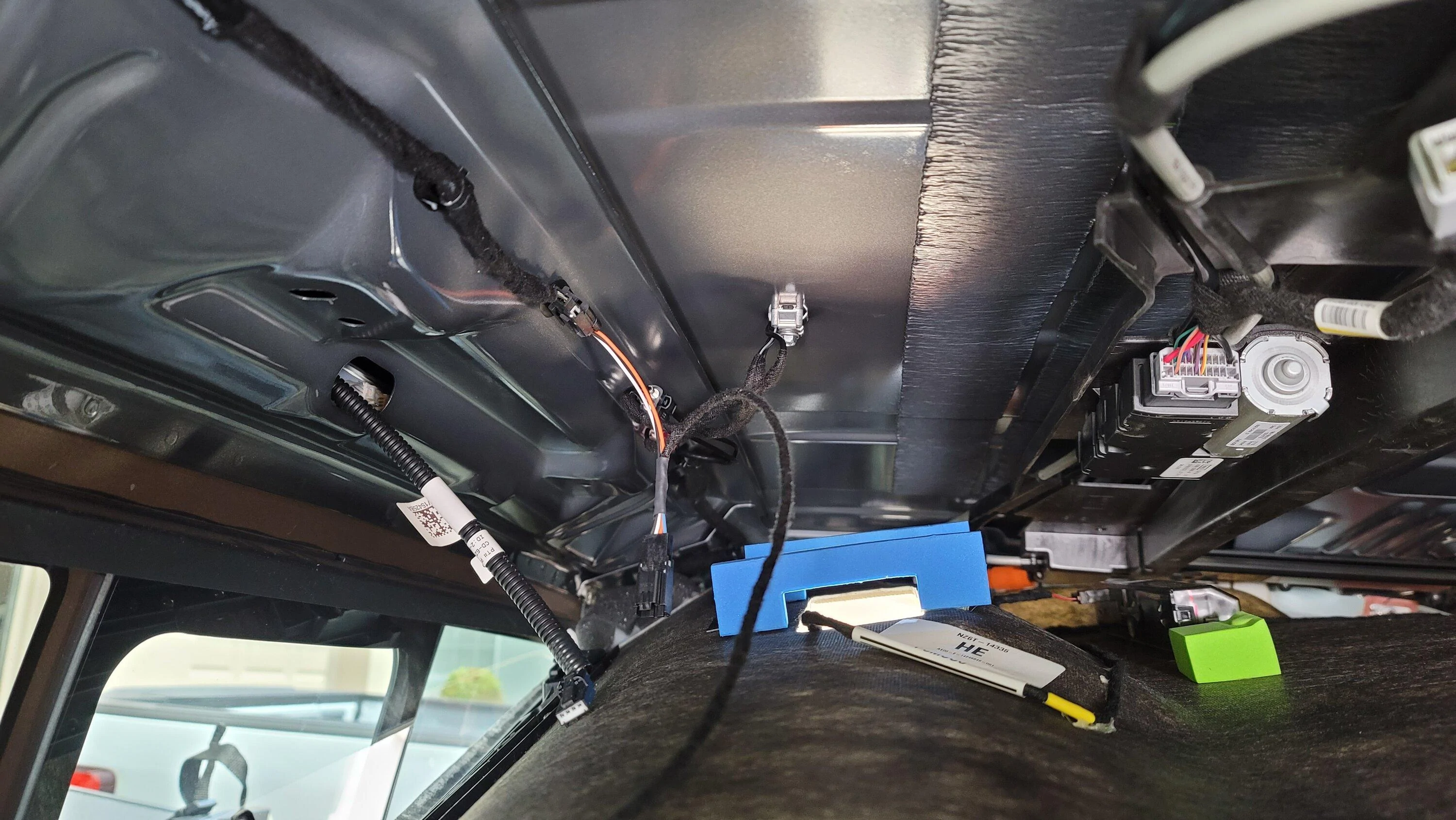

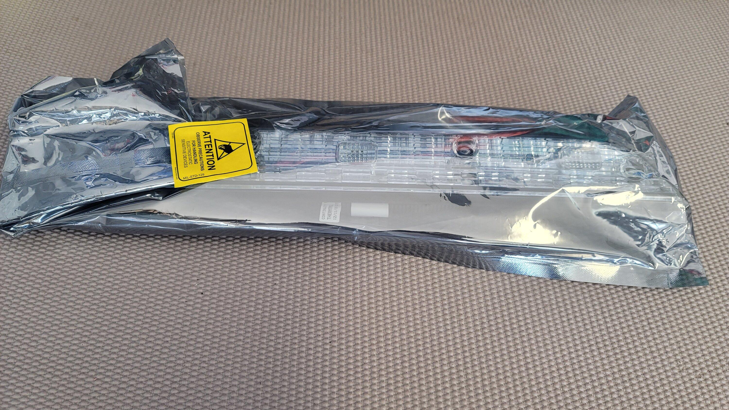

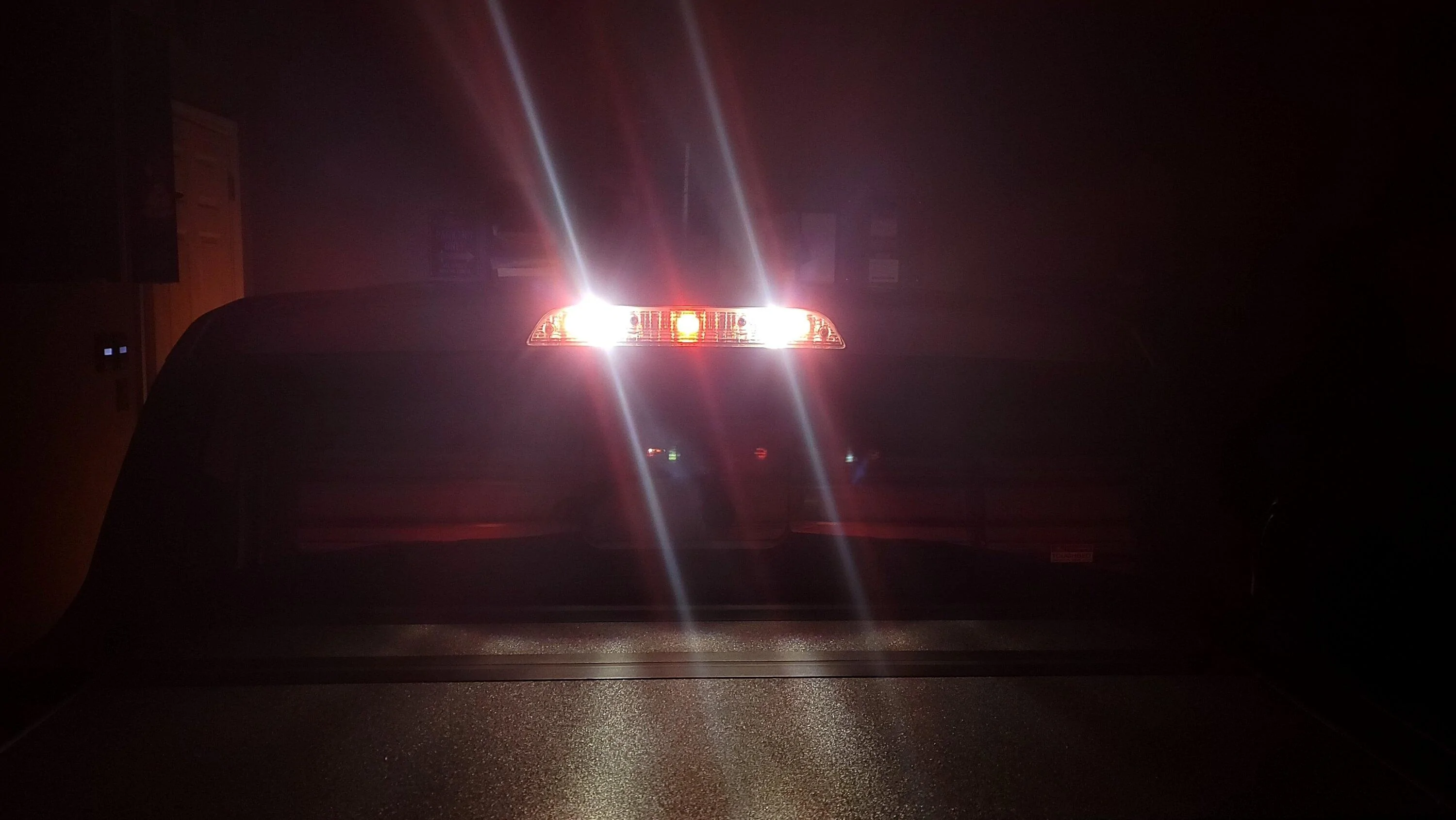

I also bought a third brake light replacement kit but couldn't get the cable to pull out enough to replace it, I didnt want to break anything and I definitely don't want to drop the headliner as I suspect I would never be able to get it back up the way it was before. Maybe I will tint it.
Have to drop the headliner a bit because of where Ford put the connector that you need to disconnect the 3rd brake light from. I recently installed an oem Raptor 3rd brake light in my Lariat....really no way around it.
Ford Maverick My First Edition Maverick with Mods, with Pictures and Links 20220821_135506
Ford Maverick My First Edition Maverick with Mods, with Pictures and Links 20220821_143819
Ford Maverick My First Edition Maverick with Mods, with Pictures and Links 20220821_150348
Ford Maverick My First Edition Maverick with Mods, with Pictures and Links 20220821_232337
Ford Maverick My First Edition Maverick with Mods, with Pictures and Links 20220822_034606
Seems to me to be an awful lot of work to replace a light that is perfectly fine from the factory. Of course I'm not in the head of the folks that make the change ;)
God, there really is no reaching it without pulling the headliner down. I know the two clips on either side of the third brake light but where are the others located to get it pulled down enough? I gently tried to pry around the edges and couldn't find the exact locations, I didn't want to pull too hard and mess the headliner up.
Make sure you REALLY like your new 3rd brake light before doing this upgrade. Lol. Since nearly everything I/we do is for research of new wiring solutions for the business, it was a no Brainer for me. To do this successfully and to prevent damage to the headliner, I removed both B and both C pillars. Doing this allows you to drop the headliner like in my pic without worry of creasing it. While I had the C pillars down I replaced the factory 4" speakers with high end Focals. Will replace the front doors and all 3 on the dash as I get there. Dropping the headliner is a bit easier IF you don't have the rear slider because you won't have that upper window track that you would need to get the headliner over.
Let me know if I can assist in any way
