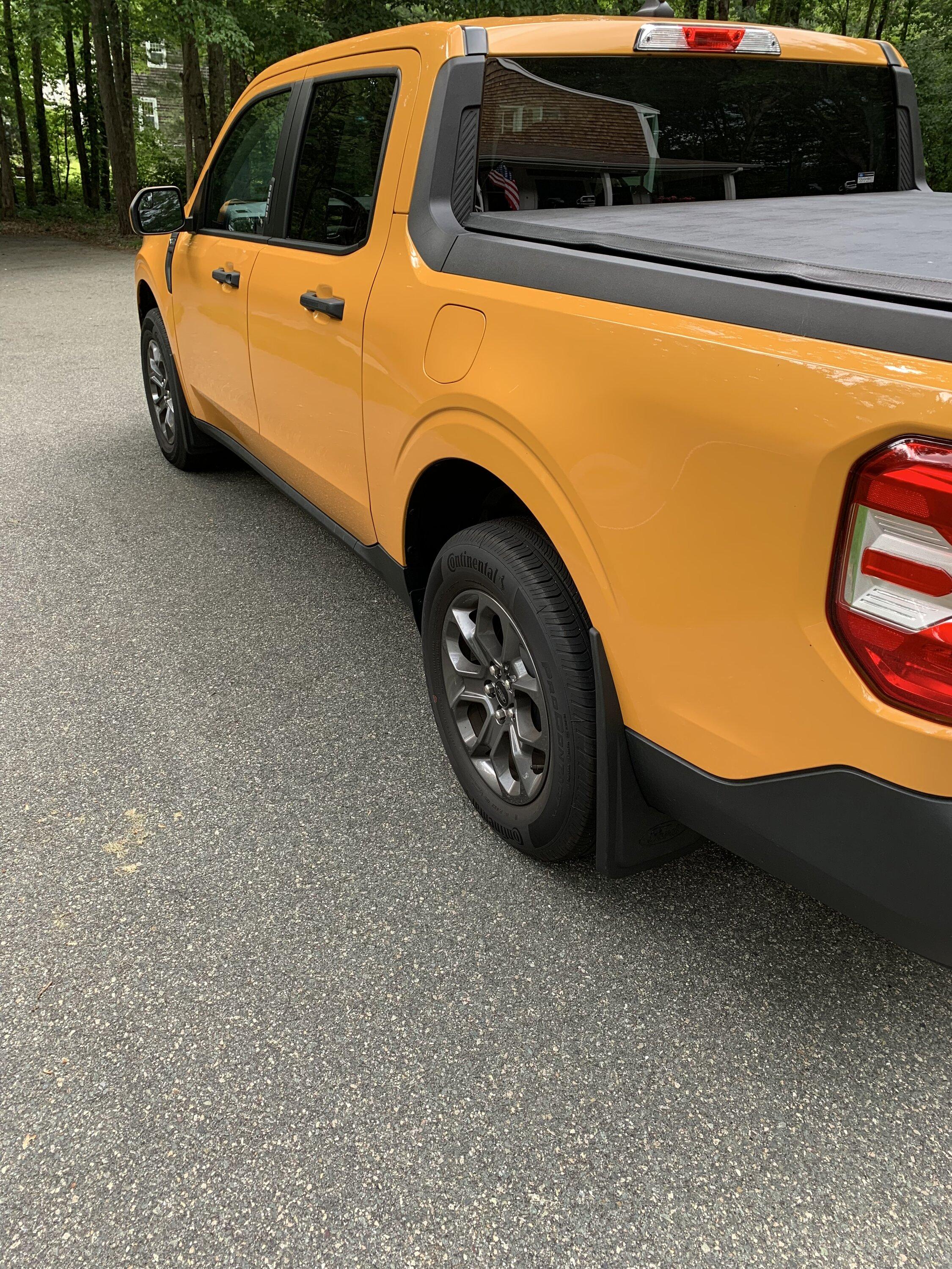

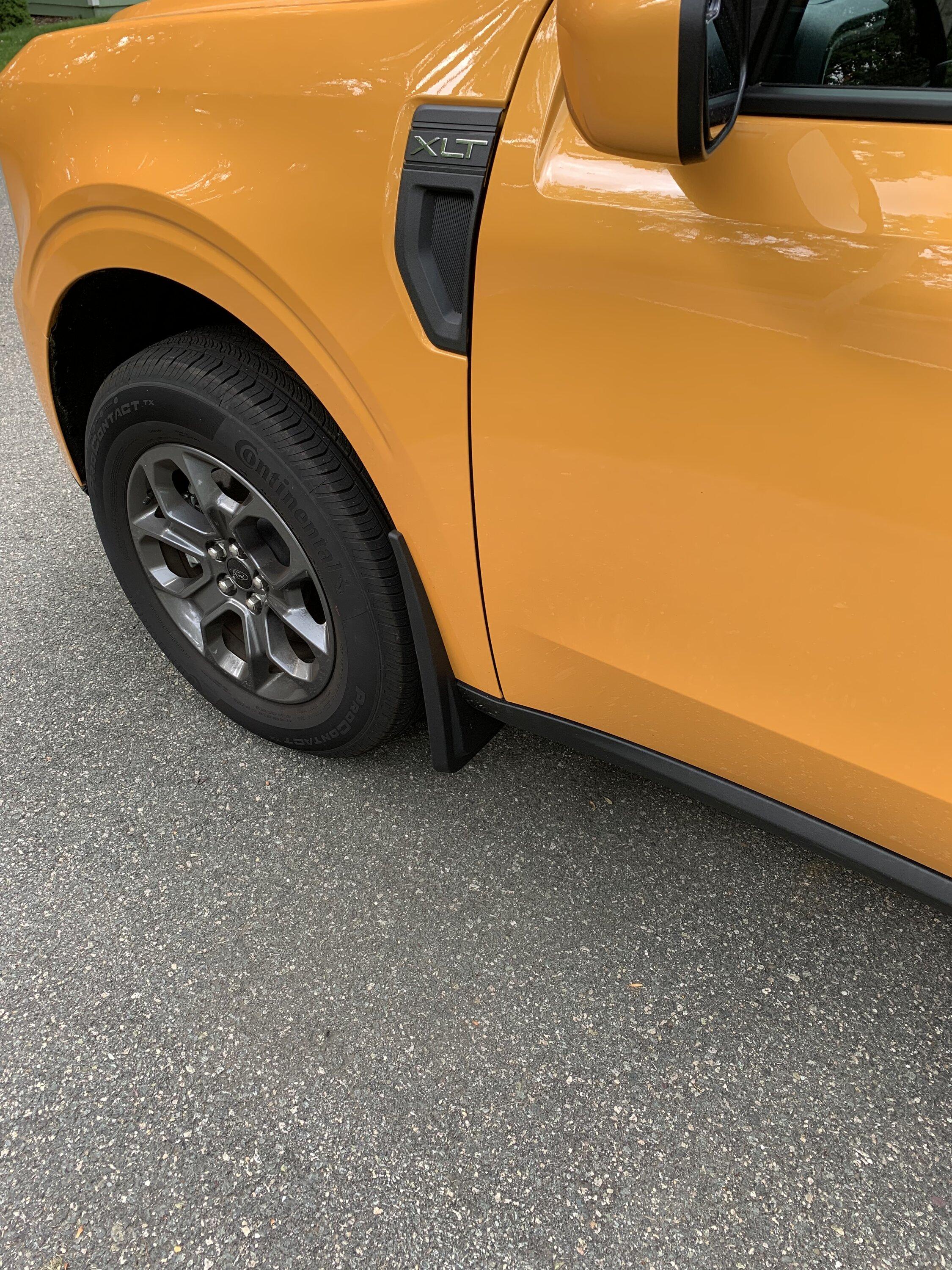

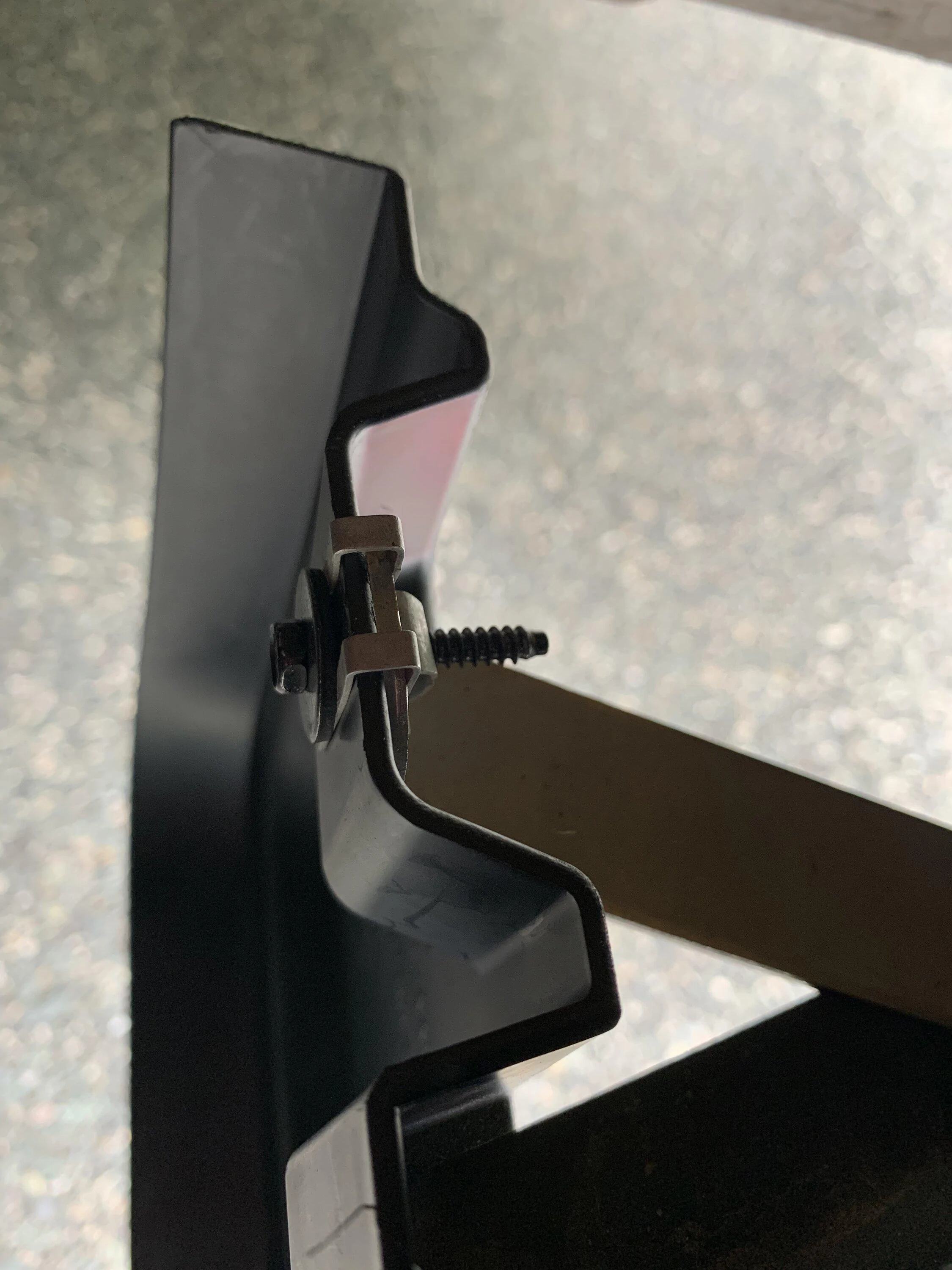

I just installed mine as well, I wish the metal retaining clips were designed differently, especially where they were sandwiching the metal tabs on the fenders — I wound up hitting some paint scrapes with the Ford paint repair pen I had bought a few months ago.

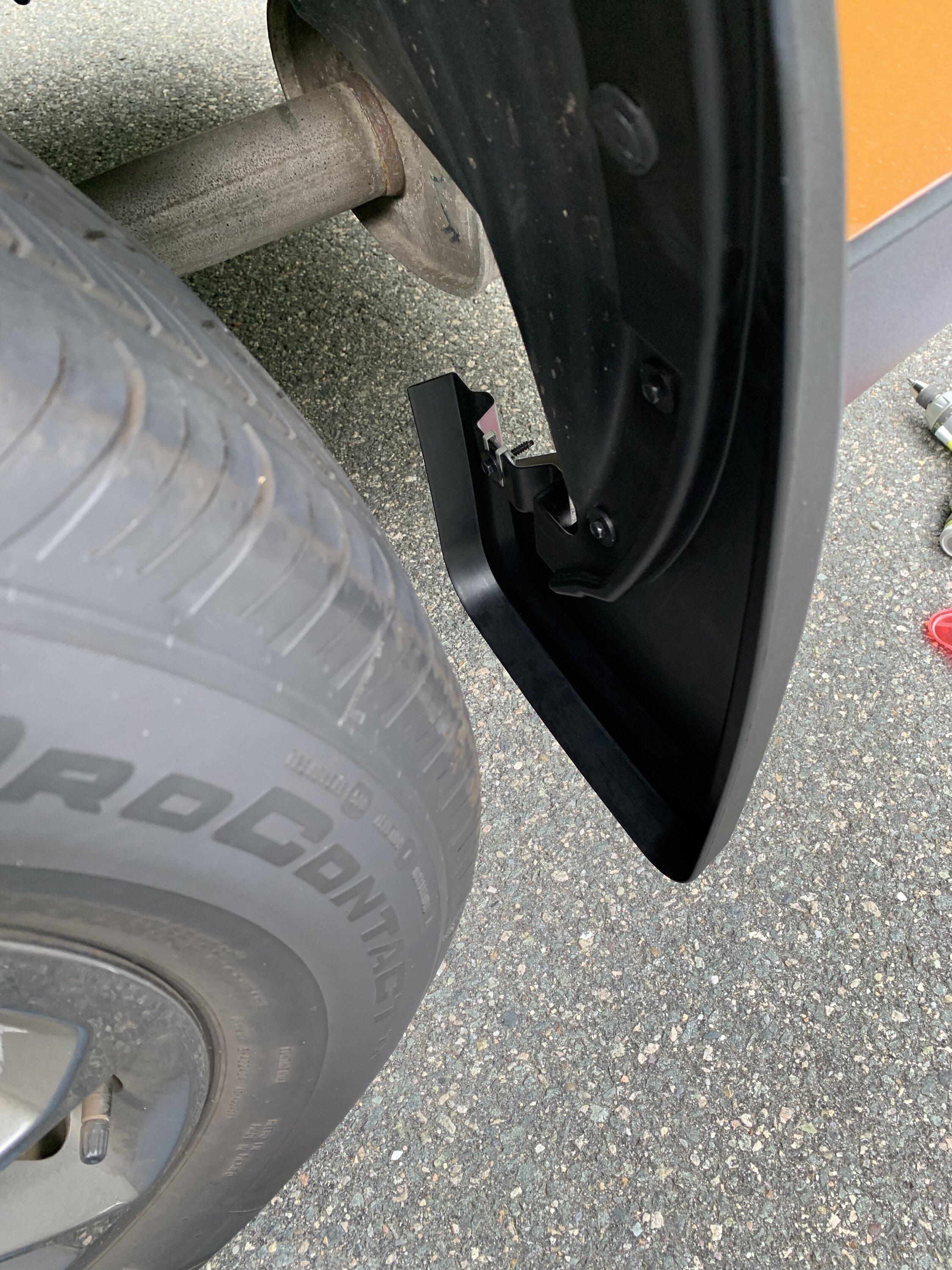

I also didn’t like how the rear flaps had you install them with a screw pointed at the tire so I flipped that part around.
overall looks good! Hoping they help in the winter.

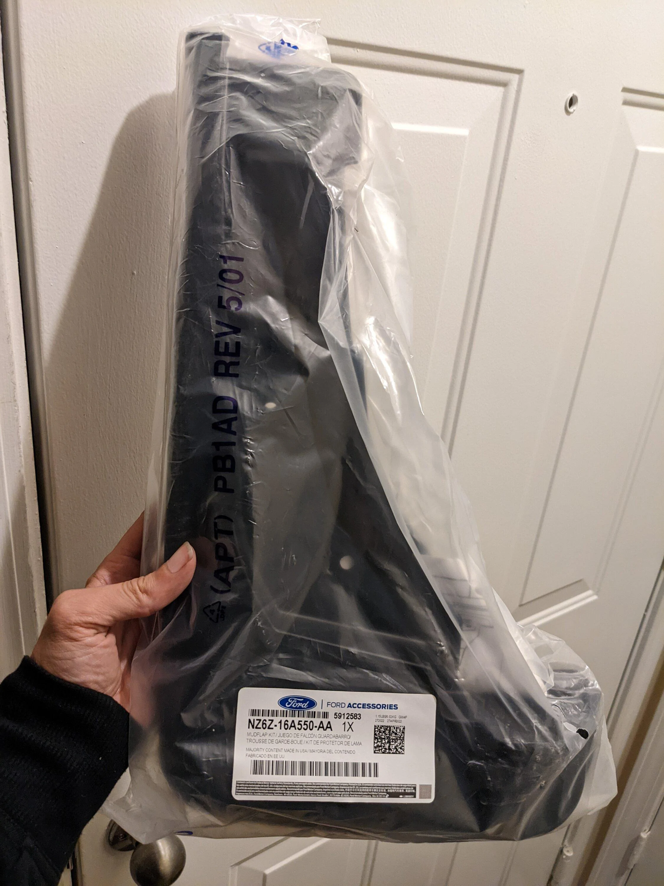

Sharp edges on molded plastic can easily be trimmed/sanded/filed to a blunt radius, which will also increase (thousandths of an inch, but hopefully enough) the clearance between the part and the paint. My OEM Ford accessory mudflaps are still in the packaging but I'll be sure to modify them prior to installation. Which is still TBD. Still waiting for a build date/window sticker, maybe today?
