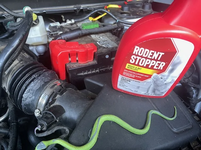

i just returned from the local Ford dealer who sold me my 2023 Maverick 4x4 2.0. The AC had quit, and I have a new rodent caused hole in the air intake accordion hose, as well as a partially chewed through hose on the return line to the coolant reservoir. EXPENSIVE PARTS! The two hoses would be $480, but I decided to repair them myself. Interestingly, the AC drive belt is$9.80 - yes, from Ford! :) The service manager suggested a spray mouse deterrent and the special mouse tape the Honda makes. (available on Amazon)
: The tape is designed in layers with mini-capsules of capsicum chili pepper extract inside the tape that bursts open when chewed on by rodents.

Well, to corrupt a saying, there's no kill like overkill! Picture will show the spray from Tractor S that I used, the glued on rubber snakes, the block of mouse bait/poison, and the fix of the accordion pleated part. It turns out that that part is all one piece, and goes over to where the air tubes etc. are. $460 if memory serves. The pleats were glued together with 3M weatherstrip adhesive, and then overcoated with Super Black Silicone. Ugly, maybe, but hey, think $400 and "beauty is in the wallet of the beholder!"

I've been having the same problem with rodents nesting on top of my engine. What worked for me is leaving the hood up overnight. It seems the rodents want a nice enclosed space that seems safe to them. Kind of a pain in the butt, but it seems to have solved the problem.
