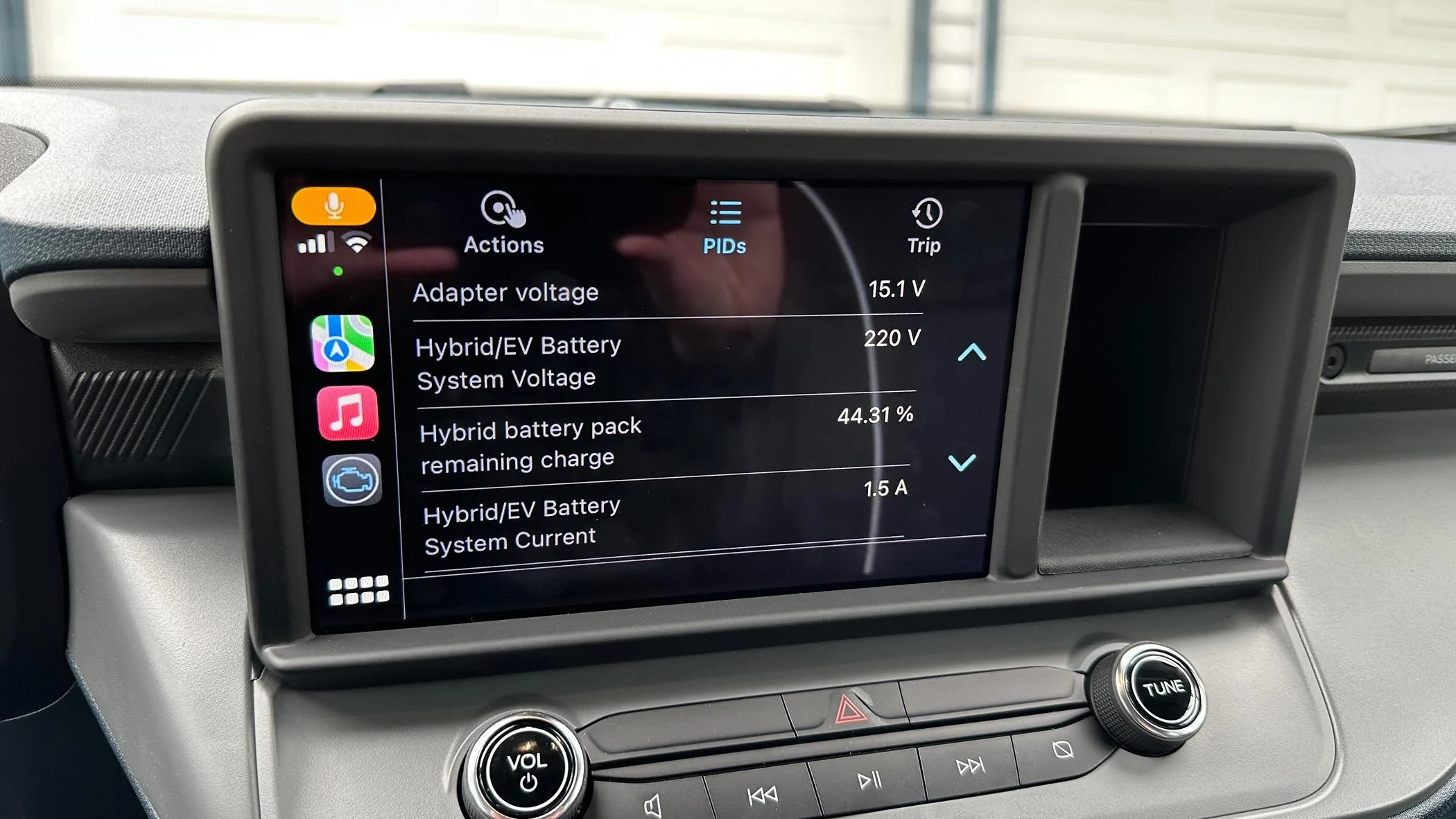

I have only had it working for less than an hour so I have not figured out which PIDs I want displayed over and above the Hybrid Battery charge level, but I like it - well worth the $12.99 CAD!
Ford Maverick Measure Boost Pressure or Electric Battery Voltage via OBD APP IMG_8051

LOOKS GREAT! and Thank you for confirming it can read hybrid battery charge!

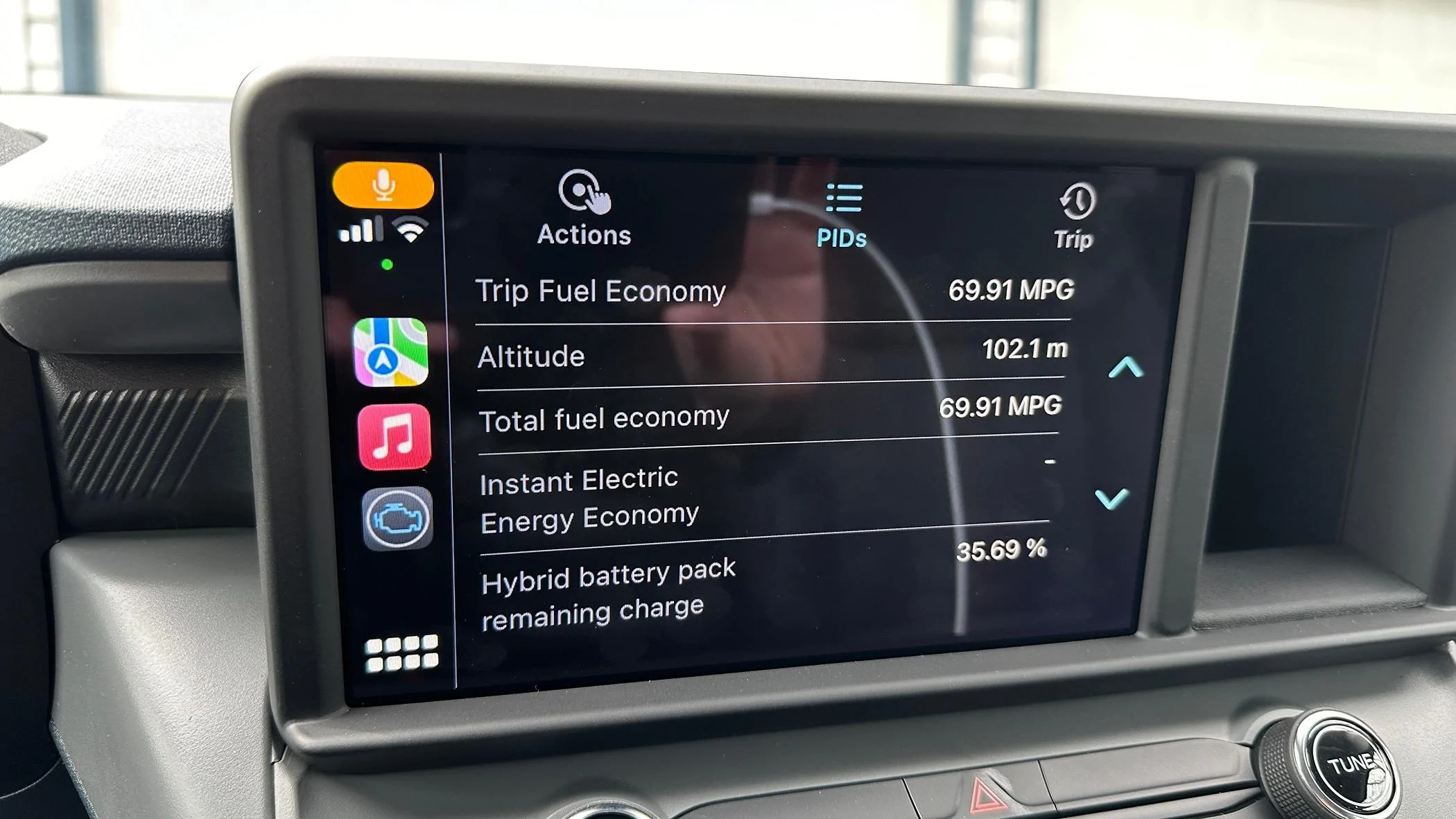

I am still playing but a few battery options.
Ford Maverick Measure Boost Pressure or Electric Battery Voltage via OBD APP IMG_8052
