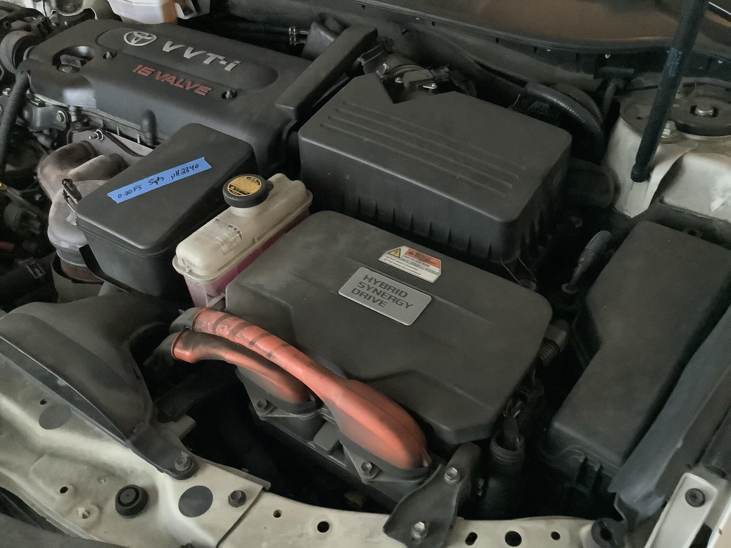

For the record, let's get a few things straight. HUUNVUBU, you're correct.. don't get too worked up by Dbarr's comment. He's driving an ancient Toyota which does not have an "All Electric" mode. Not sure what he thought posting two videos and a picture of an old Toyota ICE engine, was meant to prove about a Maverick Hybrid (other than his complete lack of understanding). Most Toyota people live in their own bubble. Just give them a wide berth on the sidewalk, and on the road.
When you see the "Electric" indication in blue color, on the dash, The ICE engine is off.. zero rpm.. zero tailpipe emissions. The truck is running electric only. For more proof, note that every time you shut down, the dash displays how many miles you traveled in Hybrid mode, and how many miles in Electric Only mode.
