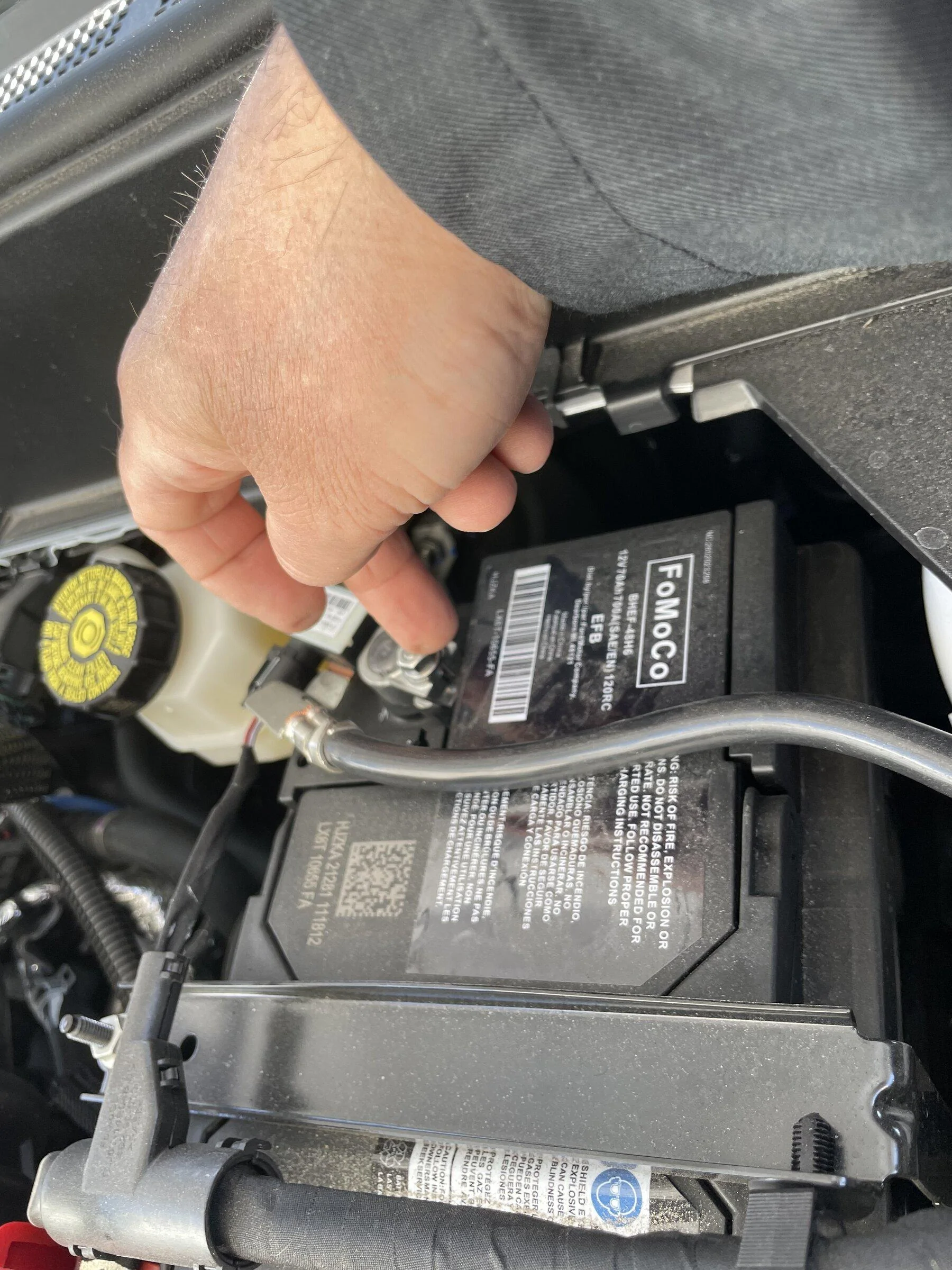

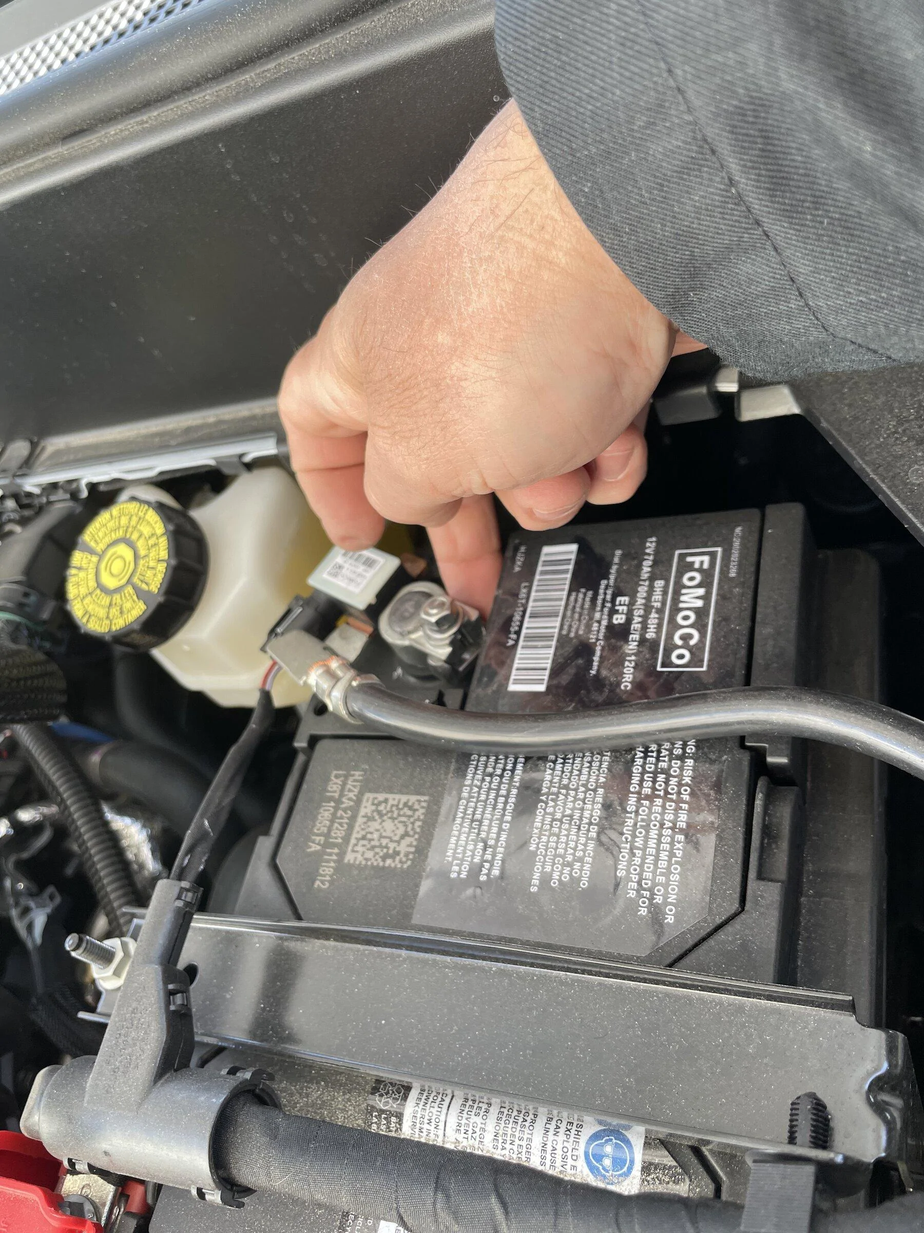

Mr Maverick
Mr Maverick
Feb 18, 2022
64
97
Montreal Canada
MAVERICK XLT ,TOYOTA CHR
I guess some one forgot to tighten the negative side of the battery.
I would like to thank everyone for there information.

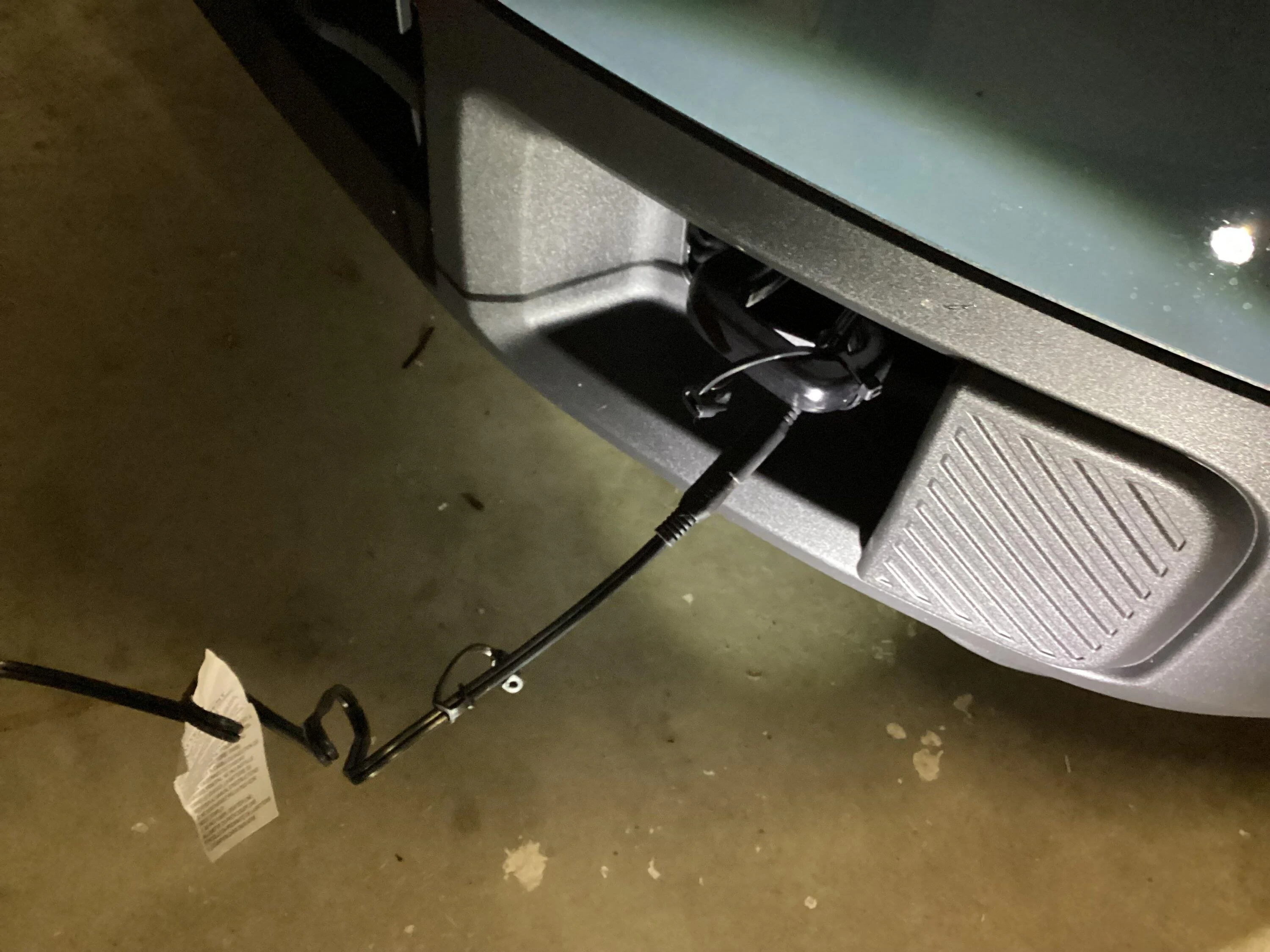

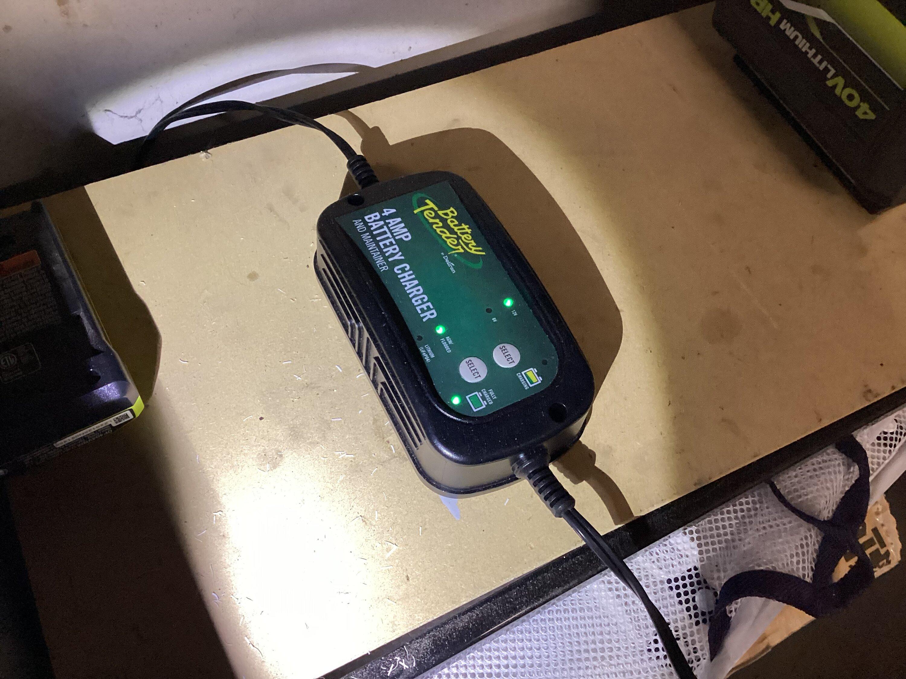

Ron43
Ron
Dec 27, 2022
87
130
Wisconsin
2022 ford Maverick AWD ,XLT , FX4, Luxury package
Seems like this is starting to be an issue, mine was dead once so far but now I bought a battery tender and just ran a longer cable by the tow hook so I just plug it in when not driving. Battery tender has a smart charger so it never over charges. It sat for 3 days undriven when it was dead, I know it is common on Hondas I’ve installed 2 Tenders on those already . These new cars have so many electronics in them I don’t even know how they all work and I’m a Master Technician. We don’t pull fuses anymore to look for battery drain we open all doors let car sleep 1-2 hrs then use an infared gun to see what is hot then start diag from there.
Ron43
Ron
Dec 27, 2022
87
130
Wisconsin
This was like $80 bucks , I know it sucks when you have a new car but until they figure it out that’s pretty much the fix. I’m sure there will be some type of reflash to fix it eventually.
