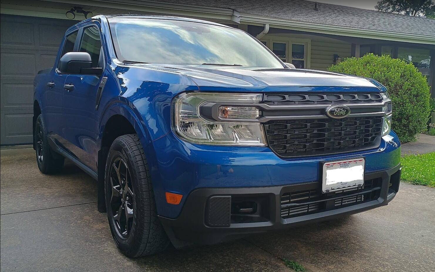

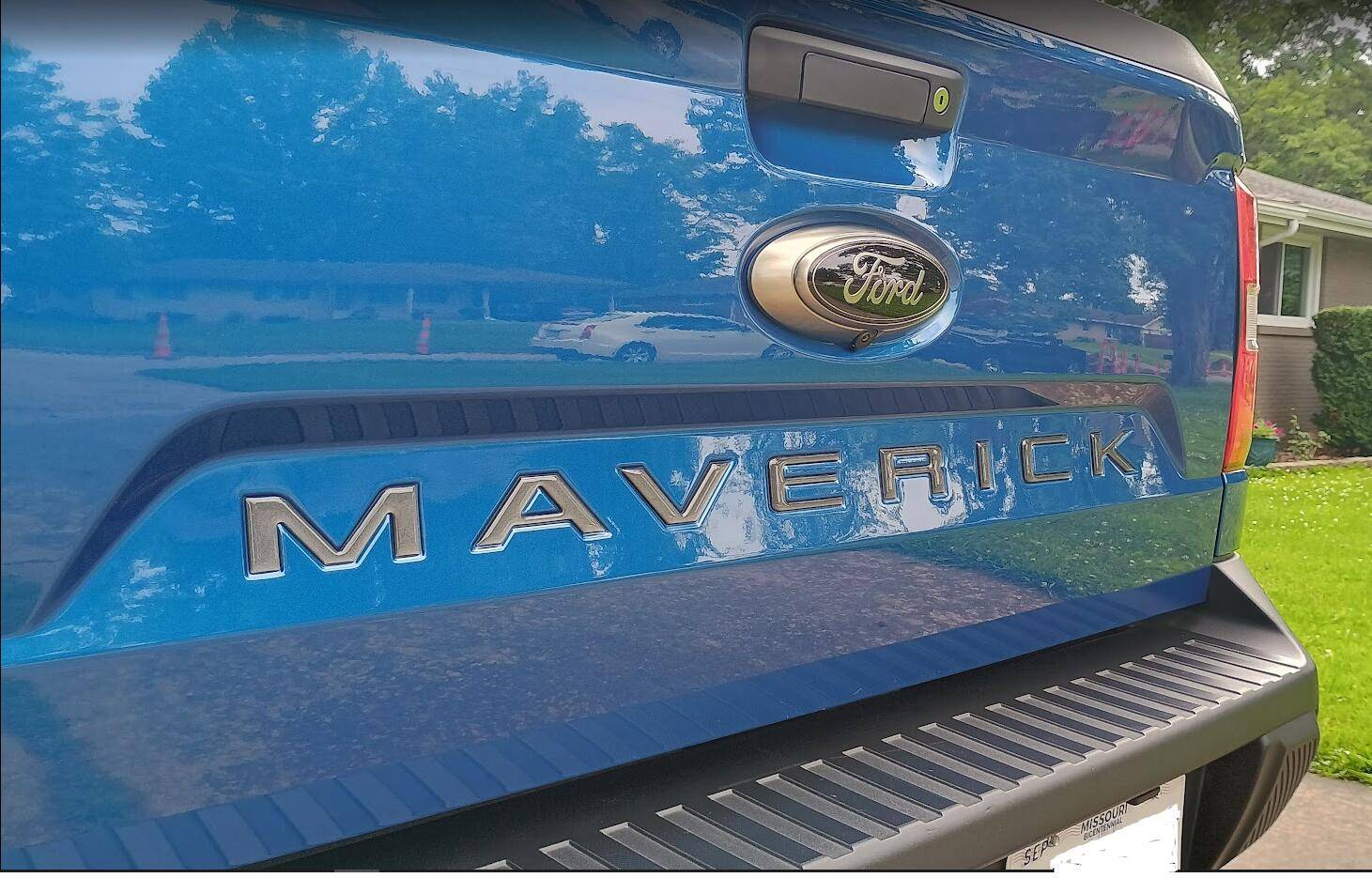

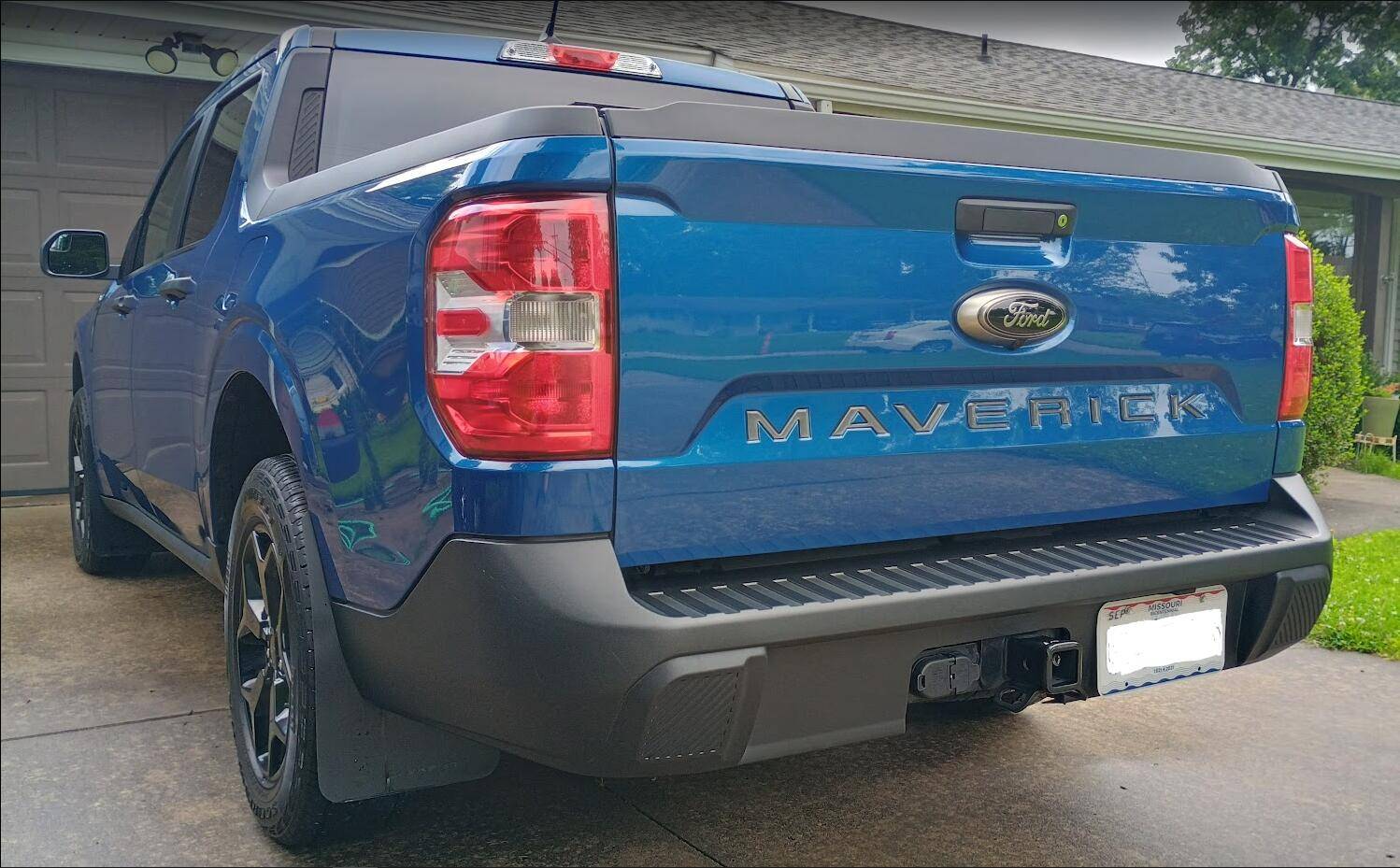

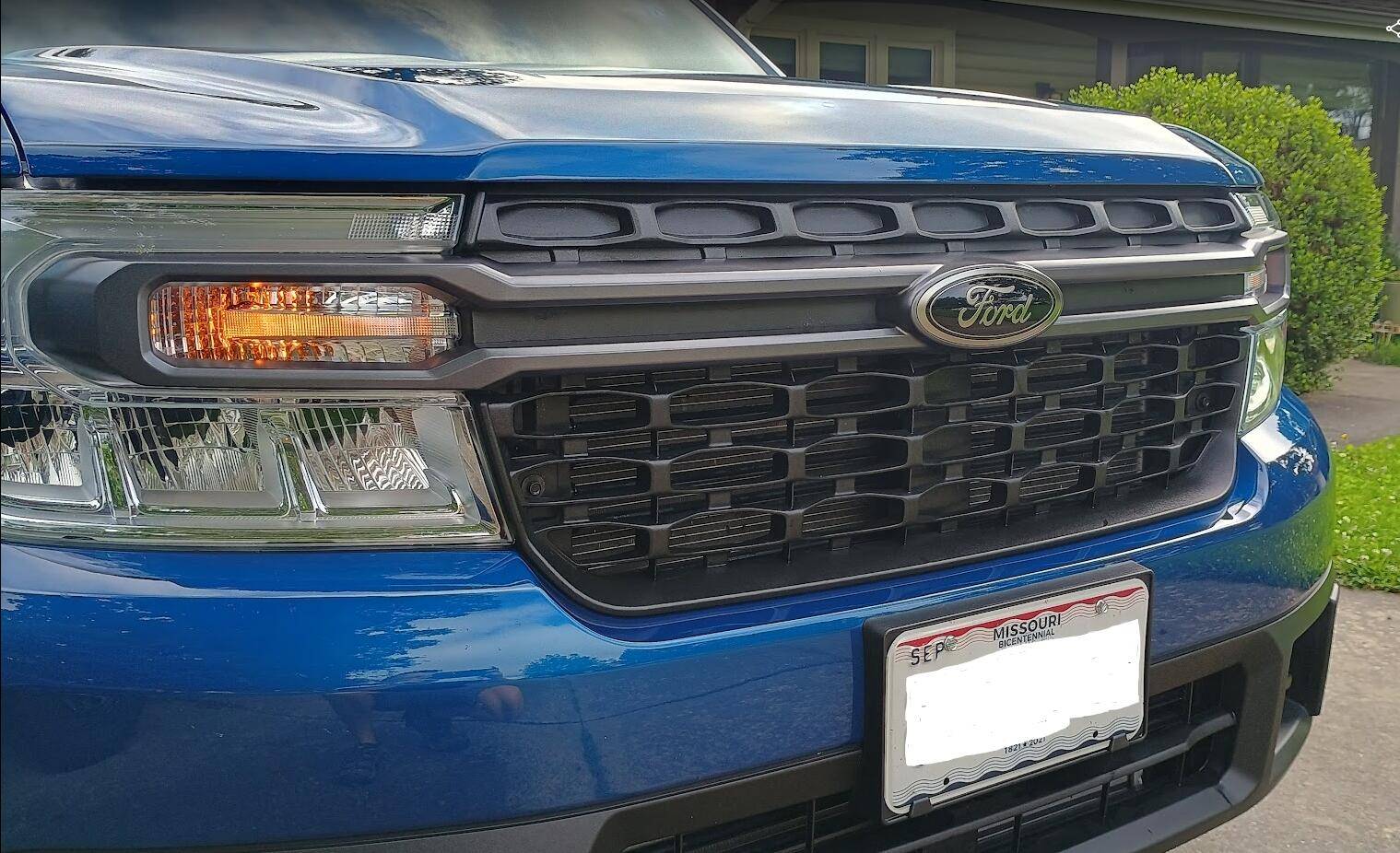

I would describe these as more of a "satin nickel" finish than "smoked chrome". They have the duller finish of stainless, with a slight bronze tint. They don't have a mirror finish at all like chrome. I think they fit in much better with the metallic gray of the XLT grill bar than the OEM chrome ovals.
It's difficult to take a picture that represents how they actually look. I think the comparison above where I'm holding the black oval next to the OEM one does that best.

Thanks for the photos....looks good! Agreed much better fit with that grill bar.

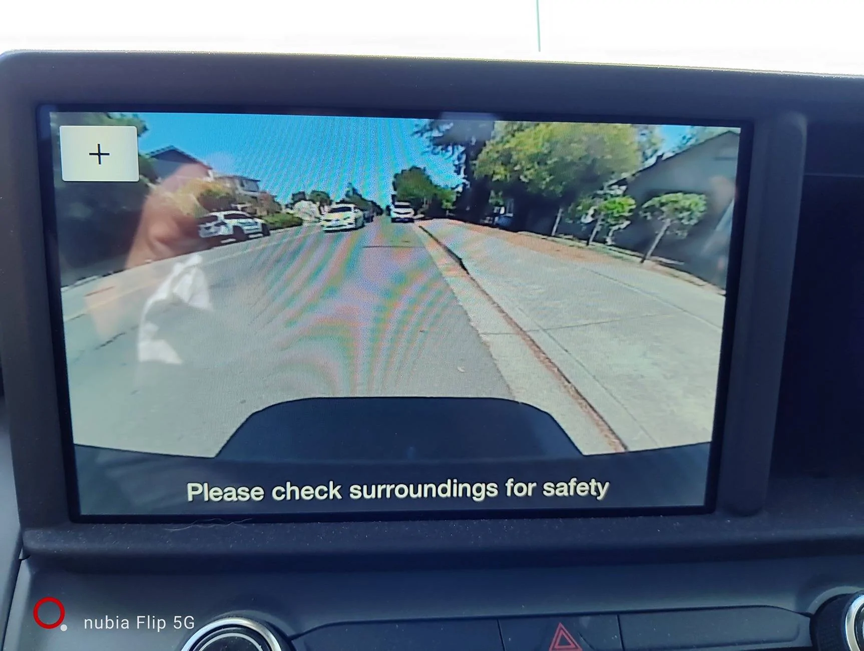

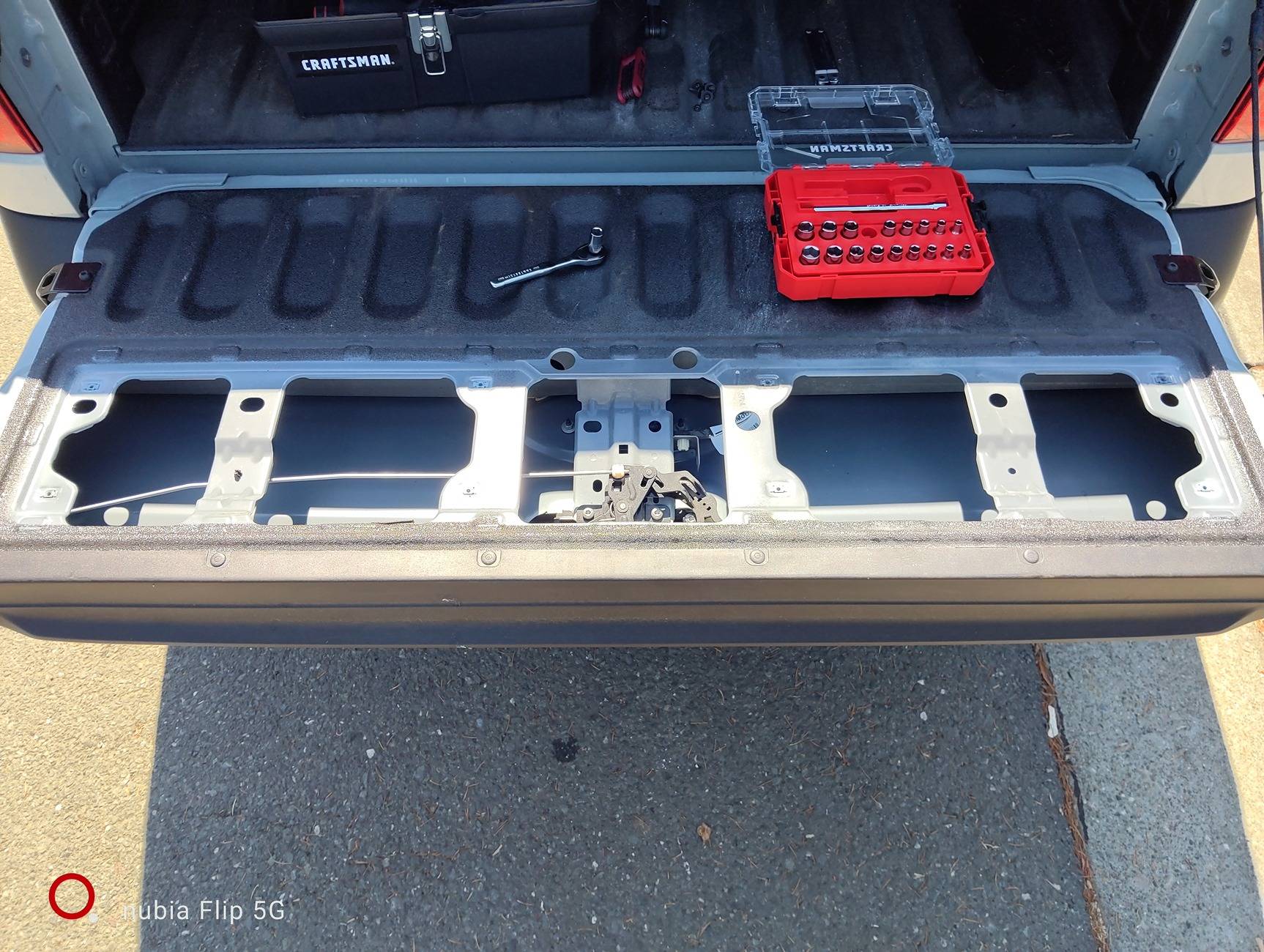

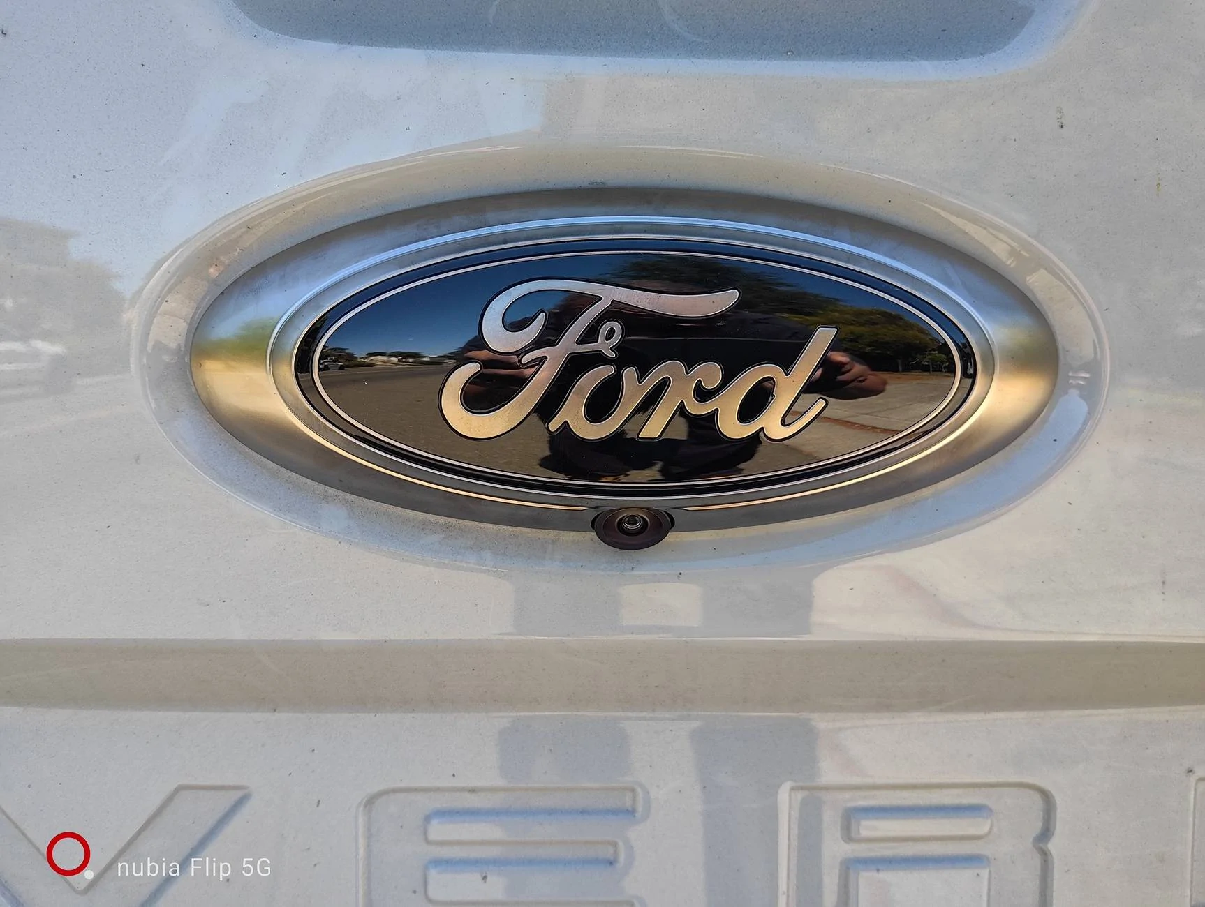

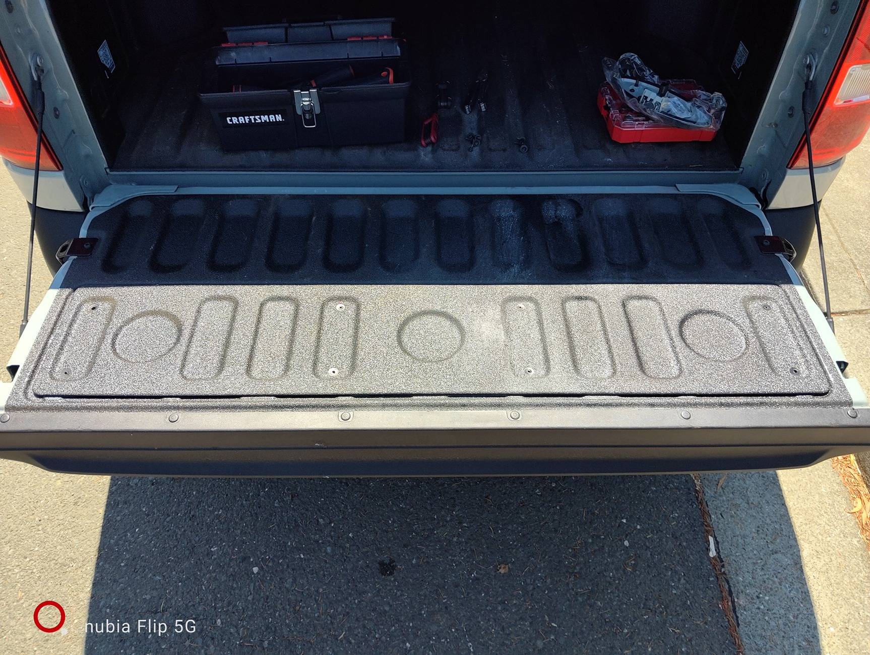

I completed the replacement of the rear black oval rear camera assembly. It works, but I no longer have the red/green/yellow guides and the black perforated one down the middle. Looking into how to fix, seems I need to reinit or reset the camera?
Anyway, need small slot head screwdriver, T20 torx, needle nose pliers, and 10mm socket.
Drop the tailgate. There is a cover bolted to the tailgate. Remove the 8x torx bolts and washers. Take the cover off.
Ford Maverick Maverick Black Oval Kit IMG_20250628_110510
Ford Maverick Maverick Black Oval Kit IMG_20250628_104651

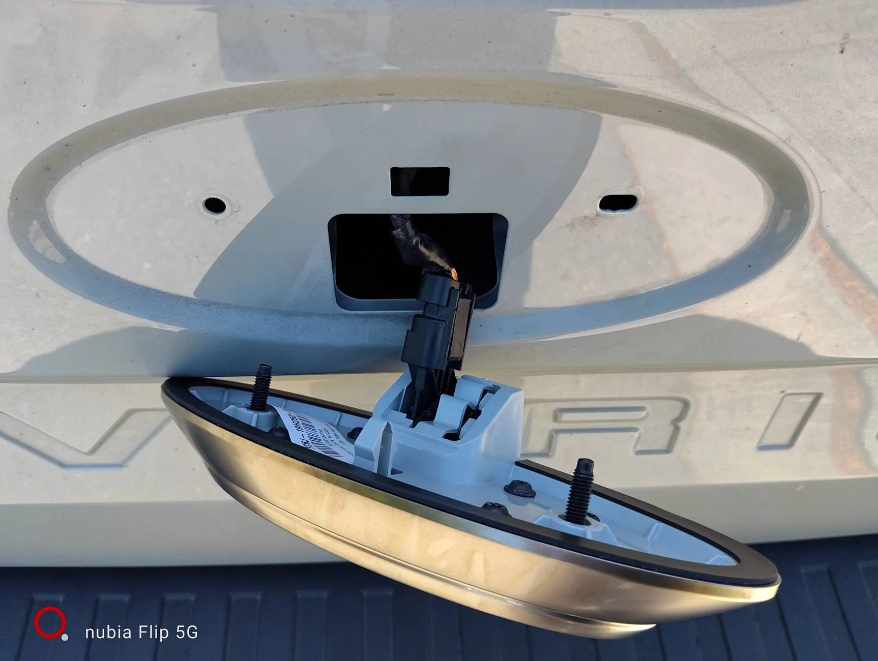

There are two nuts and a plastic clip holding the assembly to the outside of the tailgate. Remove the nuts. I used a small ratchet without extension to fit under the mounting bar for the tailgate lock that covers the camera assembly.
Use needle nose pliers to fit under the mounting bar then release the plastic clip. The camera assembly will drop away, held by the connecting cable.
Ford Maverick Maverick Black Oval Kit IMG_20250628_104621
Close the tailgate. Carefully disconnect the exposed cable from the camera assembly. Note there is a latch on the connector, use a small slot head screwdriver or equivalent to lift the latch. Look at the new assembly to see which part comes away from the connector stem and how the latch lifts.
Ford Maverick Maverick Black Oval Kit IMG_20250628_110105
Connect the cable to the new assembly. NOTE the way the pins line up. Push the new part into place on the tailgate surface, engaging the plastic clip.
Ford Maverick Maverick Black Oval Kit IMG_20250628_110404
Drop the tailgate.
Put the nuts back onto the assembly bolt stems. Don't tighten up too far, you will crack or warp the plastic housing.
Put the cover back into place. Will have to slide it around a bit to line up the holes with the tailgate screw points. Insert then snug up the T20 torx bolts.
Close the tailgate then test the camera. As I said at the top, I no longer have the colored lines and middle perforated one. I have had the camera software update recently, so I hope it is simply a matter of resetting the system. I saw one post that said the camera will reset on its own after driving for a stretch.
Ford Maverick Maverick Black Oval Kit IMG_20250628_111509
Next is the front emblem, a lot more work. I will report back on how I reset the backup camera.

Update on the camera reset. One post said to use a button combo on the steering wheel to reset the screen, in turn refreshing the camera. Another owner said he inadvertently reset the camera after disconnecting the battery. But I saw another post where the owner wanted to get rid of the lines and markers. I do kind of like the straight image, so,,,
Tbone289
Terry
Jul 18, 2024
2,437
4,502
MO
Everything you need is already in this discussion. Read posts #23-30 of this thread for the two ways to get the camera working properly. It is also addressed in the PDF document in the post before your second post in this thread, #37.
In short, you either have to swap the cameras, or use a scan tool to calibrate the new camera to the truck.

Alright I was able to initialize the rear backup camera. I used FORscan, Windows 11 laptop, and the vGate vLinker FS USB cable.
I installed the ftdiChip driver as suggested by the cable instruction guide.
Connect the cable to the OBD port and the laptop. Turn the car on, but don't start, turn clockwise to the second stop. Boot up the laptop. Green and blue LEDs lit on the cable. Launch FORscan.
There were a few initial messages, mainly iinformational.
One wanted to adjust the baud rate for optimal performance, I chose Yes. Another wanted to update the cable firmware, I selected OK.
If necessary, go to Settings (the gear icon) and select debug, not demo.
The app announced successful connection with the vehicle, then the car info screen listed all modules installed.
Next click on the wrench icon, Service Procedures. Highlight BdyCM Local Interconnect Network New Module Calibration.
Click on the play button at lower left to start the procedure. Note the description about what will be performed on the camera. Follow the prompts. There will be a directive to turn the car off, then to turn the car on. This reboots the camera to apply the settings.
Once completed there will be a message that the service procedure completed successfully.
Turn the car off, quit FORscan, unplug the cable.
Last, I drove the car 1.1 miles to enable the white guidelines that curve with steering turns. The black perforated line down the middle and the red/green/yellow guides were visible.
