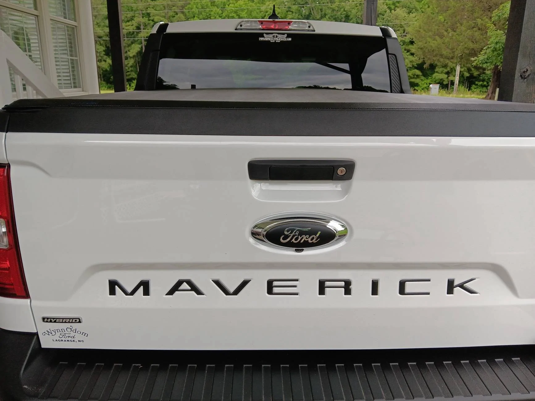

Close the tailgate then test the camera. As I said at the top, I no longer have the colored lines and middle perforated one. I have had the camera software update recently, so I hope it is simply a matter of resetting the system. I saw one post that said the camera will reset on its own after driving for a stretch.
Ford Maverick Maverick Black Oval Kit IMG_20250628_111509

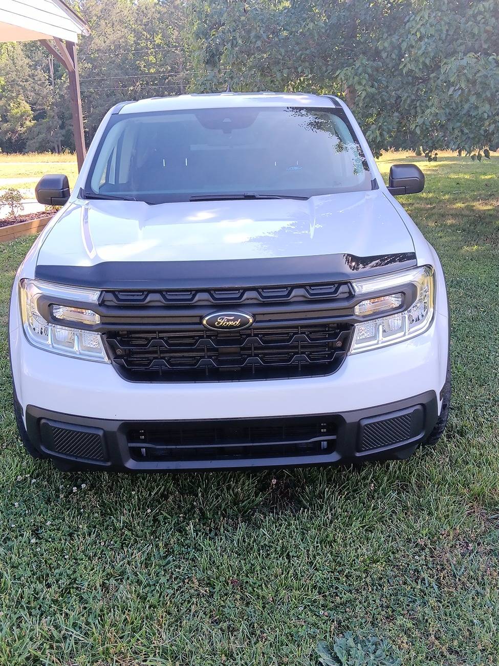

I was able to replace the front blue oval emblem with the black.
I have a 2024 XL Hybrid, so the front grille and the piece holding the oval emblem is a single assembly.
I used a combination of the Red Neck Garage method and the IS M-1447-MVBC.pdf document in post #37.
You need a heat gun (loosen the adhesive holding the emblem on), plastic trim removal tool (release the clips on the front grille assembly), 7mm and 10mm hex sockets, a ratchet extension.
Follow the Red Neck Garage procedure. Note that for me there were 11x 7mm bolts holding the shroud covering to the back of the grille. Once the shroud was removed with the grille pulled forward, I was able to get at the back of the emblem. There were no further screws holding the trim where the blue oval was mounted as described by David in the Red Neck Garage video. After removing the nuts from the holding posts, I used a heat gun to loosen the glue backing, then slipped a small sharp blade under the emblem and worked it around the piece to pry it loose.
During reassembly be careful not to tighten anything up too far, the components are plastic and may become warped or cracked. Note the 3x guideposts for the new oval. The two for the backing nuts are smooth. Hold the emblem in place while putting the nuts back on as you need some force to form the grooves.
Thanks for all the advice and guidance, much appreciated.

Last, I drove the car 1.1 miles to enable the white guidelines that curve with steering turns. The black perforated line down the middle and the red/green/yellow guides were visible.
