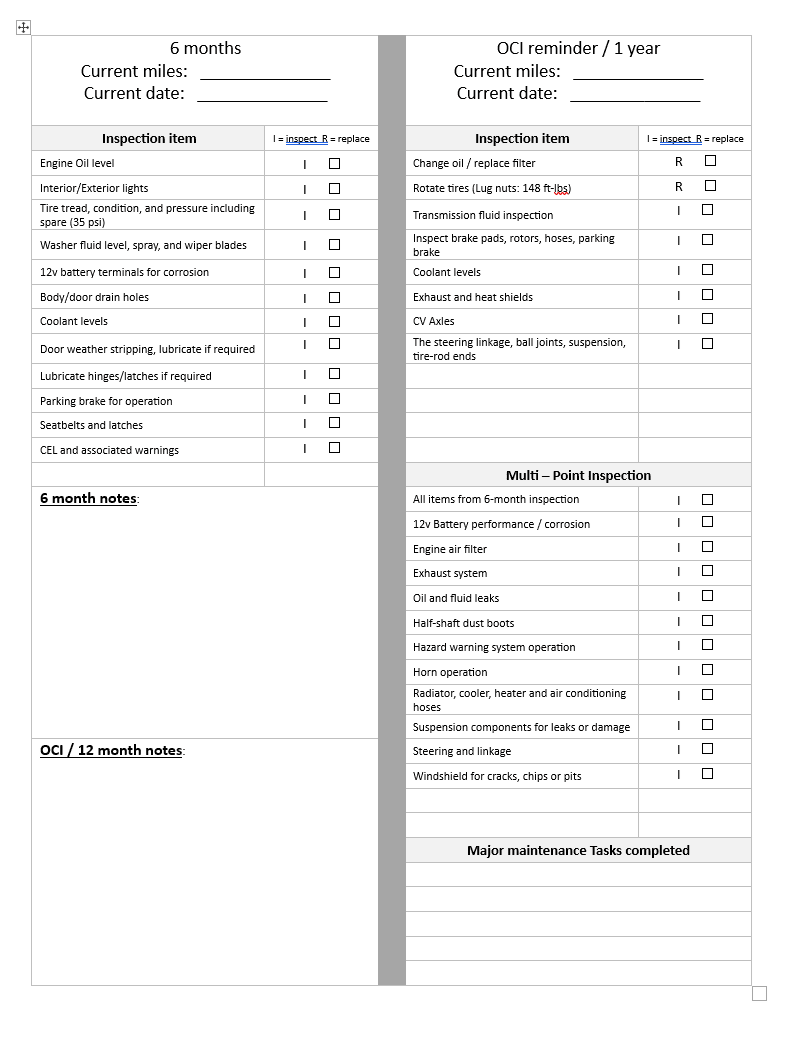

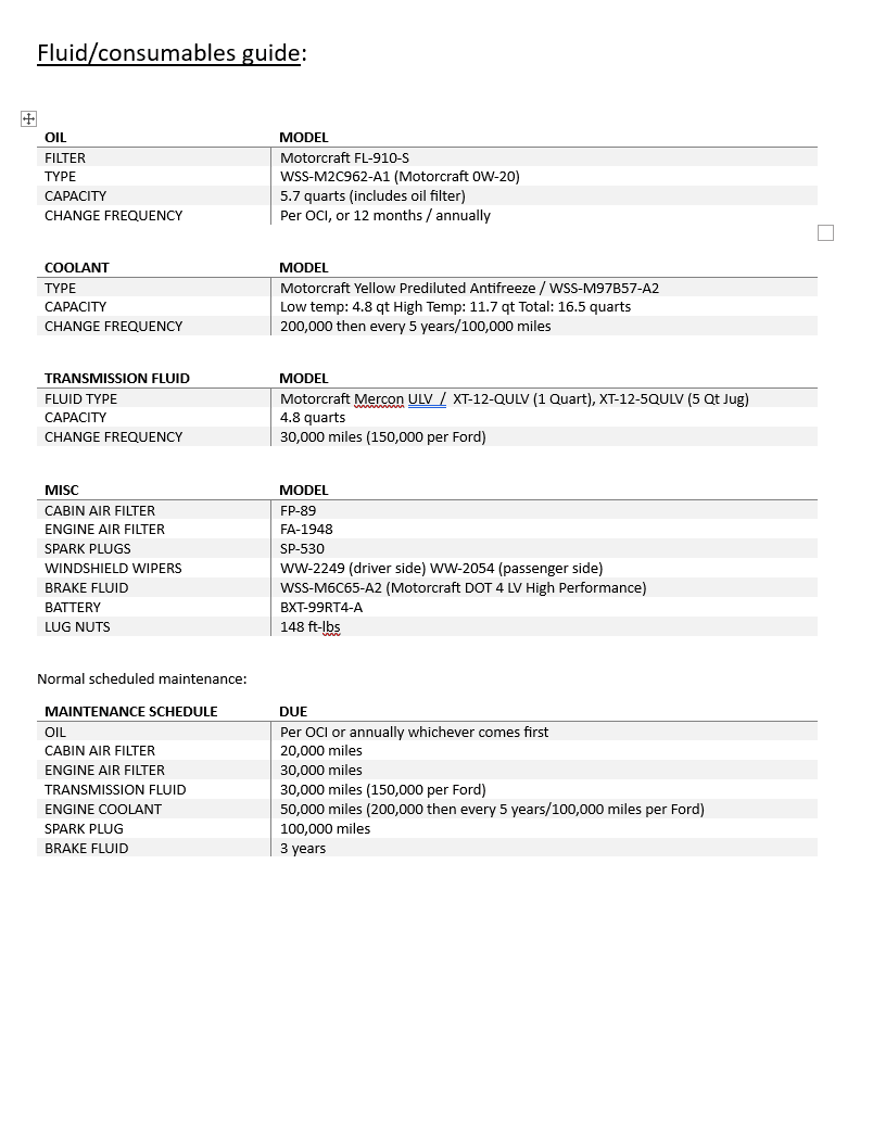

Here is what I've come up with so far. Designed to print both sides, and repeat the last two pages over and over.
Thoughts/questions/concerns?

Ford Maverick Maintenance Logbook for Mav hybrid pg1
_____________________________________________________________________
Ford Maverick Maintenance Logbook for Mav hybrid pg2
Ford Maverick Maintenance Logbook for Mav hybrid pg3
Ford Maverick Maintenance Logbook for Mav hybrid pg4
Ford Maverick Maintenance Logbook for Mav hybrid pg5
Ford Maverick Maintenance Logbook for Mav hybrid pg6
