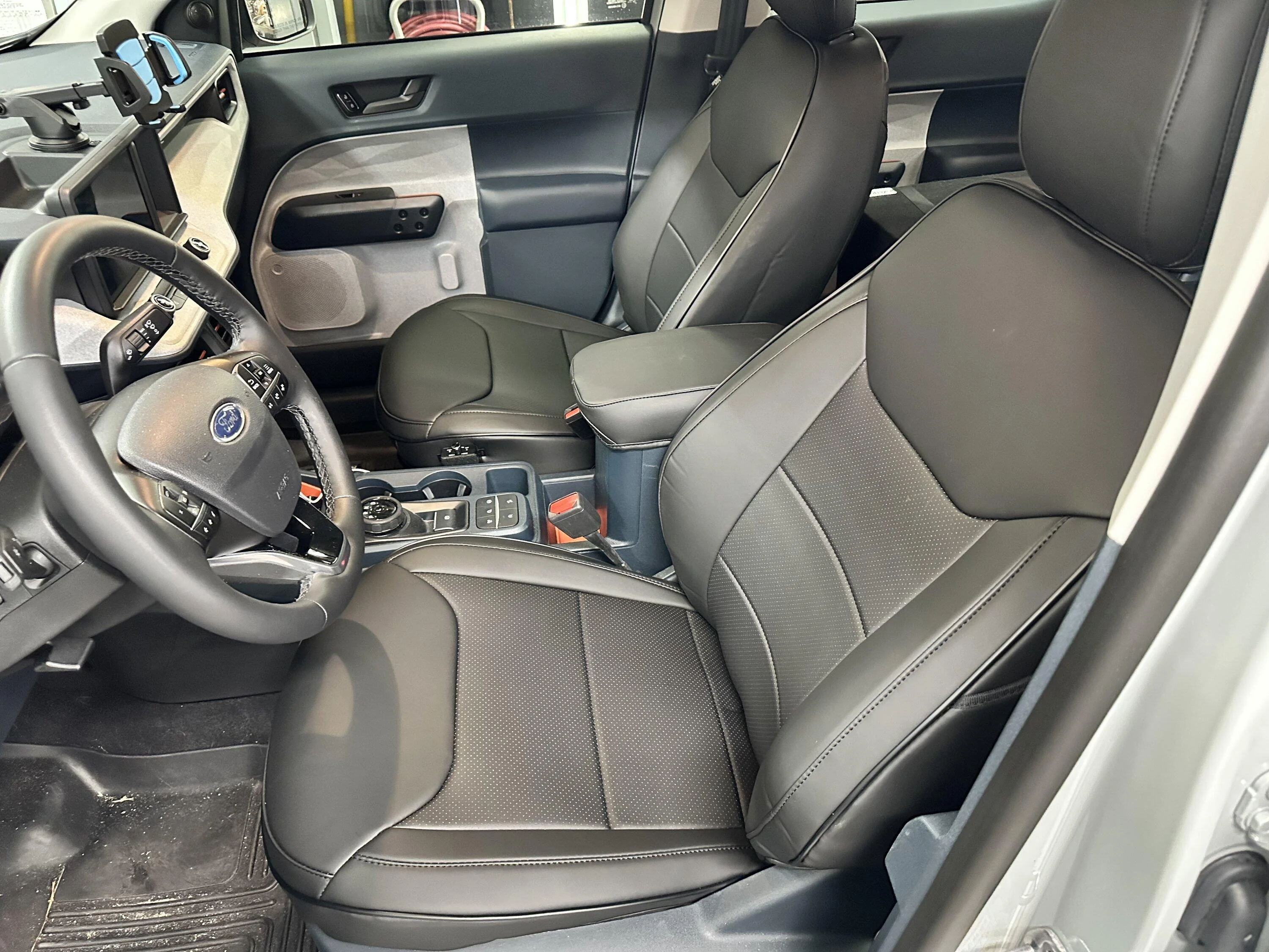

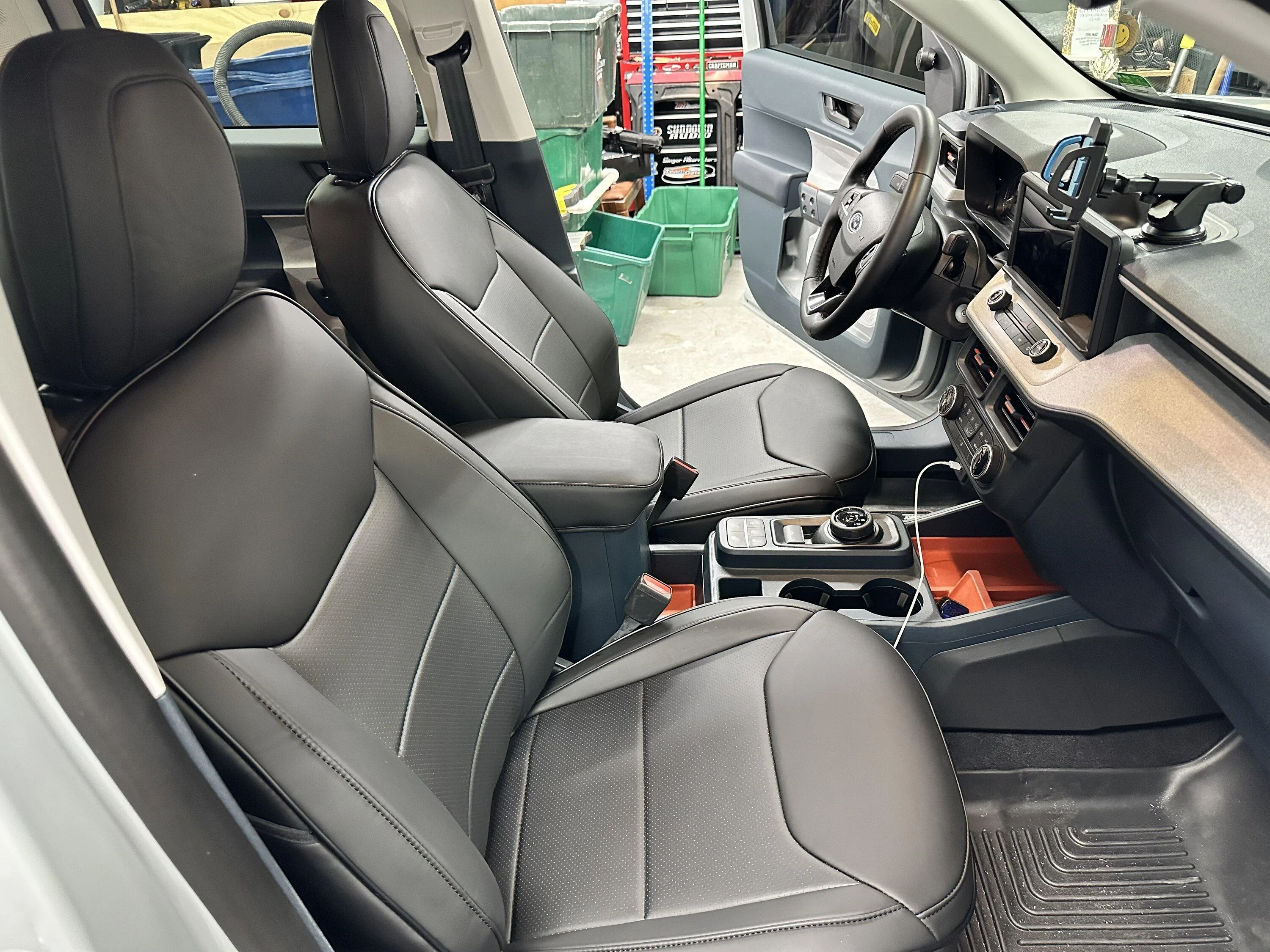

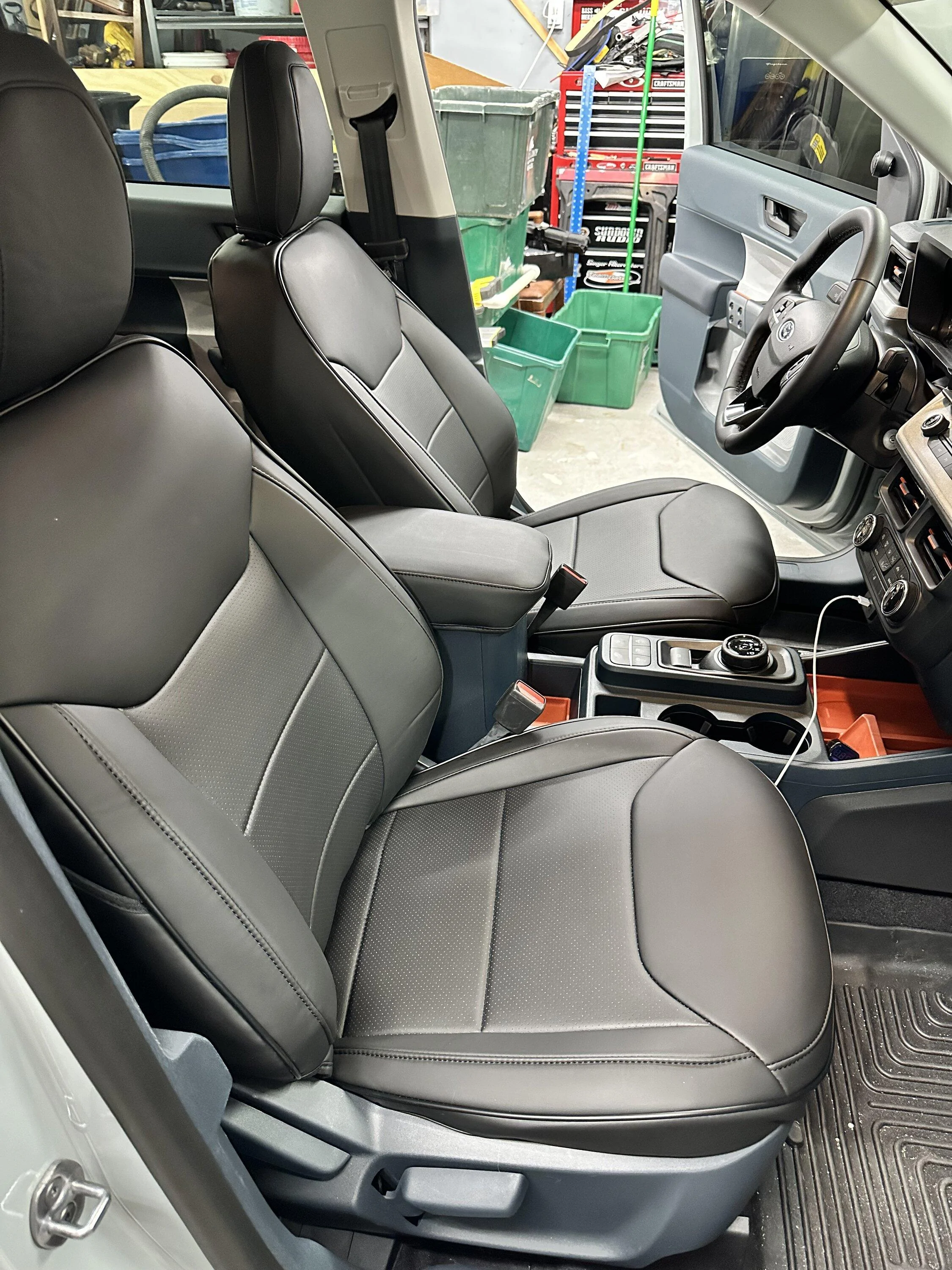

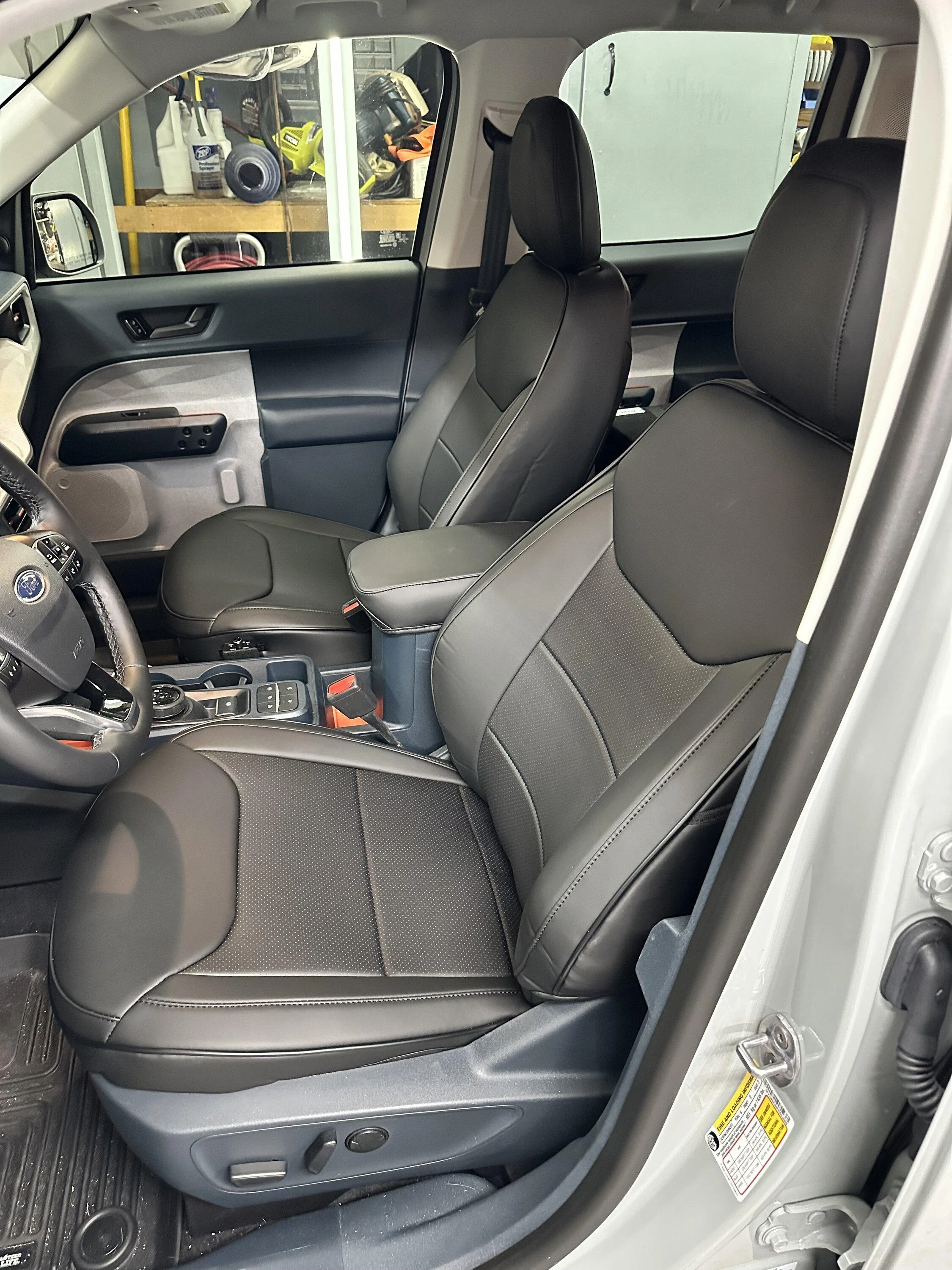

Ok got both the front seats installed, a tip at least from my perspective that helped is the outter elastic bands on the bottoms, do not put the metal hooks on till after you have them pulled through the seat, with them on it was very difficult to pull them through so taking them off and putting them on afterwards to me was an easy solve to that small hurdle.
The upper back portion of the seat cover was very easy to install, again I have done these style of covers before so for me this was not my first time installing covers like this.
A tip for installing the headrest parts, you will have to smoosh the headrest to get the cover on, do not fret it will bounce back once the cover is on its just foam under the material.
Initial impressions are good, but having seat covers of this style before I will reserve final judgement for after a week or so when they have settled in and conformed to the seats more.
Here are some photos:

Thanks for your review and sharing your photos
Wondering if you can go into more detail here? Never had seat covers as they always look a bit sloppy even when first put on. These look great so far and fit looks spot on. Color looks good, not a jet dark black but like a matte black, matches the interior well.
So with any seat covers they need time to conform to the seats, this is usually about a week or so of use. Meaning any air gaps or etc will work themselves out over time.
