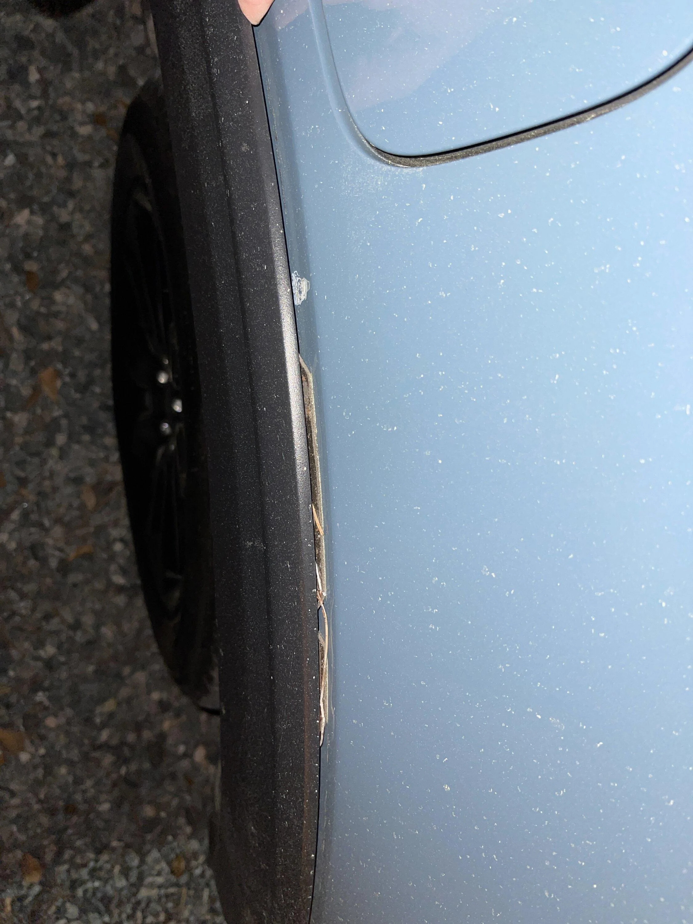

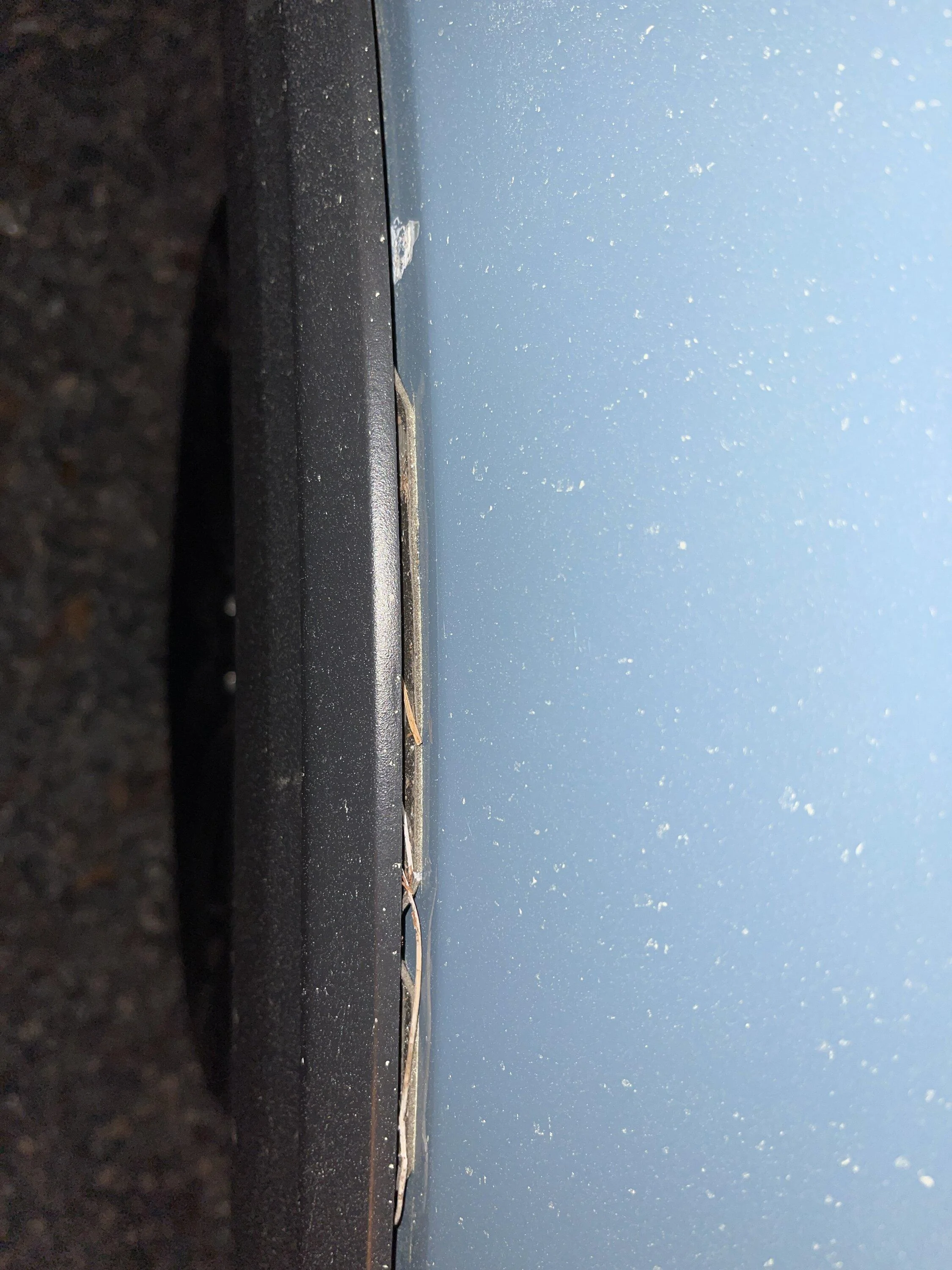

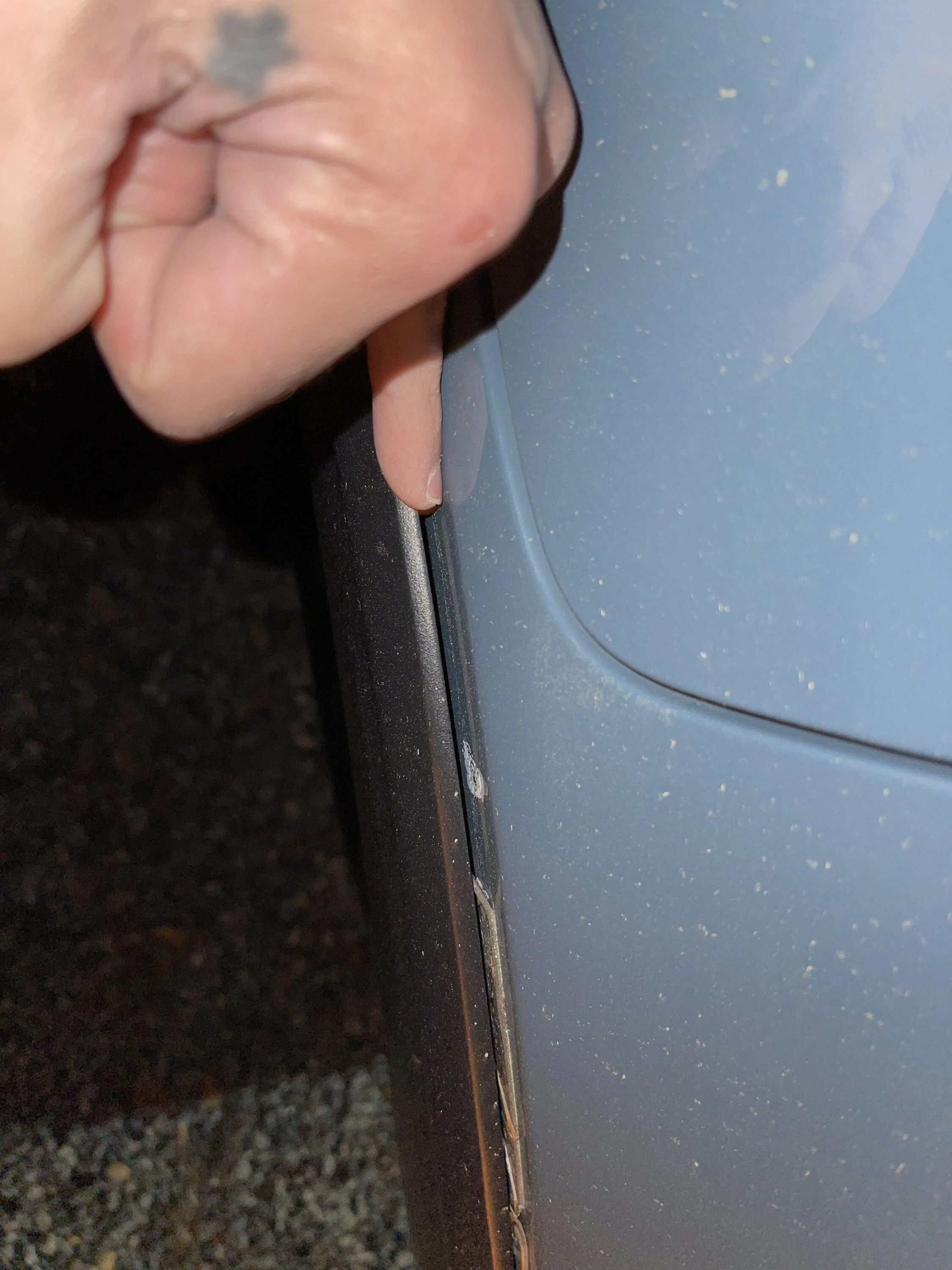

I forgot to take photos during the day. These will have to work. They are holding tight around the wheel well. It’s just the double stick tape that’s failing and I attribute that to the high pressure of the car wash. Even my diamondback cover leaks from the car wash. In the photos it’s the rear drivers side and I’m looking down from above. I can easily fit two quarters stack on top of each other in the crack. I didn’t use the glue they provided and perhaps that would have fixed the problem. But I’d rather they come off “easily” in case I needed to remove them for example to put on a brush guard than have them stuck for life. It’s easy enough to buy another roll of the tape and re apply them.

I used clear silicone to stick the flair to the paint in situations like the small gaps that you have and it worked perfectly. The sticky tape did not hold in some areas. Also, I used a heat gun to bend the tabs on the flair (not all the push pin locations were 90 degrees from the fender). The heat gun worked great for that. Another small tip: I lightly sanded the edge where I thought it might rub on the paint. They will not just fall off. I assure you that I have went over 90 mph and no issues. Good luck with your installation.
I did the same with clear silicone glue solved the problem.

I did the same with some clear silicone glue. Problem solved.

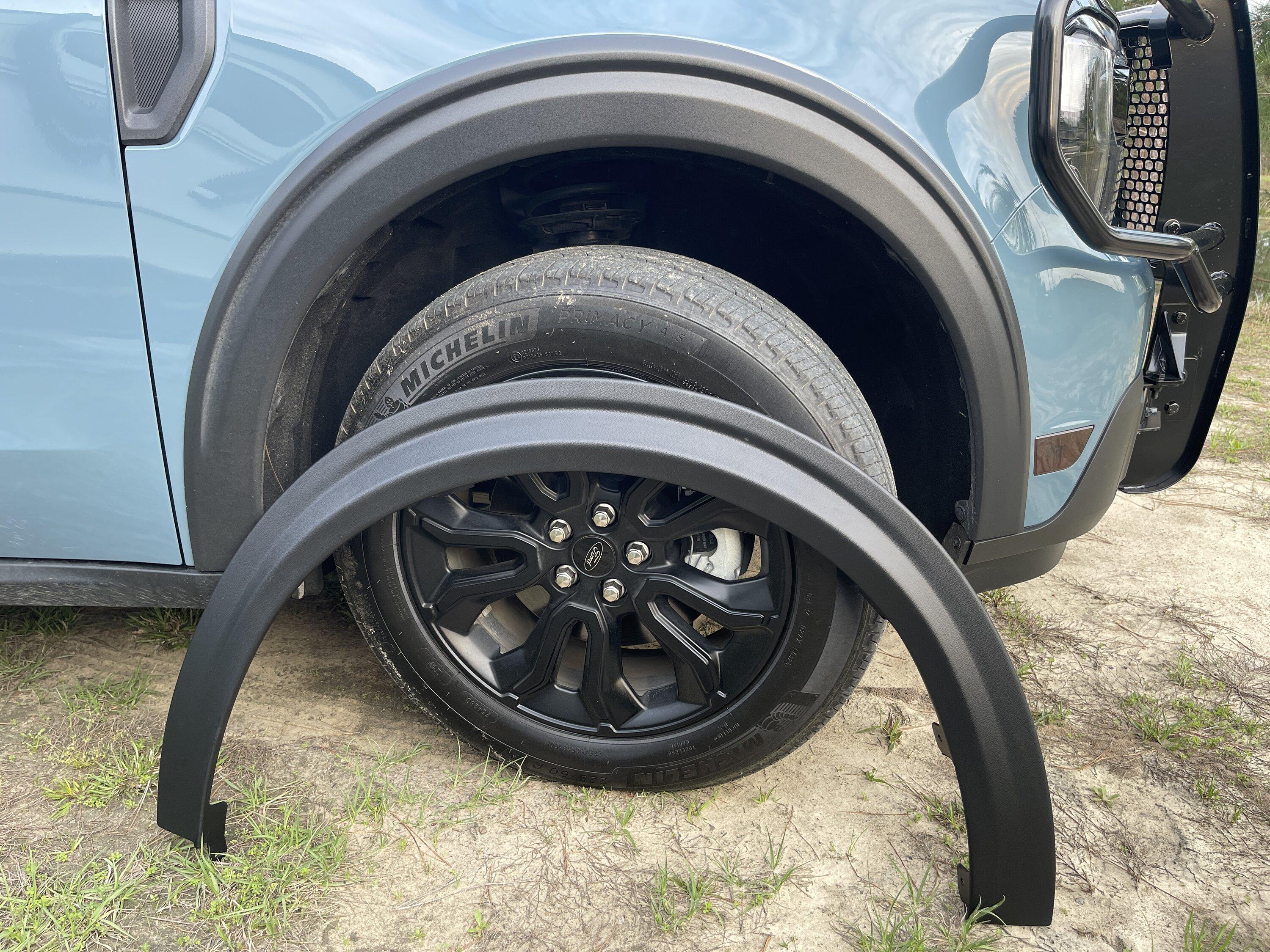

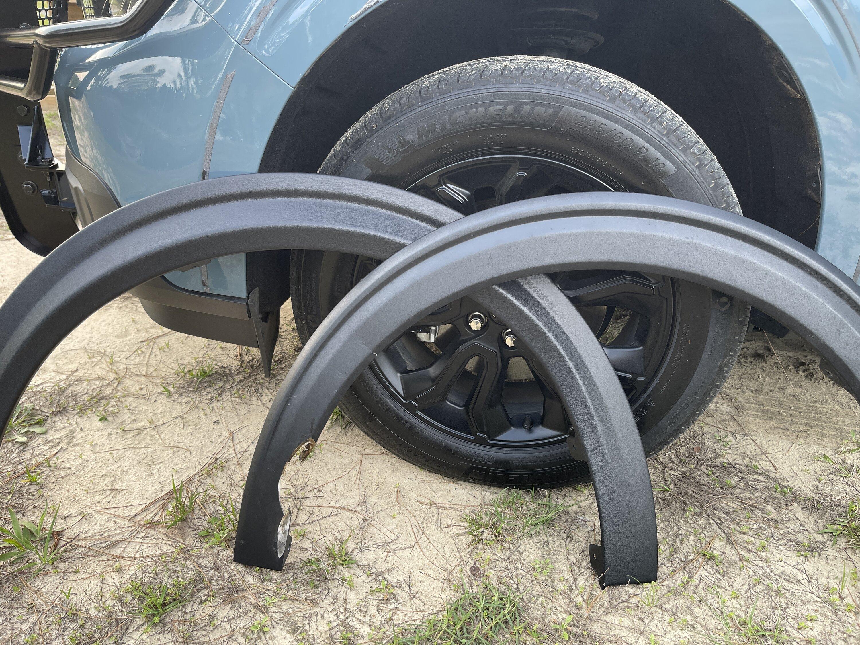

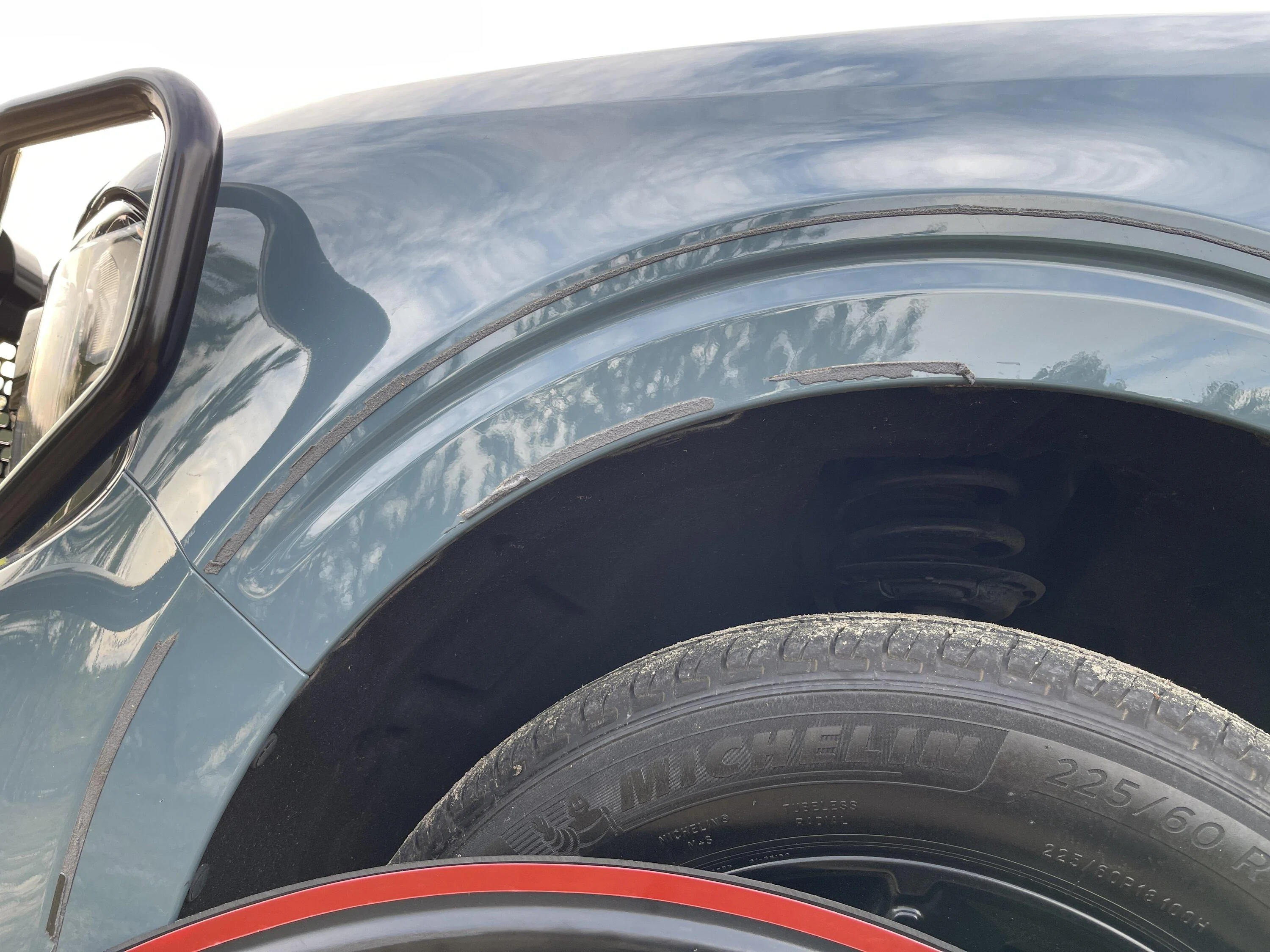

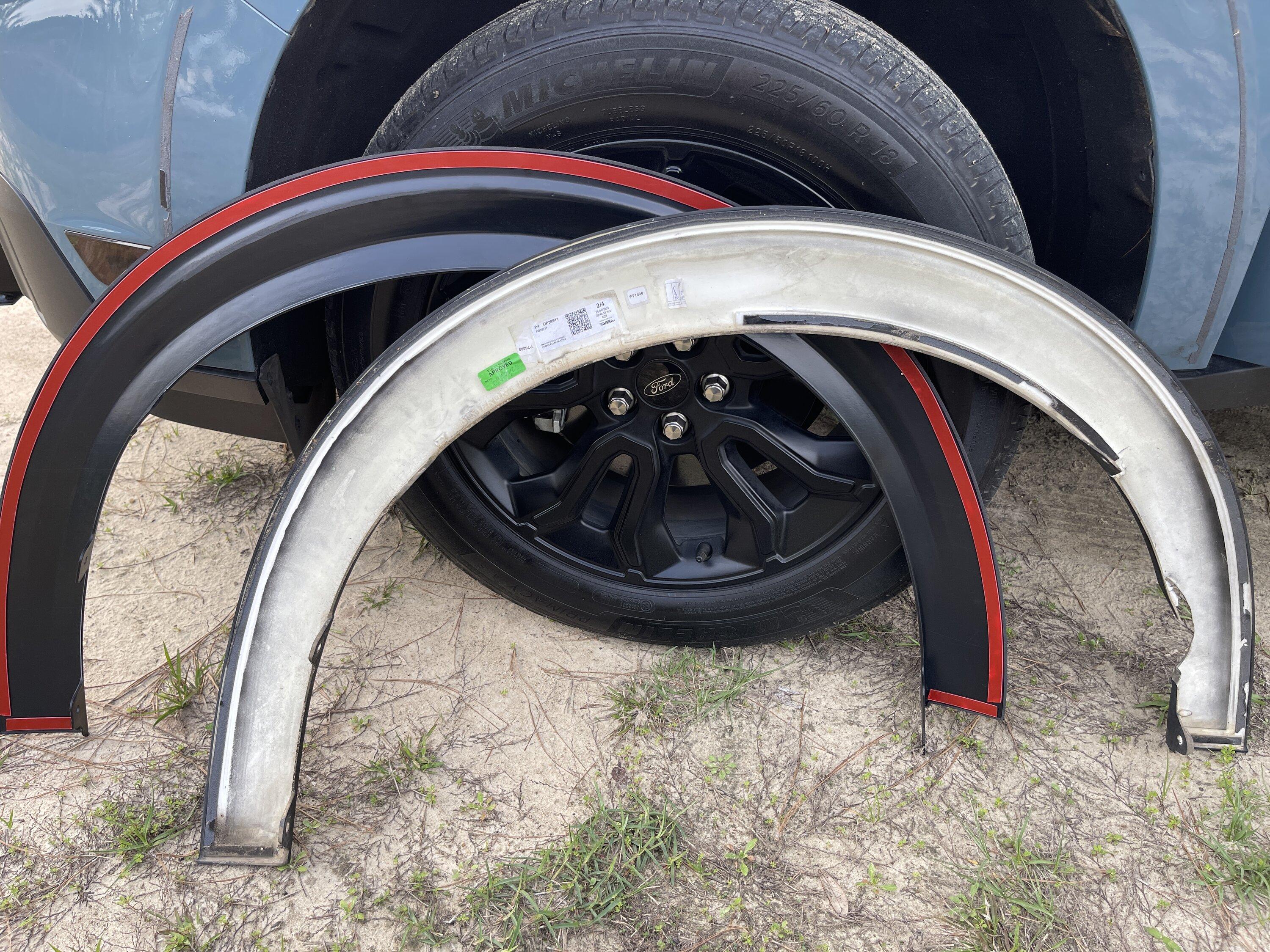

I had a slight incident with my drivers side Air Design Fender Flare and unfortunately they dont sell them individually. I will need to replace it and I'm considering just slapping the Mabett one there. Figured since I had them both out, I would send photos of them side by side. Now that I can compare them more closely, the air design one is thicker but not anything overly crazy. There is also an additional section that has the double stick tape. Minus a slightly different look, they both take up the same exact area and are the same size. What is interesting is that the Mabett ones do not come with any silicone glue. So I wonder if they will hold better or equally.
I do think that considering Air Design only sells in the set (and pricey at that). I would lean towards Mabett if I was going to buy a set for the first time. You can buy two sets so you have spares and still come out ahead price wise.

So I learned today that I can in fact buy the air design fender flares on their own. It's $130 something plus $50 for shipping. It would take 4 weeks to special order it. So with that being said, considering that I paid way less for all 4 of the Mabett ones, I think I'll just pull the air design ones off since they are already starting to fall off on their own in under a year, and stick the mabett ones on. Then I'll just order another set if one ever needs to be replaced.
I should also disclose that the air design ones say you need to glue them down in addition to the double stick tape. I did not actually do this and that could be why they are falling off. At the same time, I've had a ton of car parts over the years that were held on with just the double stick tape and never came off so maybe it is a YMMV type of thing.
