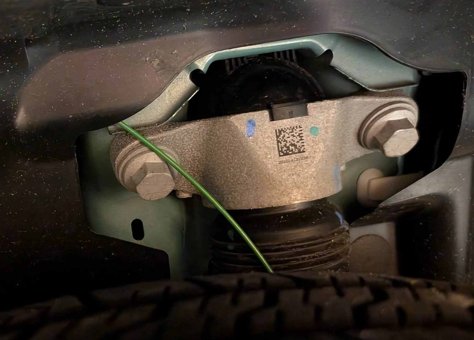

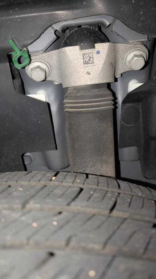

After lowering my Maverick and rotating tires, I noticed this loose green wire at the top of the rear shocks, driver side. I have no idea what it is.
Anyone like to take a gander?

If you own a hybrid, I've read that this is an emergency release to open your fuel door.
I do have a an AWD hybrid. Never noticed this wire before. I don't like it's just dangling there

It is an emergency fuel door release if the electric one on the dash fails. You must have the key on for it to work. Or be in ignition on mode if you have push button starting. I am not sure about the correct answer for it just "dangling" there. I thought mine seemed relatively secure. Maybe yours got pulled out some.

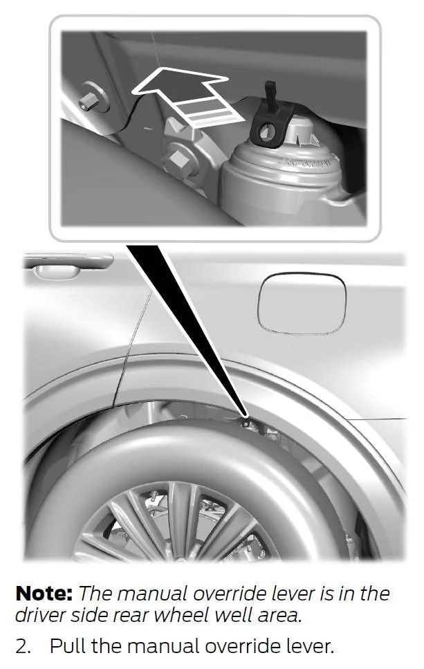

Here's the graphic from the manual (page 178) for my '23 Hybrid...

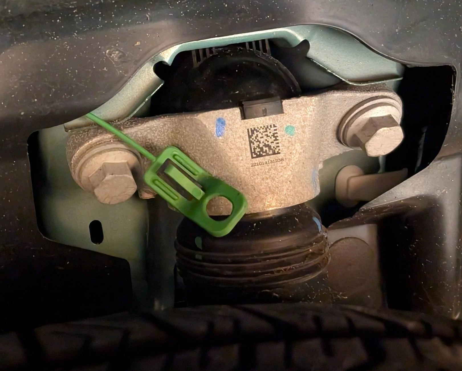

And here's a photo of mine, clipped more to the left...
Perfect. Thank you. I honestly should read the manual from cover to cover. I just focus on maintenance.
