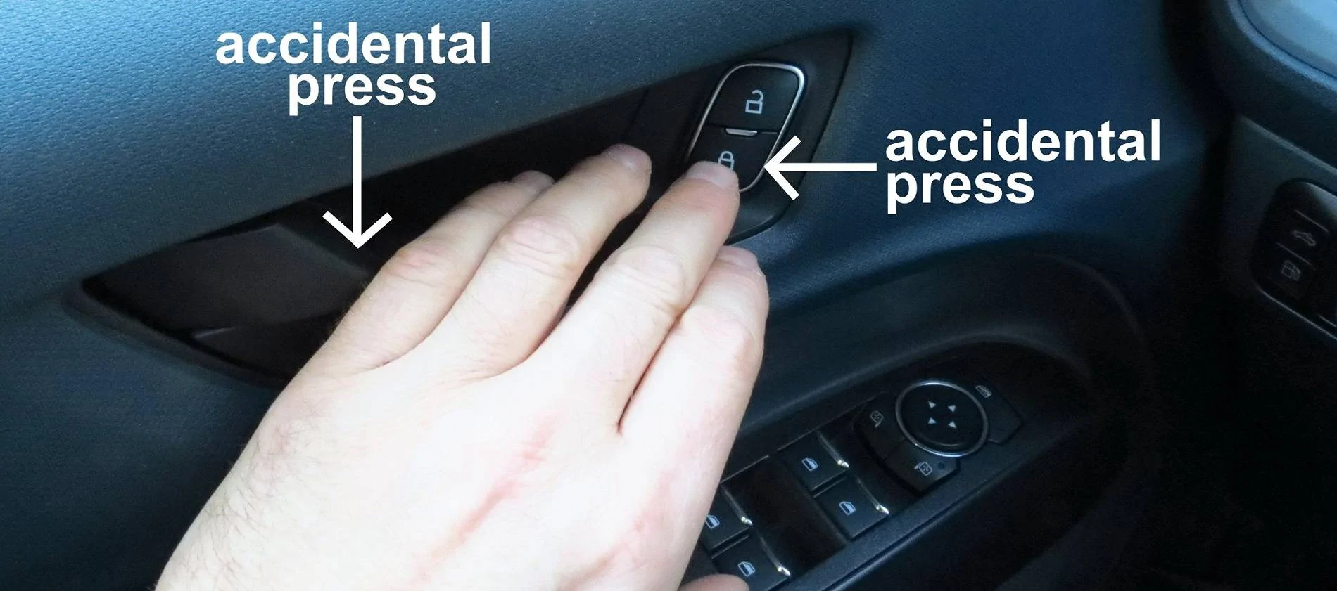

For those not familiar - When grabbing the door lever to open the door, the side of your hand can accidentally push in the mechanical lock lever and a fingertip can also accidentally press the power lock switch.

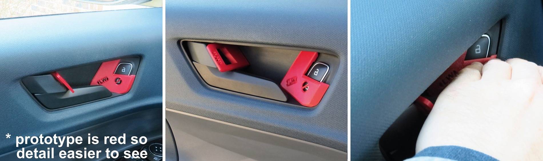

Measure, draw, print, fit, and repeat. Lots of trial & error involved but I ended up with a simple solution that works well.
Ford Maverick Lock Guard - Solution for Accidental Door Locking lock_guard_design

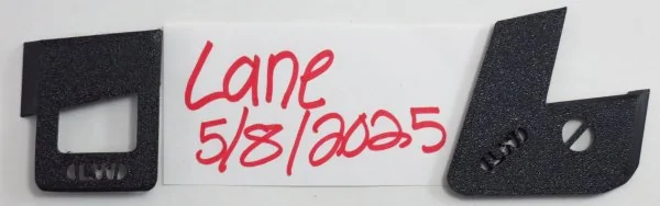

So here's another item from Lane's Workshop (see my signature below for the other items I make & offer)... the Lock Guard.
Ford Maverick Lock Guard - Solution for Accidental Door Locking lock_guard_prototype2

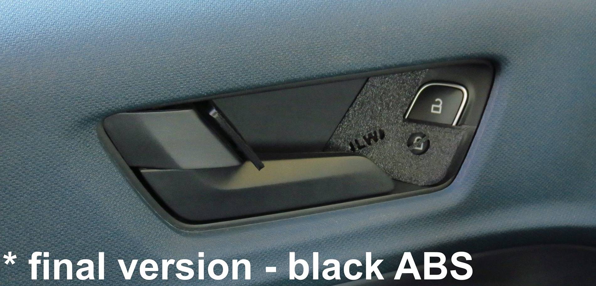

Both pieces are mounted using 3m VHB adhesive tape. The left piece mounts next to the mechanical lock lever and sticks out about 5mm beyond it. It prevents the lock lever from being pressed with the side of your hand since your hand will contact that part and not the lever. The lever can still be pressed, but only on purpose now.
The right piece mounts over the elec lock switch and prevents you from pressing the button which locks. The unlock button remains available. If there's a need to lock all the doors, the button on the fob will need to be used.
Ford Maverick Lock Guard - Solution for Accidental Door Locking lock_guard_final
This project turned out great so if anyone wants a set, I'd send them your way for $10. Add $5 for a flat shipping cost and that covers anything else that you may want to purchase at the same time as well (see my signature for the other items I make). Each is held on securely with good quality 3M VHB foam adhesive tape. Also be aware that these install on the driver's door only and cannot be installed on the passenger door. PayPal is strongly preferred as the payment method. If you have an interest, please send me a private message (don't post to this thread).

So it prevents the door from locking totally?
No, the left piece prevents the side of your hand from unintentionally pressing the mechanical lock lever as you pull the door handle. You can still press it intentionally with any finger. The piece on the right sits over the electric lock button so you cannot press that button. The door can still be locked by pressing the lever or using your fob.
Since you are blocking the actuator above the handle I would think it would not allow any locking.
The left piece does not interfere with the motion of the mechanical lock lever. It sits next to it and is attached to part of the pocket trim next to that lever. All it does is keep the side of your hand from pressing the mechanical lever.
Am I missing something? I have a Lariat so my fob stays in my pocket maybe that is why I don't seem to experience this problem.
I don't follow. The accidental locking is from a person's hand and fingers pressing these things inadvertently. The fob has nothing to do with that problem. It does seem like there are others reporting other weird automatic locking behavior, but these parts address the simplest cause of accidental locking - unintentional presses with your hand and fingers.
