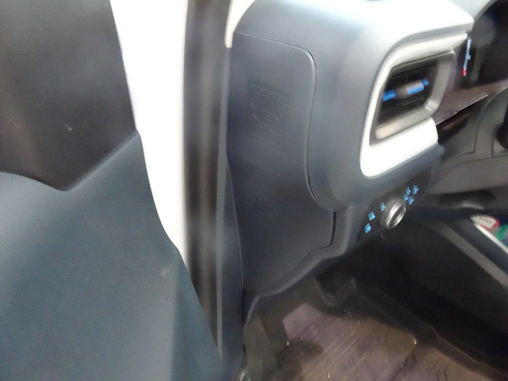

The left "dogleg" area when door is open has a cover marked "Airbag" - photo attached.
Can this cover be removed without setting off the airbag? I need to look behind the part of the dash to determine clearance for switch panel installation, this cover seems to be the best one to remove to have a look-see.

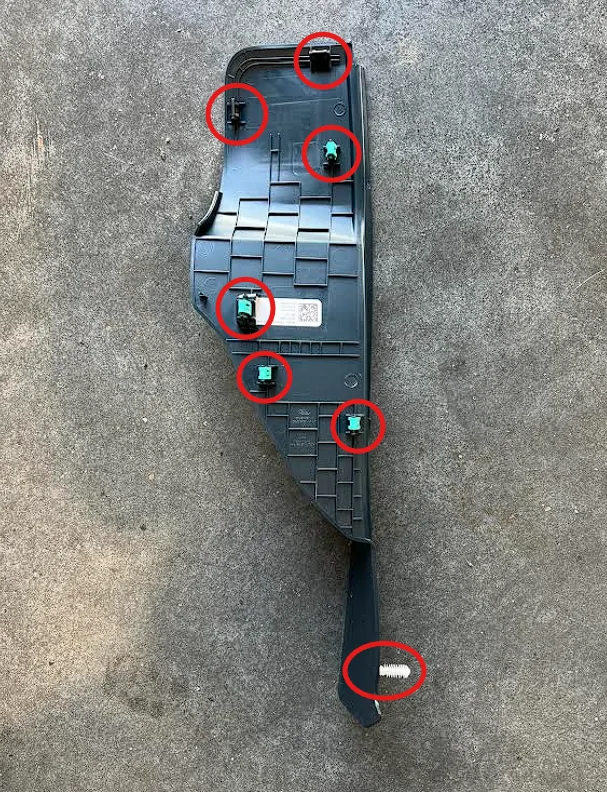

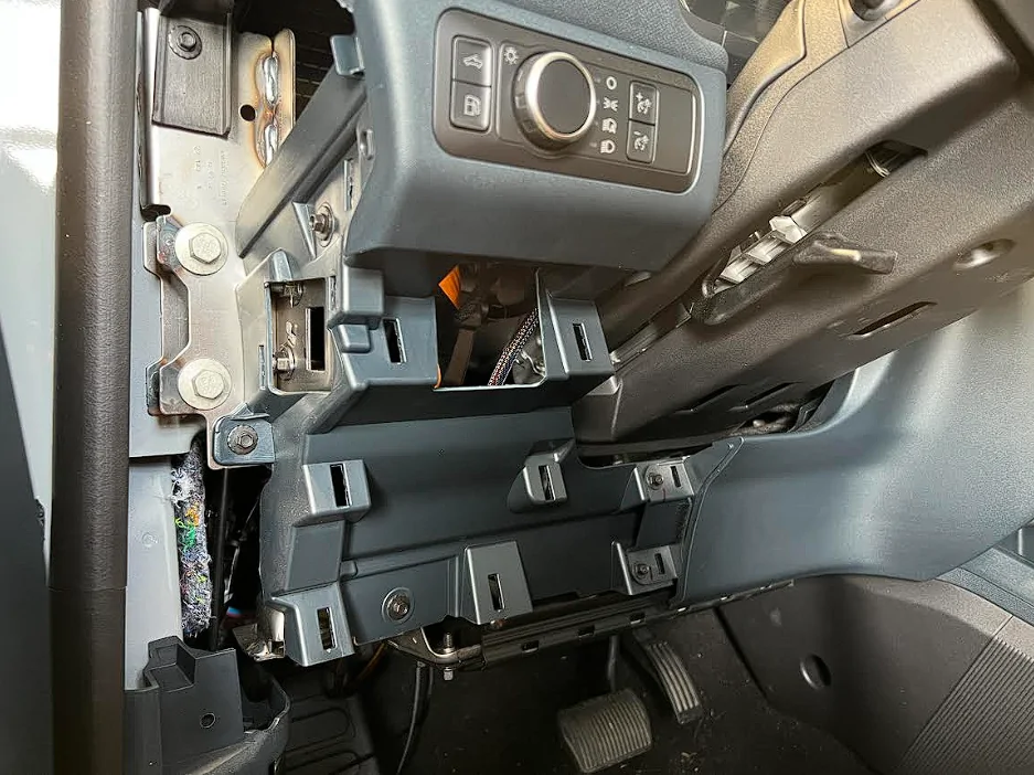

I dug up some old pics of my 2022. I don't think it would have changed for 2025+.
Ford Maverick Left Side Airbag Cover 1777939077005-nu
That panel has 7 clips total. The fir tree clip at the bottom is a bit of a pain to get loose.
Ford Maverick Left Side Airbag Cover 1777939308339-eu
