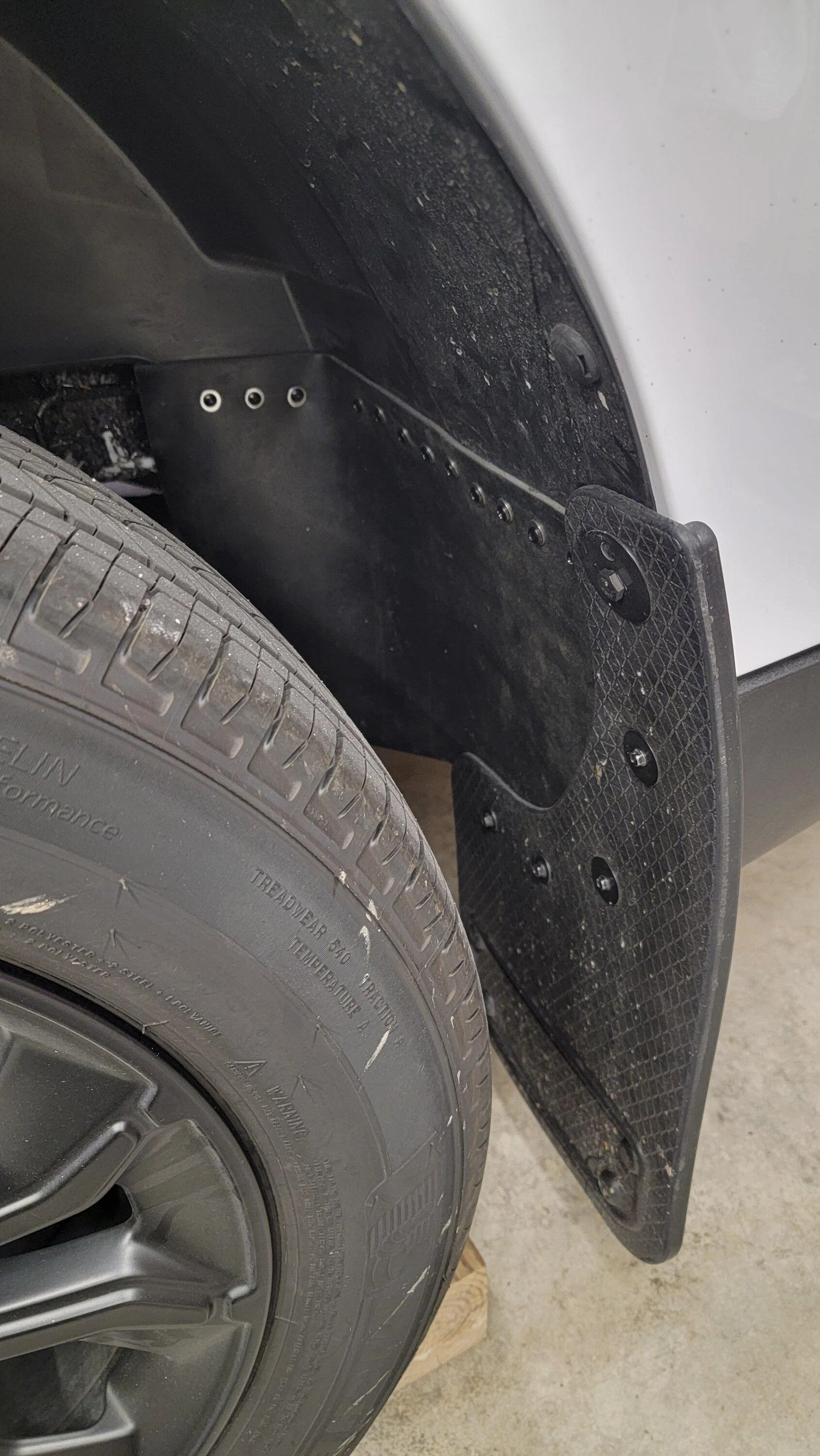

I expected more resourcefulness and creativity from this group. I did find where another member @23grayXLT84 fashioned a plastic panel. I have a piece of rubber sheet coming and will do something similar, just extend the inner fender around to make it complete. The tailpipe is not close enough on the hybrid to even worry about. Hopefully the folks at Husky are taking note and will come out with a set of their wheel well liners for the Maverick.

Here is my current patch with the rubber sheet. I will watch how well it holds up and protects behind it this winter. I will add a horizontal panel if needed.

I see yours is a 23, I was wondering if FoMoCo did anything to address the issue; fully doubted they would. I have a 24 (23 roll-over) scheduled to be built week of Feb 5th, I'm sure I'll have to do the same as I did on my 22. Your rubber sheet will most likely prevent most (if not all) debris from being thrown up onto the back of the driver's side taillight. Keep us informed.

The RBs do not touch a painted surface anywhere. Screwed to fender liners with spacers leaving a gap to the fenders.
@Hammerstein good job, best I've seen. That would work with the Roks as well.
