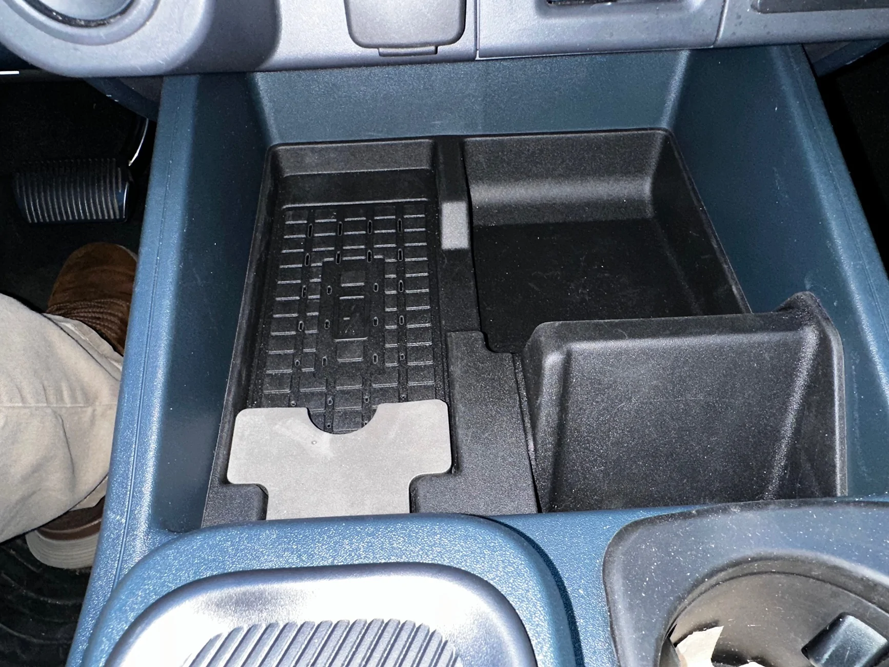

I grew tired of dropping my iPhone onto the charging pad in my Lariat only to discover it moved and lost the charging sweet spot. I took an EV foam mat and laser cut a filler. Now my phone locks into place and holds the phone in position for charging.
I have a iPhone 16 and the phone constantly will shift in the cradle on my 2025 lariat. It will randomly stop charging, but when it does charge. The phone will overheat. I kind of gave up on the built in wireless charger.
