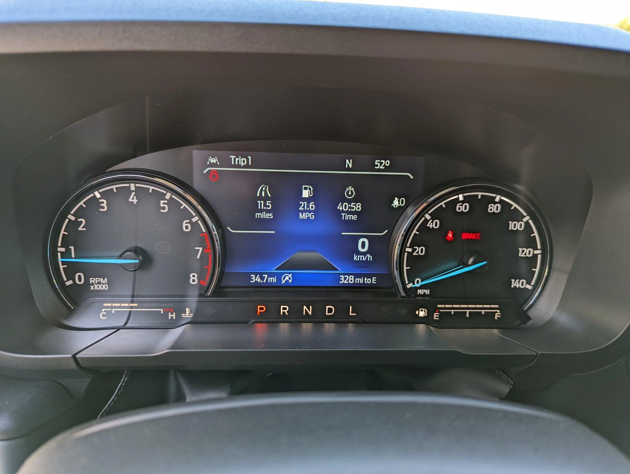

I just got my Maverick, and both my salesman and I could not figure out how to change the digital speed from km/h to mph. The analog speedometer is in mph, and the odometer and trip are in miles as well. Where is the menu to change this?

for those (like me) who are finding this thread and wondering what the fix was, it's not page 118 of the manual. it's page 117.
use the steering wheel control to go to menu > display setup, then page up or down to get to a checkbox that selects/deselects km/h speedometer.
it's not intuitive because depending on how it loads the display setup menu, you may not see all the available items.

How did you do this. I have followed the instructions and the digital readout refuses to change?

I have a similar problem but not exactly the same. 2025 Lariat Hybrid w/4K tow.
(I have searched the web, google, and the Owner's manual.)
All of my units are in Imperial unit mode rather than metric except ONE. When I enable the secondary speedometer the PRIMARY displays metric and the secondary in Imperial. If I turn off secondary the Primary is the Only display and it is in Imperial (MPH). I want to use the secondary speedometer but have the PRIMARY be Imperial (MPH) and the SECONDARY to be metric (KPH).
Any ideas?
