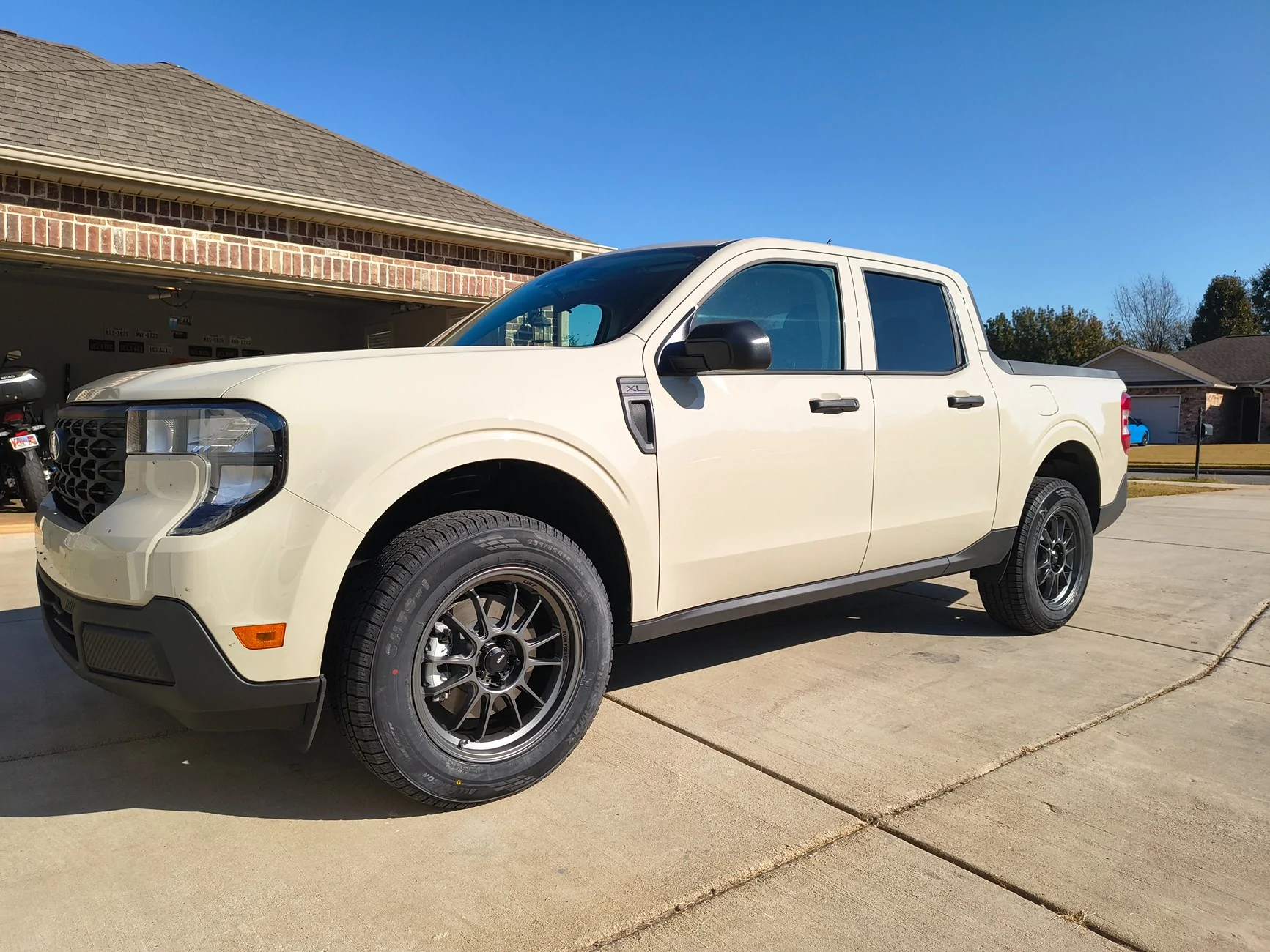

Recently got my GWR Front Leveling Springs and Rear Sway Bar installed, so decided to upsize the dinky 17" OEM XL wheels/tires. :)
Opted for Konig's 18x8.5 Hypergrams in Matte Grey (+43mm Offset) and a set of Crossmax CHTS-1s in P235/65R18.
While the OD increased from ≈ 28.5" to 30", I actually shaved almost 6 lbs. of unsprung weight at each corner. 😁 I ran Konigs on my Miata for the longest time and love the combination of strength and light weight. I'll post my OEM Wheels/Tires up for sale shortly (including the spare), in case anyone is interested. 👍

are front tires larger in diameter than rears?

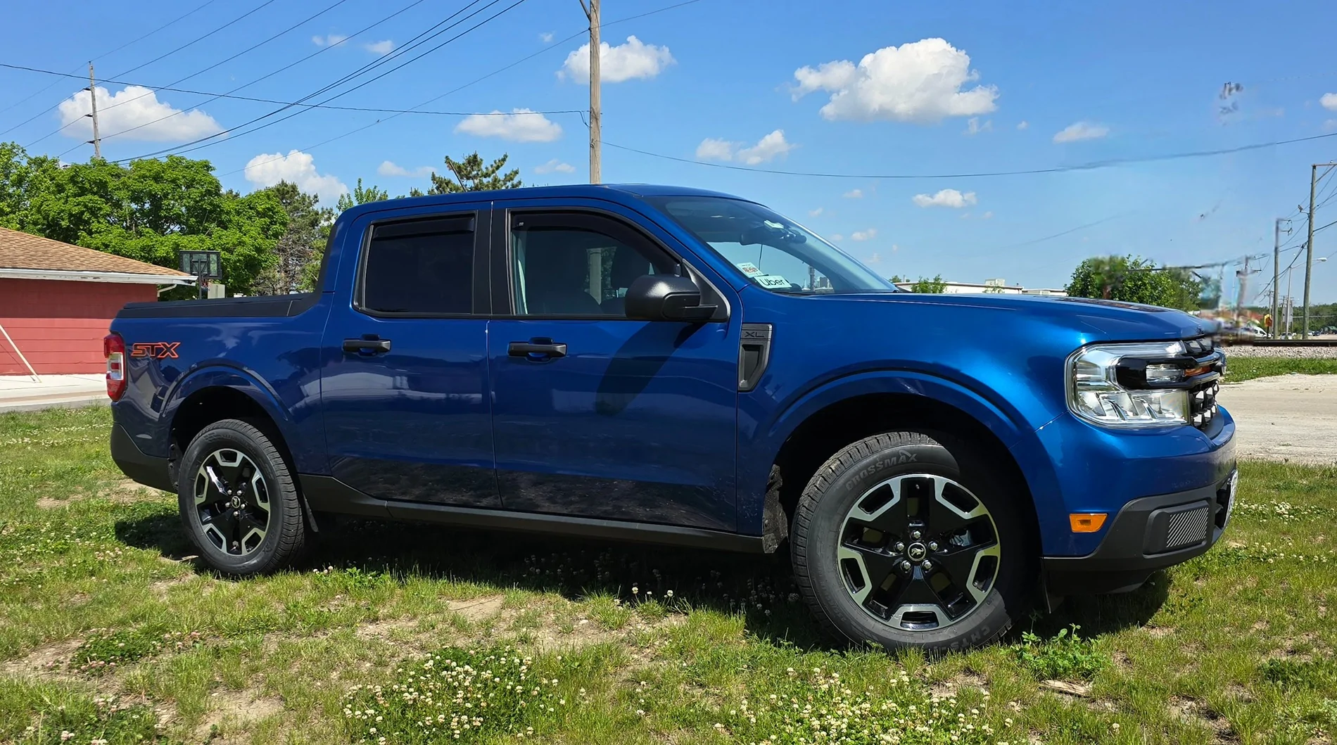

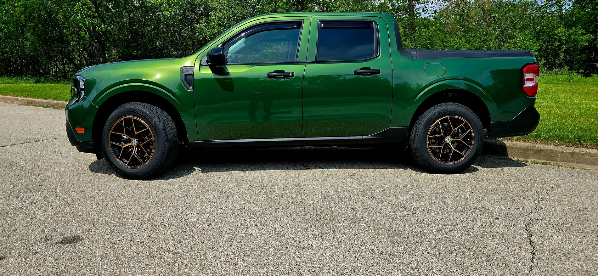

I'm on my 3rd set of this exact tire. Big fan of them!

Looking beefy

Looks awesome!
How much does each wheel weigh?

Konig lists them as 17.41 lbs./each. A marked savings over the 27.2 lbs./each weight of the OEM 17" steel wheels. 🙂
