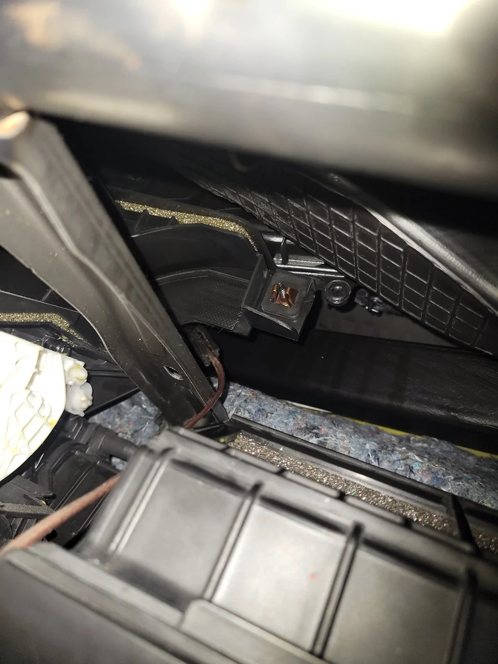

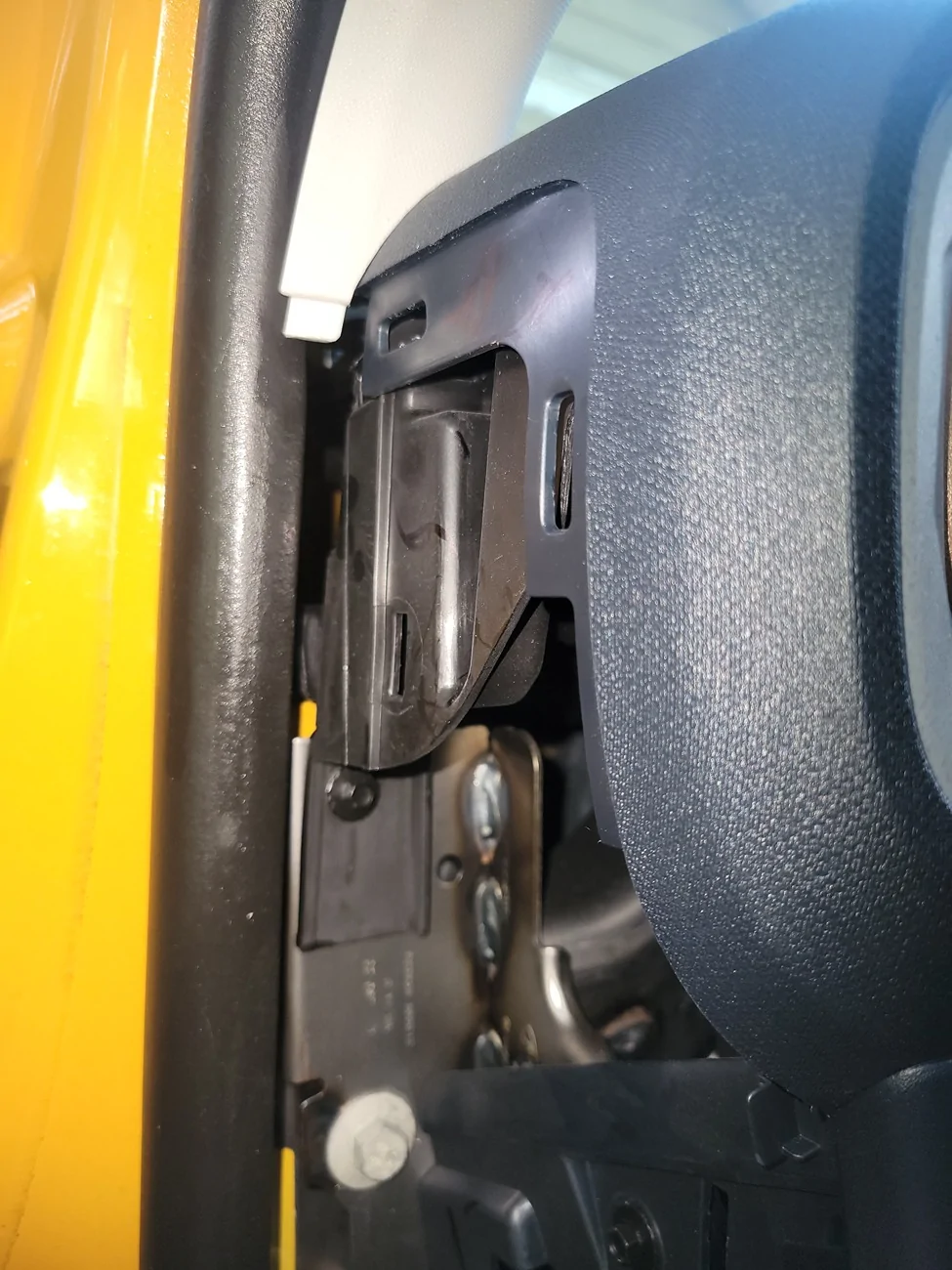

The tweeters fits nicely with very little mod. I didn't take pics .didn't think about it, sorry. But I did take pics of wire route for LH tweeter.
For tweeter fit there are little tabs that stick out at bottom oh thr hole. I used a heated flat head screwdriver to melt it flat. Easy to see from outing through the windshield. And the tweeter pushes right down below the clips.

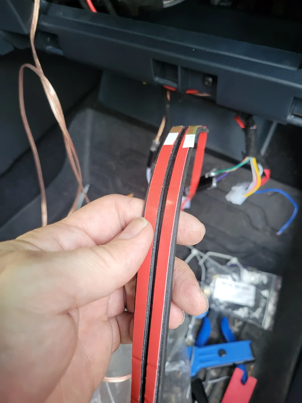

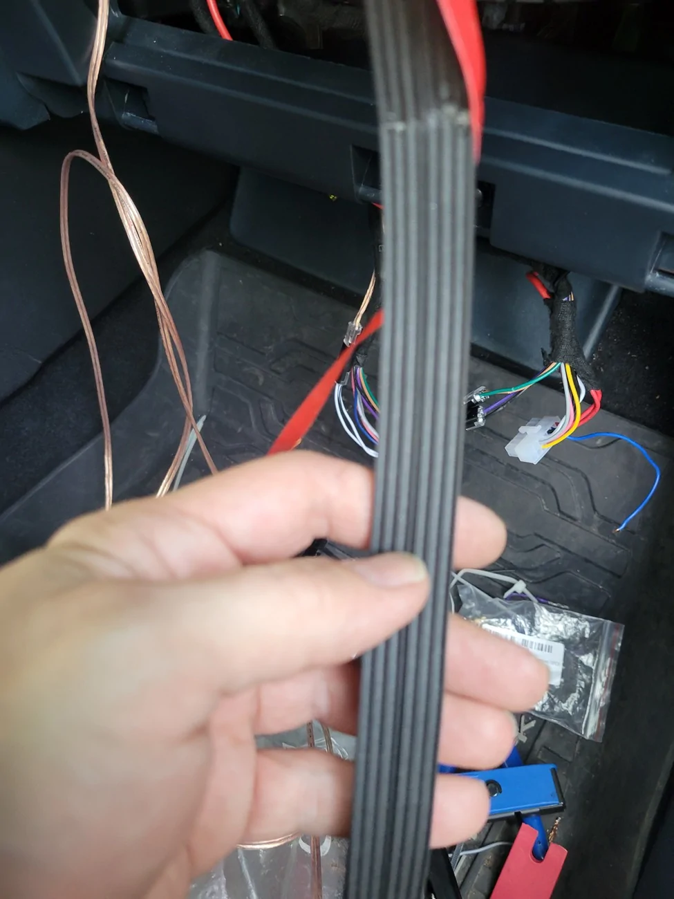

I routed the seperate speaker wires under the dash, over the air vent piping. Wrapped wires in thin weather stripping and used a searched cout hanger to push it through. The stripping is for rattle noise on vent tube lol.
I used another piece of hanger to hook it and pull it through the tweeter hole. Actually easier than it sounds. The side panel was removed so I can see the wire where it was before I hooked it. $80 speakers sound great.
