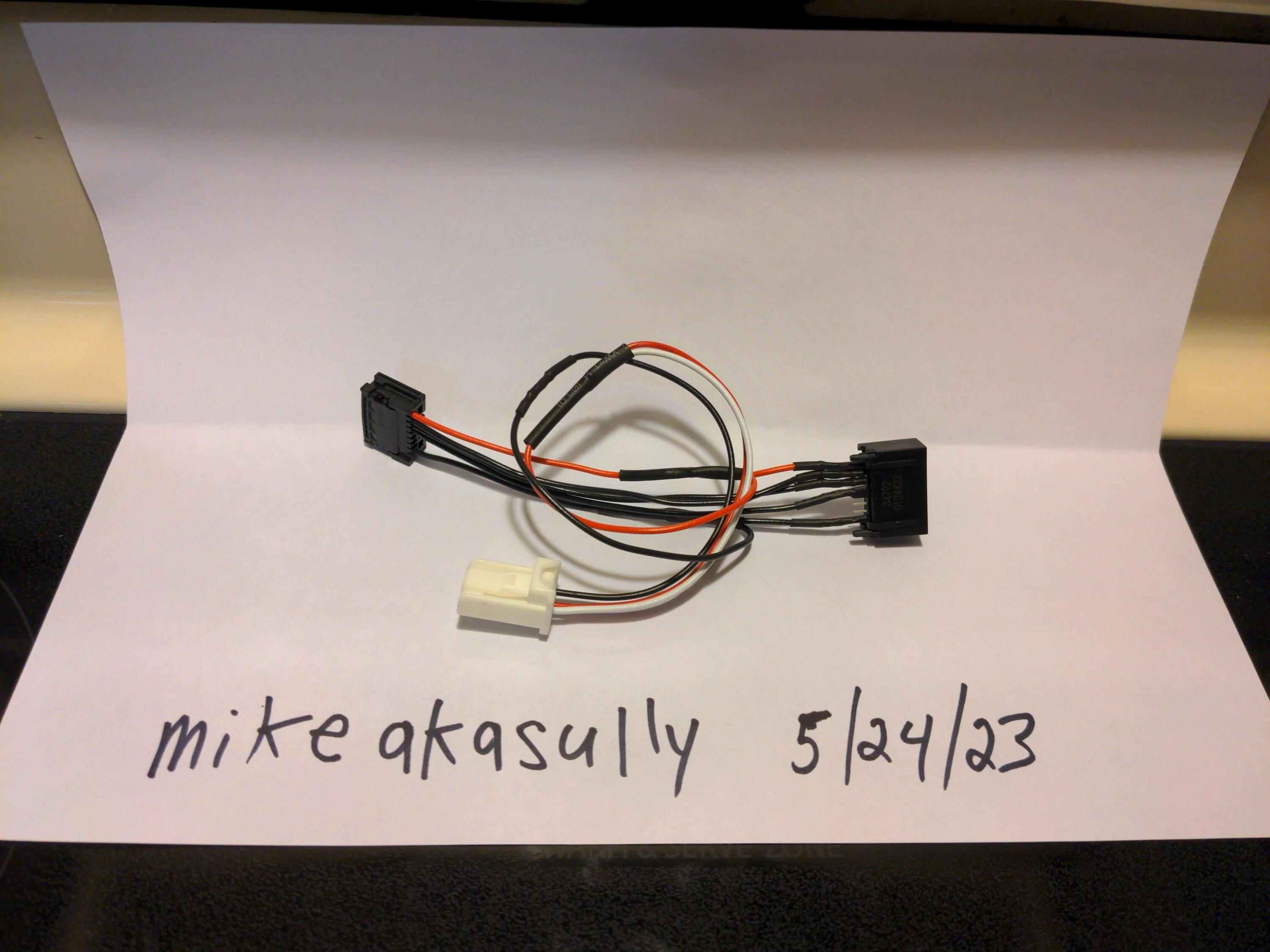

No, just the connector on the mirror itself. I needed the compatible mating connector to build a harness.
I used the SAME molex pins on each end of the patch cable. They are pushed onto the pins in one end, and pushed and locked into the plastic socket on the other. I made three cables and realized this was the easiest way to prepare the wires. Pins on each end. Then the end with the pins that go over the socket pins need shrink tubing to keep them separate from each other, before wrapping with a nice cloth tape to make sure everything stays in place. IIRC, the pins are not actuallt square openings, more of a slight rectangle...so take care when you push them onto the pins.@mikeakasully or Anyone else that knows, The Molex Pins Mouser #: 538-560023-0421-LP (Molex Part 560023-0421) That are referenced in the parts list to do a DIY interconnect pigtail / connector. Are these non-gender specific ? meaning does not require a male pin to mate with this part that looks like a female connector ? is this sort of like the way Anderson Power Pole uses same connector for connecting ? I have made up patch cords etc. using Molex brand connectors / in the past but they all had separate male OR female terminals that interconnected.

Not making anymore, but I'll provide some instruction.
So for the pins you need 10 of these (order more than that for screw ups): https://www.mouser.com/ProductDetail/538-560023-0421-LP
1 Female connector: https://www.mouser.com/ProductDetail/538-34791-0080
1 Male connector: https://www.mouser.com/ProductDetail/538-34792-0080
To crimp the pins I recommend the following crimper on the smallest setting: https://amzn.to/45XiXsz
For the 5 pins that will go into the female connector you need to pinch them a bit after crimping with a needle-nose pliers to flatten them on the sides to get them to slide in. A good small pick helps pull them in if needed.
Attached is the pinout of the connector. I use pin 1 for positive power, and pin 8 for ground. When you get the connectors if you look close you can see the 1 and 8 numbers on them to determine which pins are which. Pins 2, 3, and 4, I just pass them through as they are used by the dome light.
There will be a 5 pin connector kit that will come with the mirror. The one with the white stripe and the wire next to it are positive, they can be spliced together and connect on the wire on pin 1. The last wire to the far side is the negative and can be spliced into the wire on pin 8.
If you have a small hot work station or mini butane torch these make splicing the wires on 1 and 8 easy: https://amzn.to/3P6qEWw
Also on the male connector I crimp on the pins and then solder them on and them cover them in heat shrink, but liquid electrical tape you can find at any hardware store works good to.
