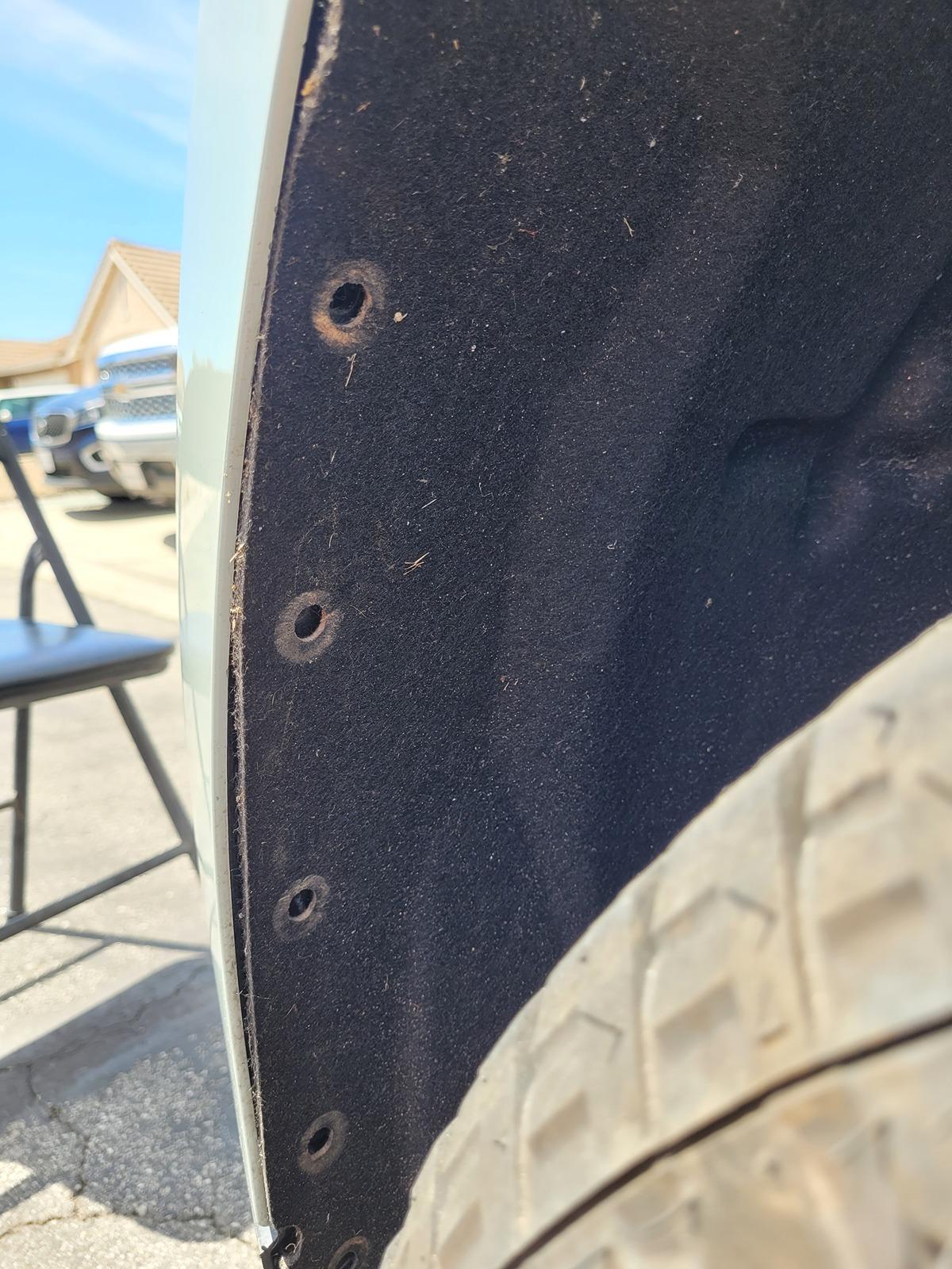

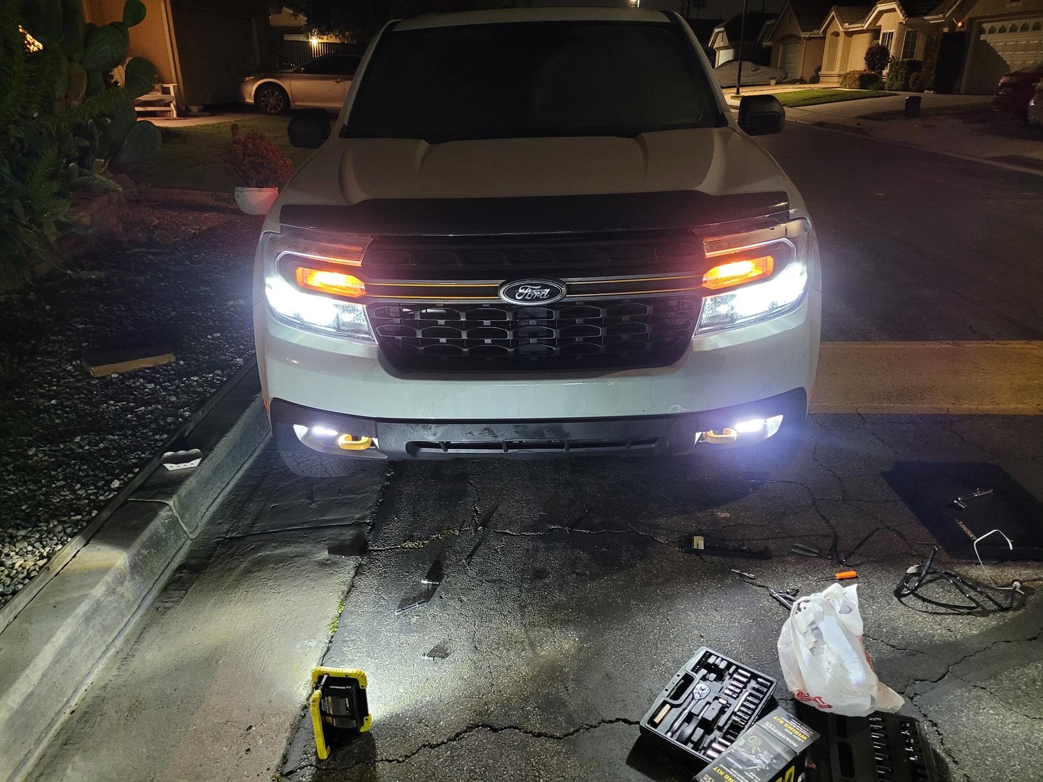

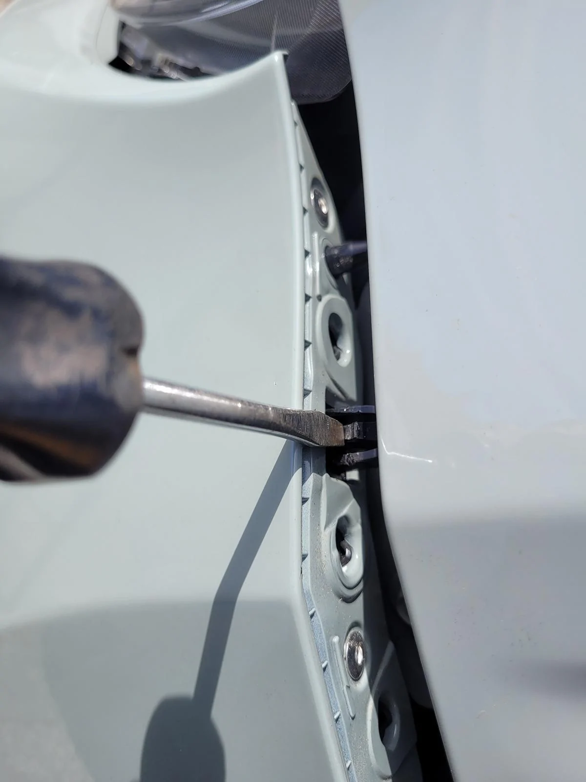

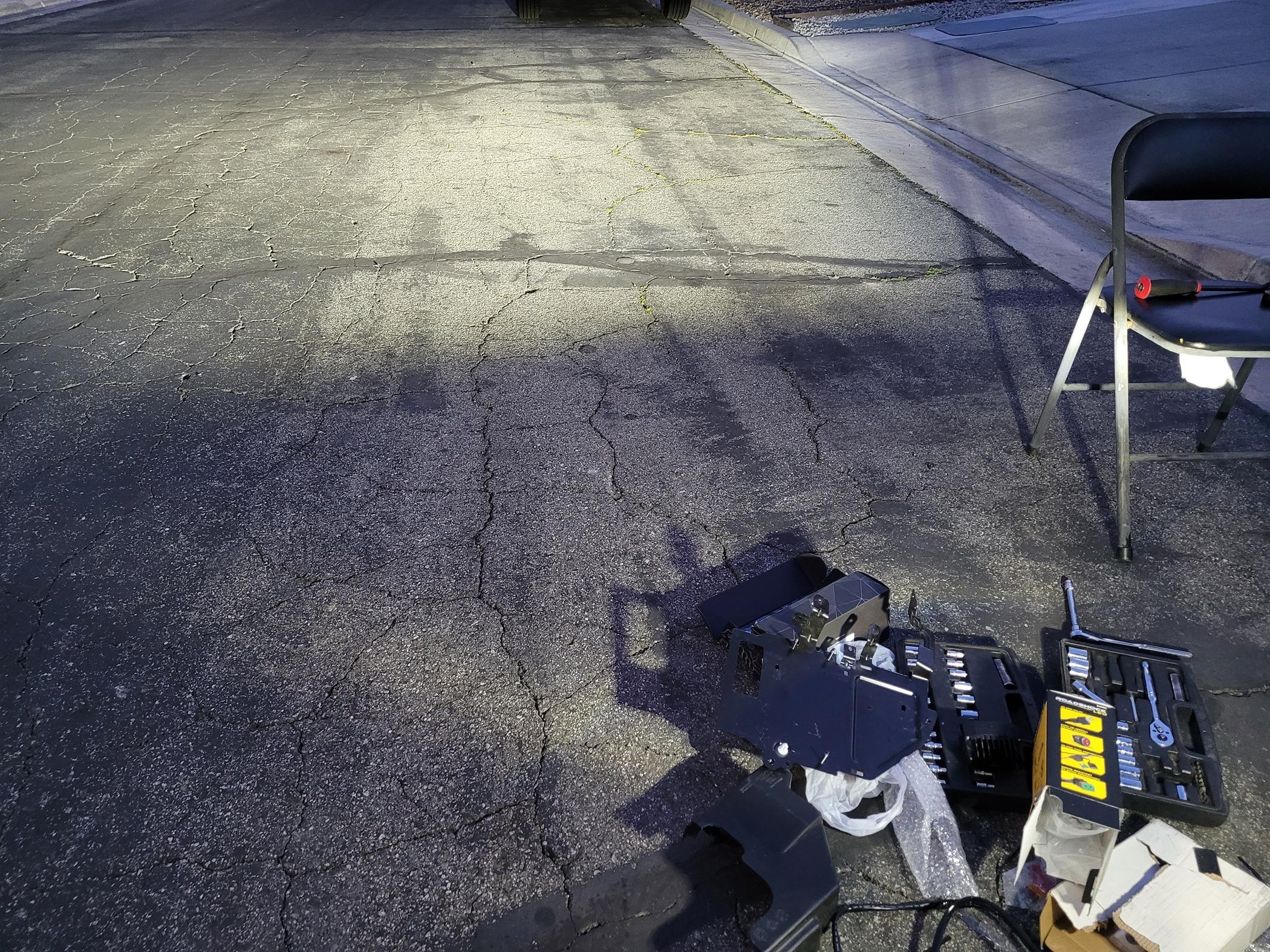

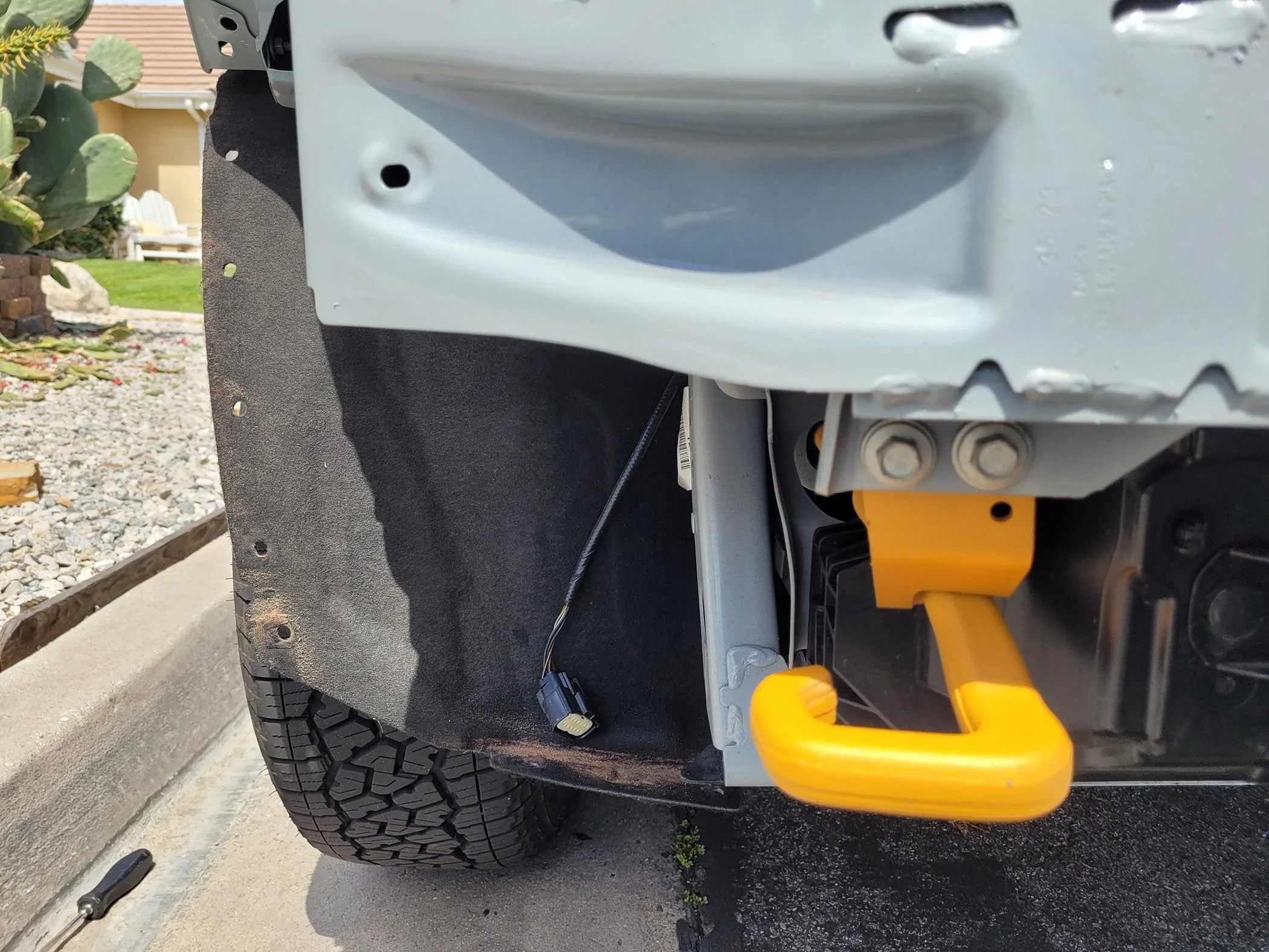

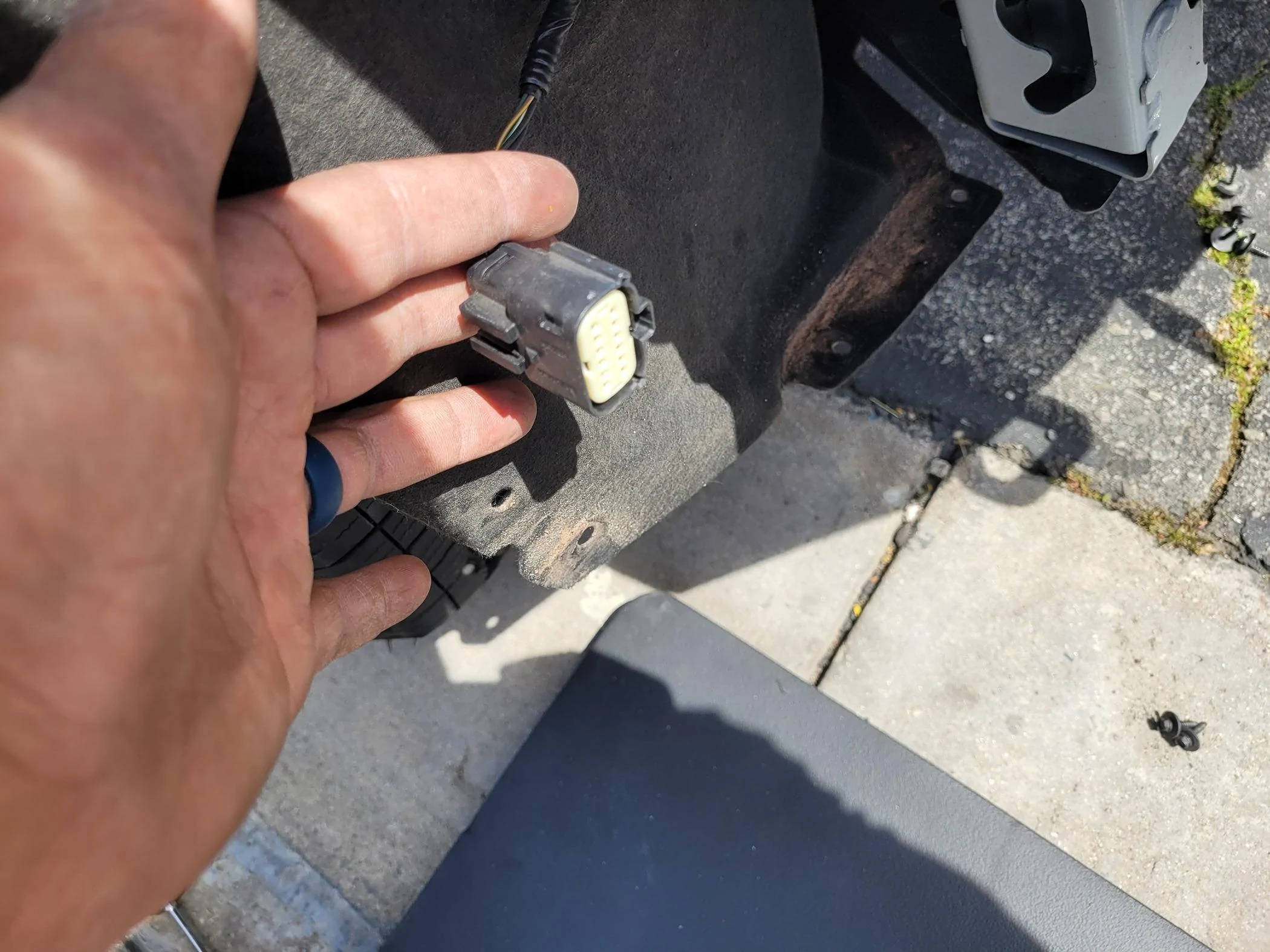

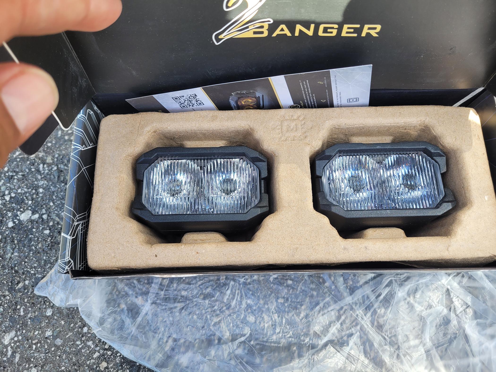

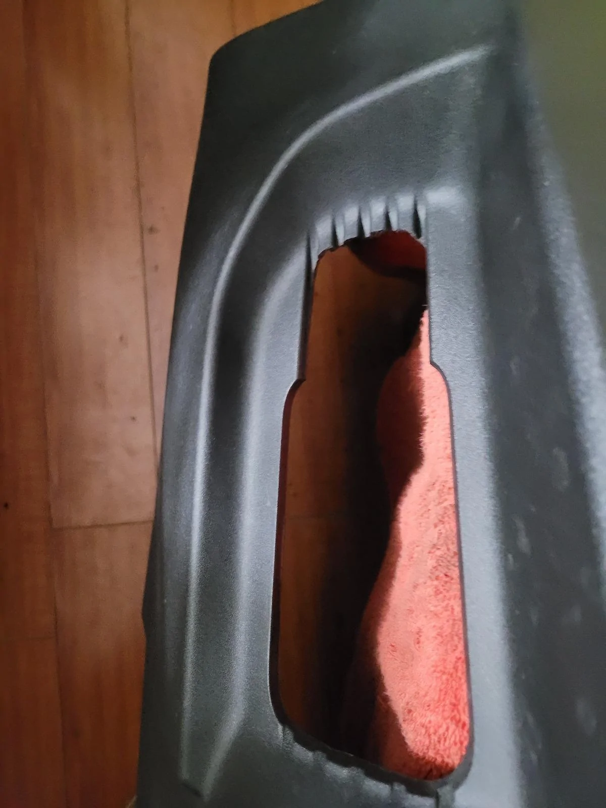

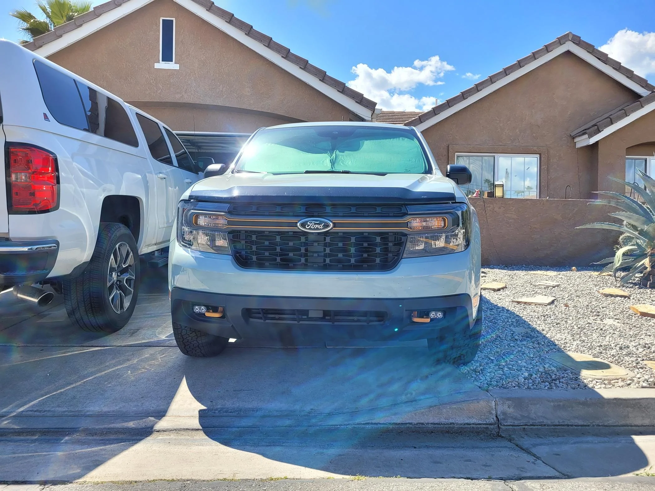

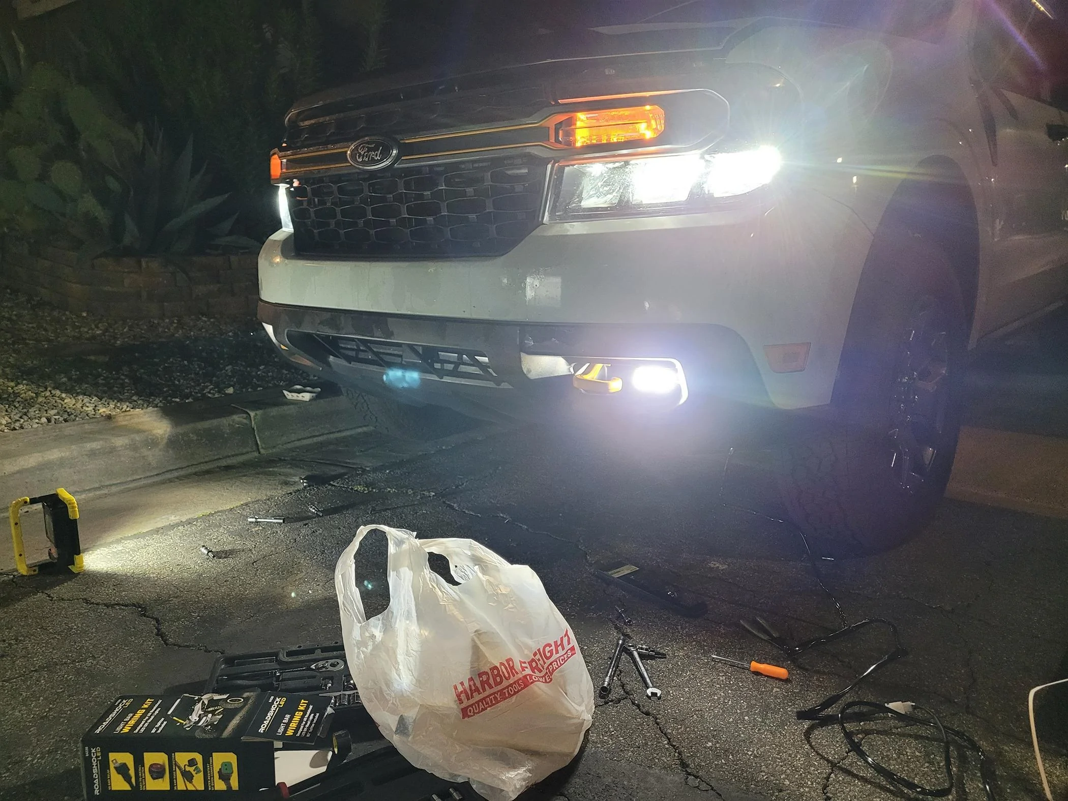

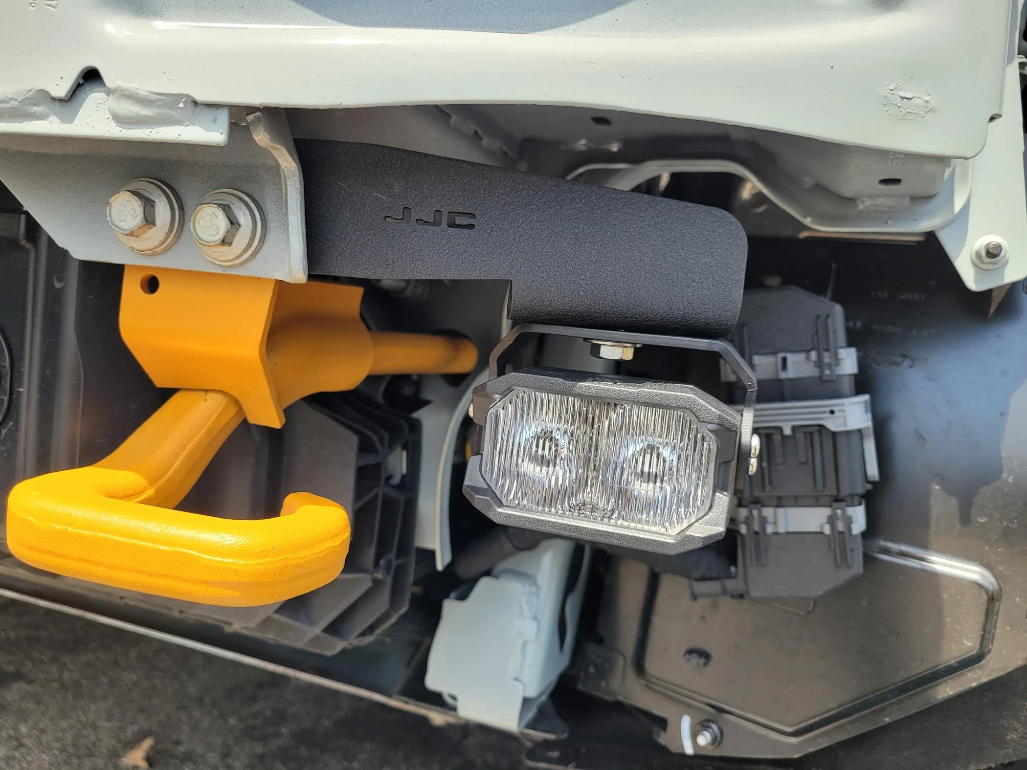

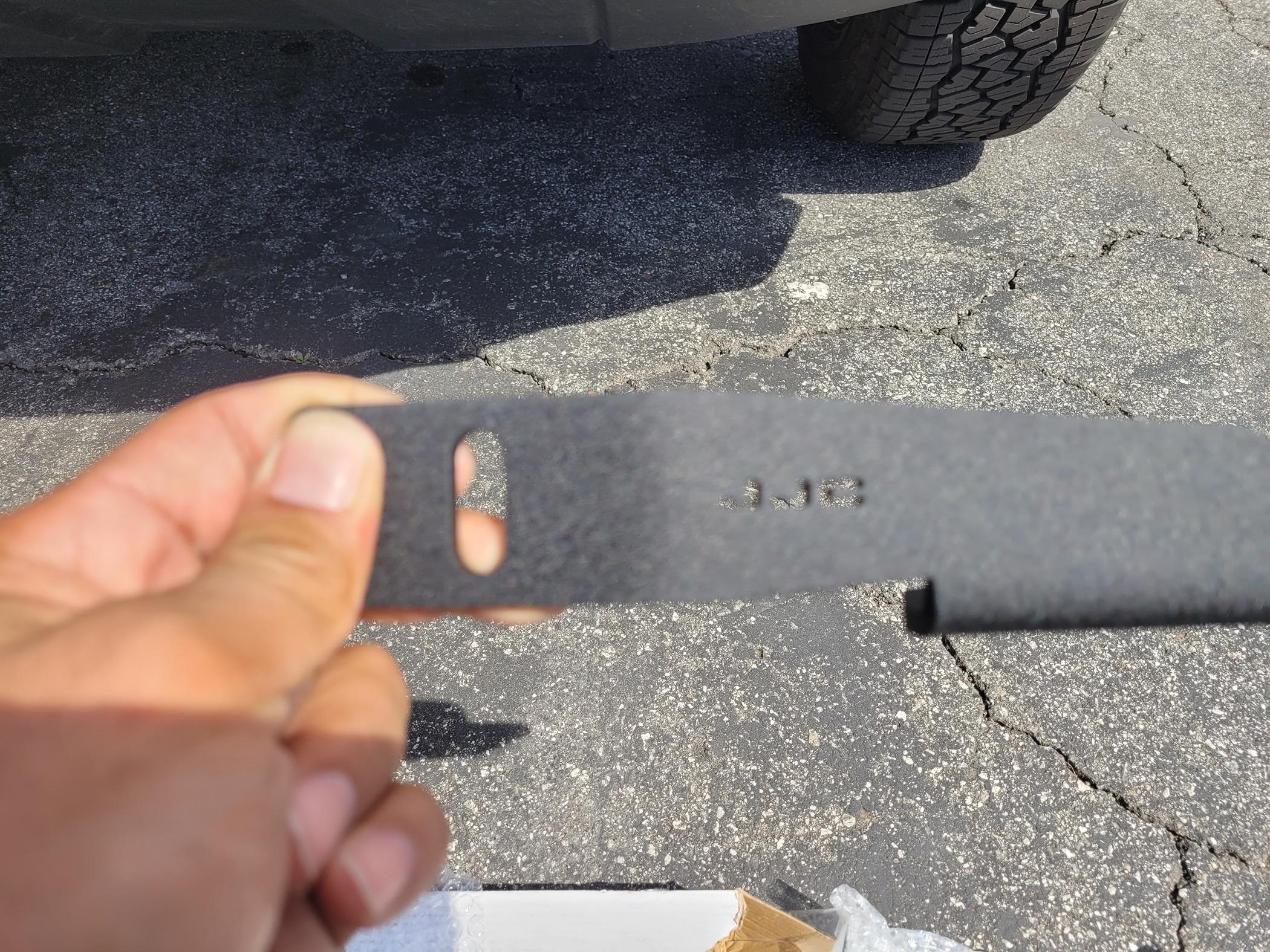

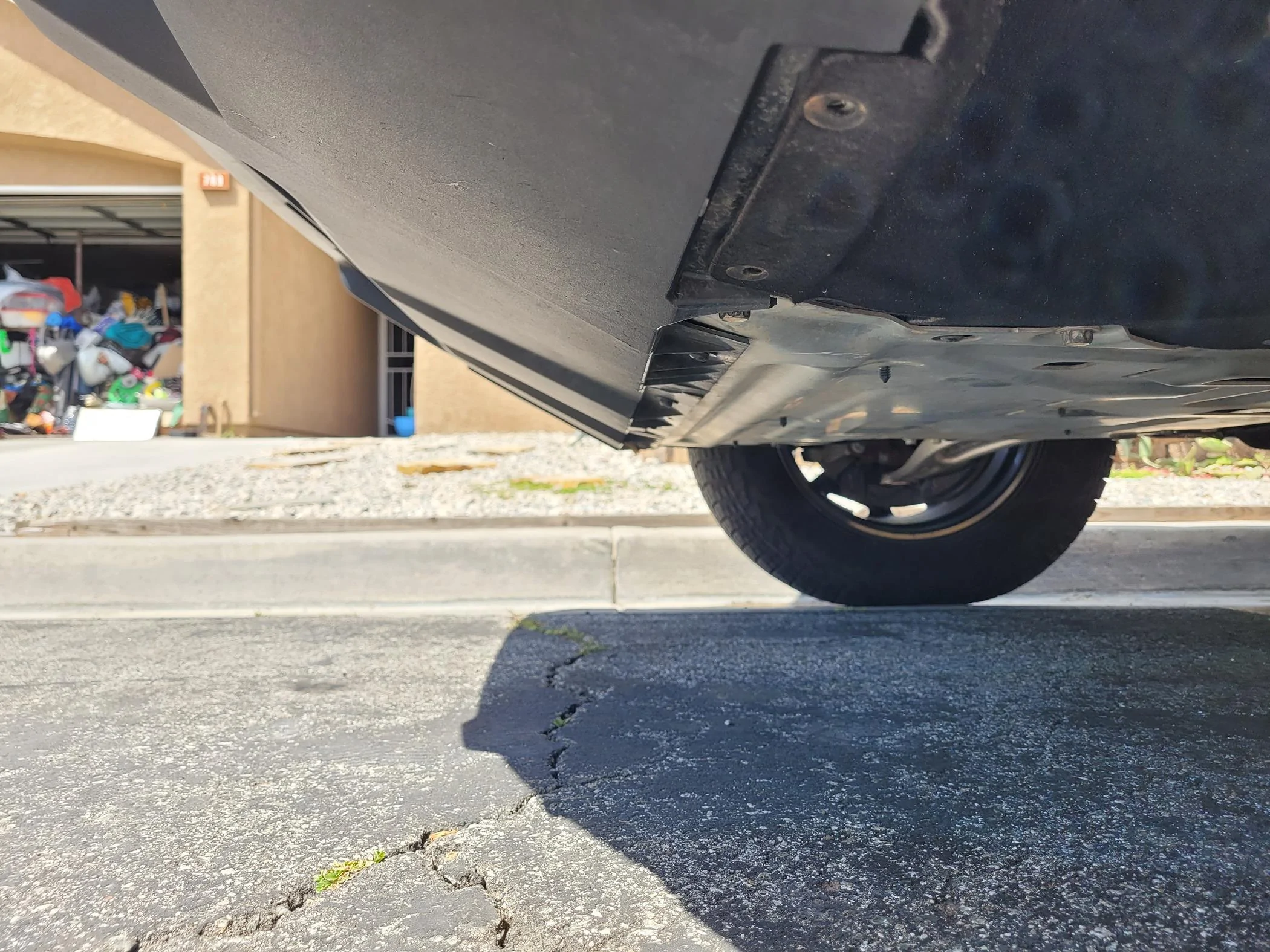

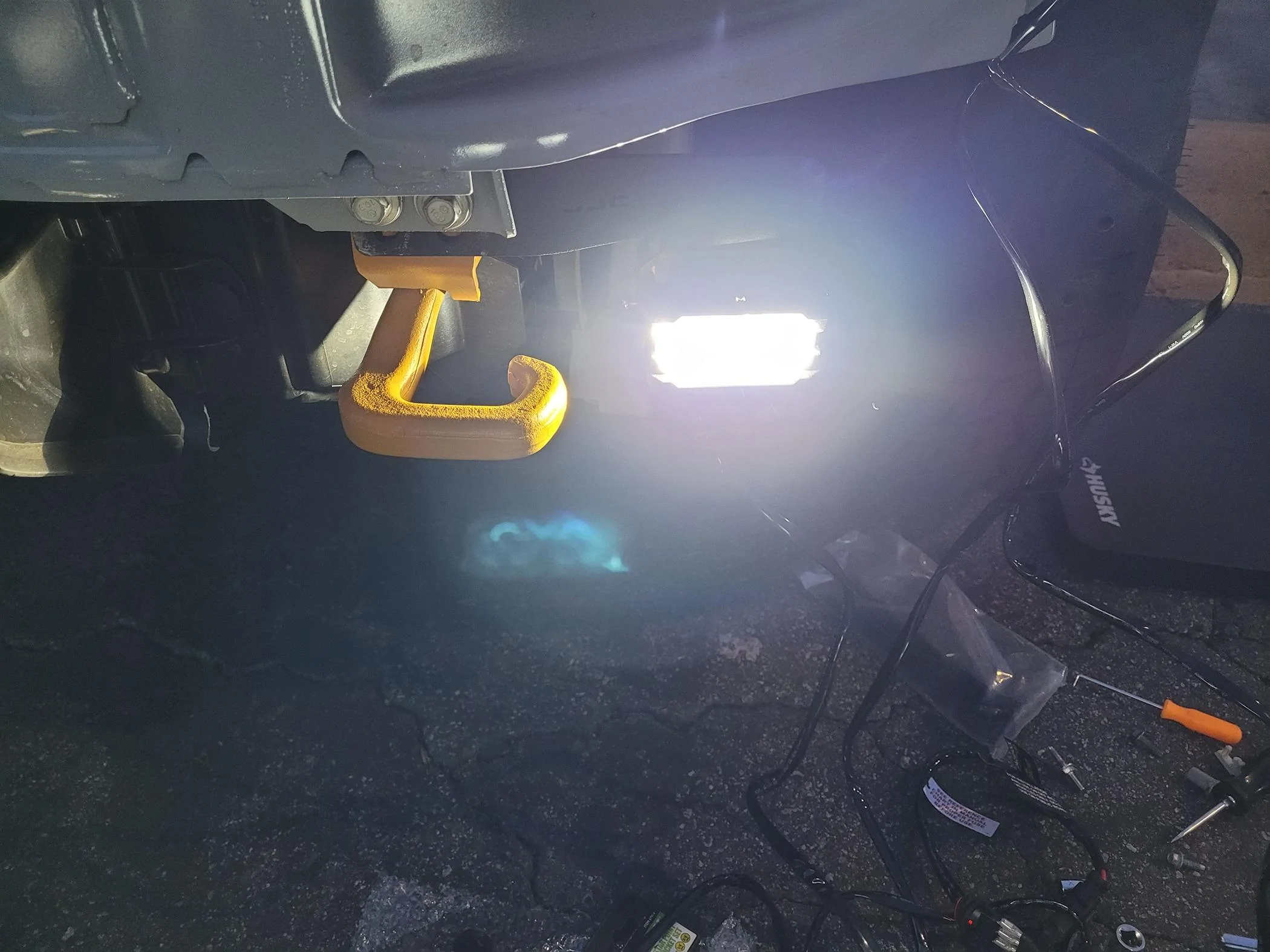

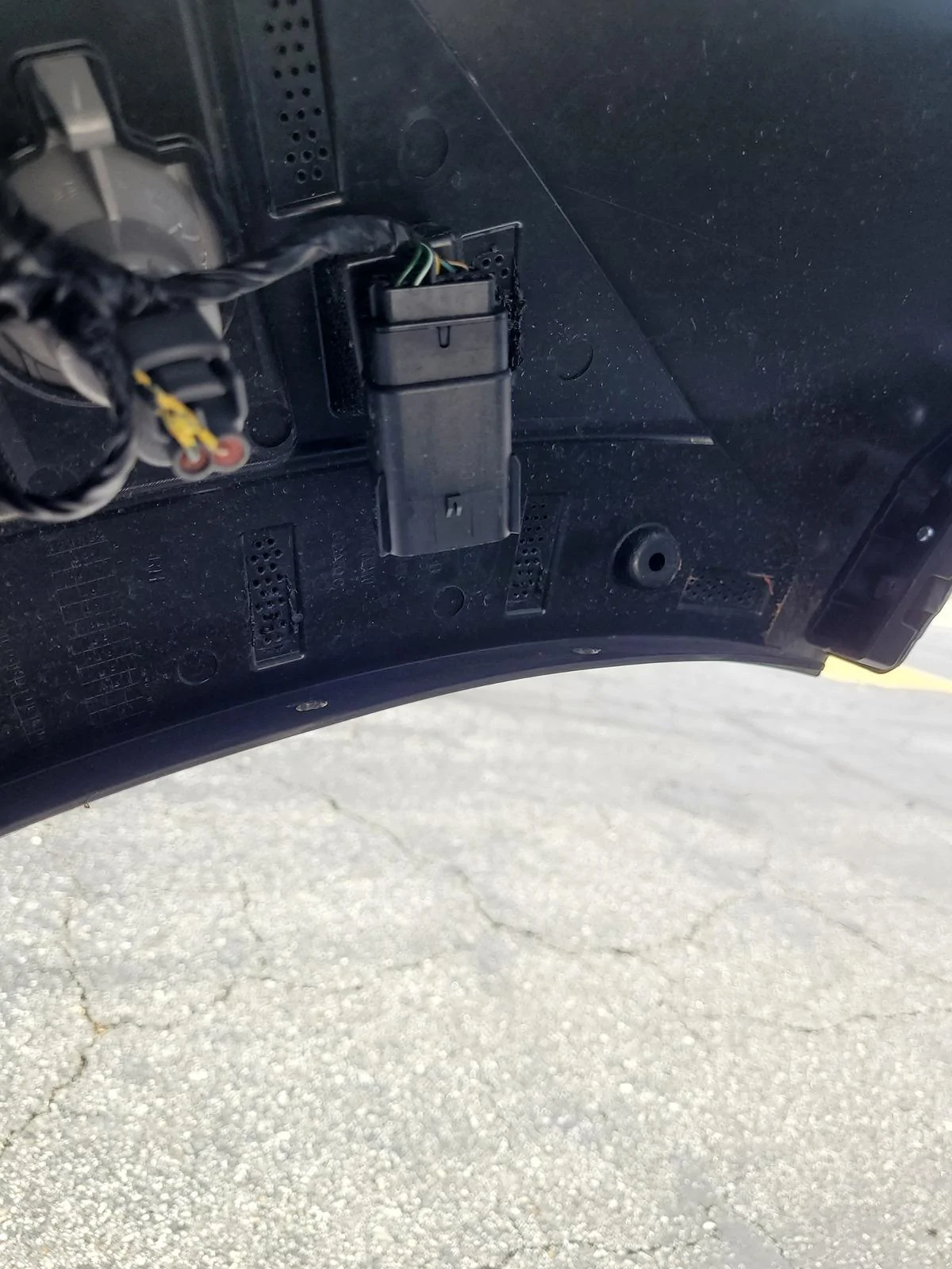

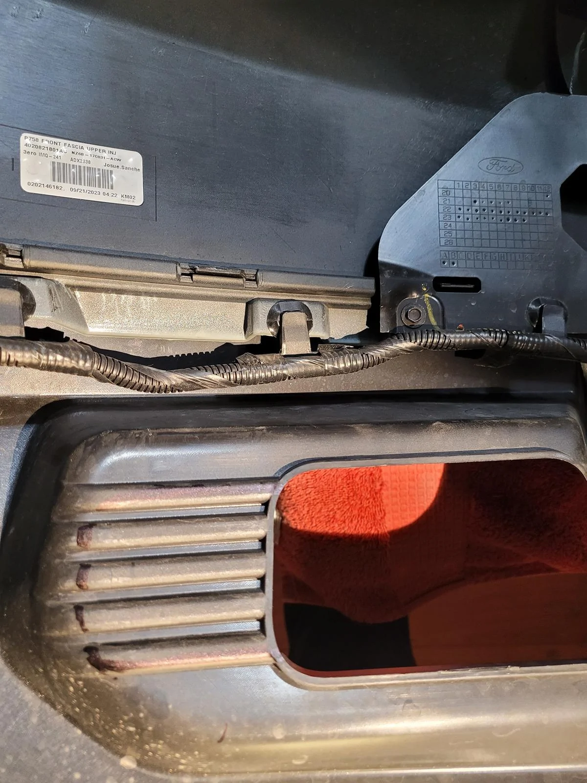

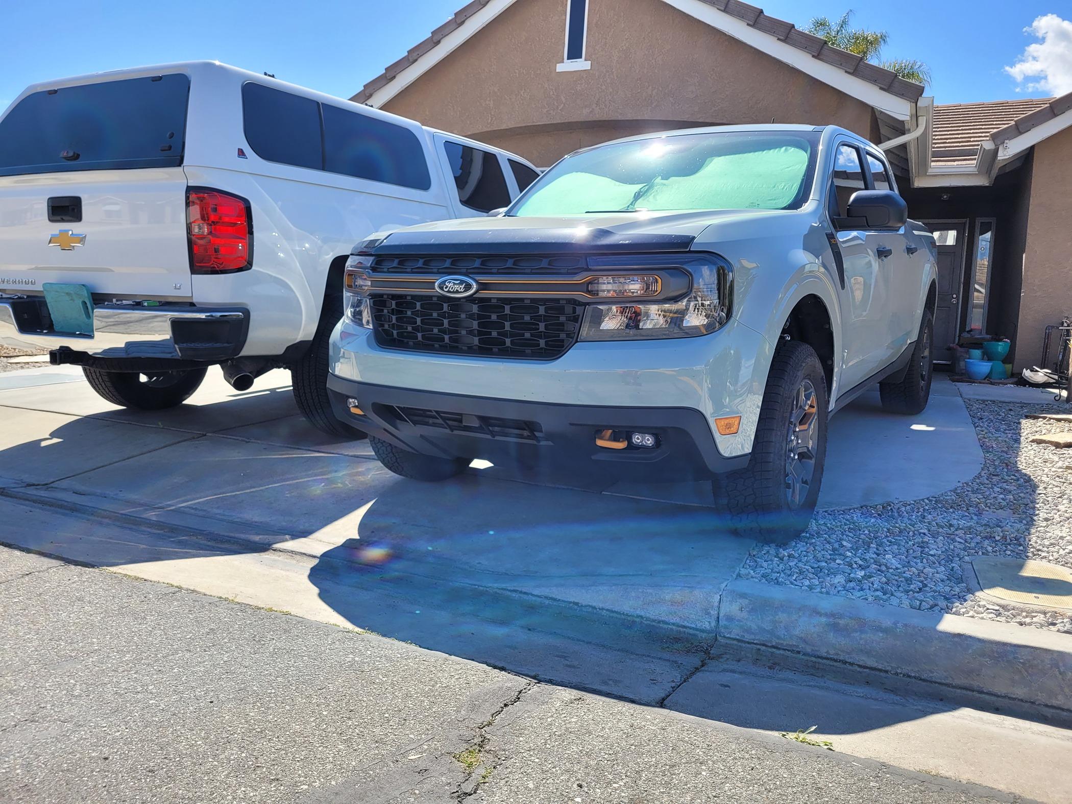

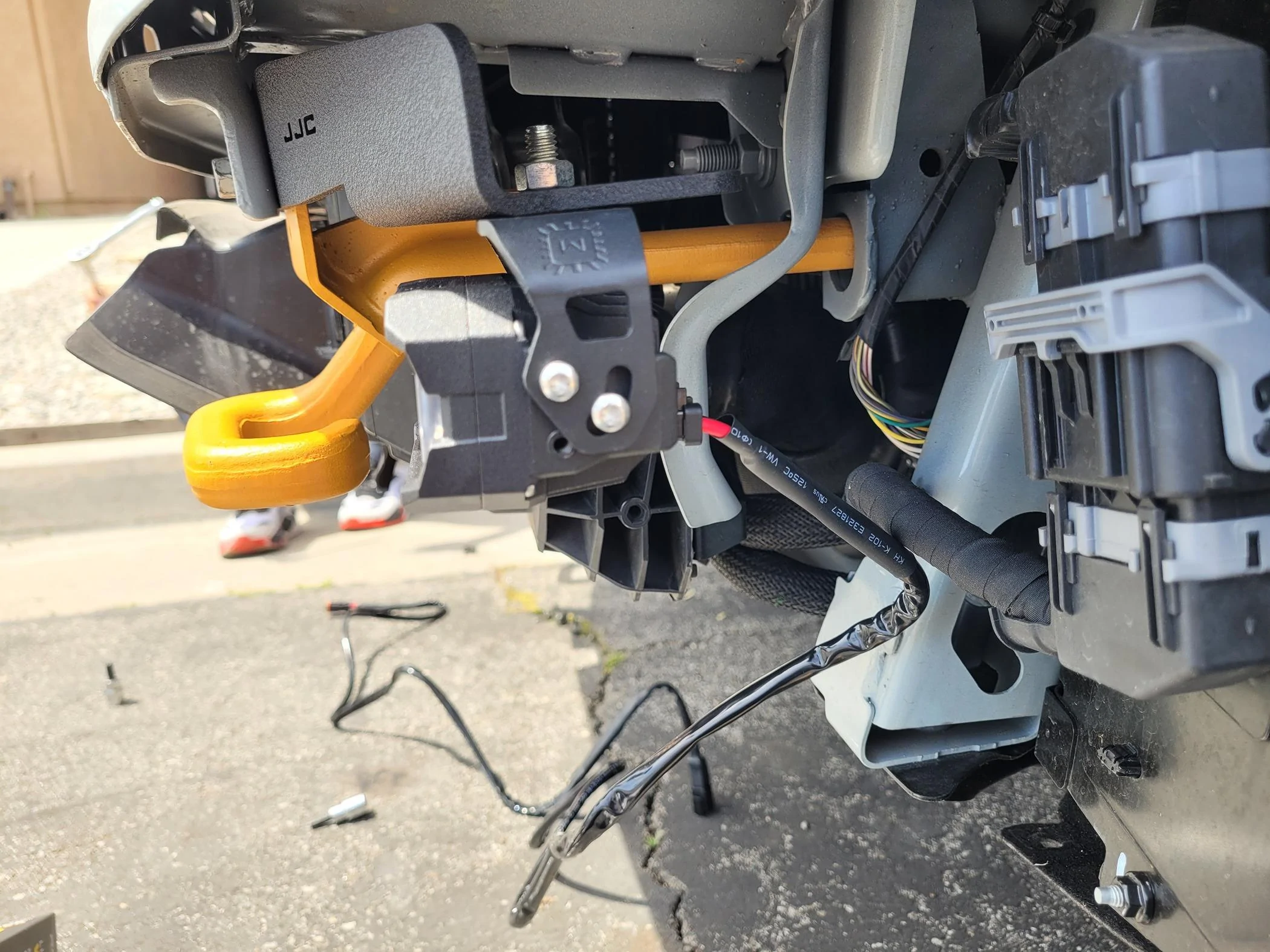

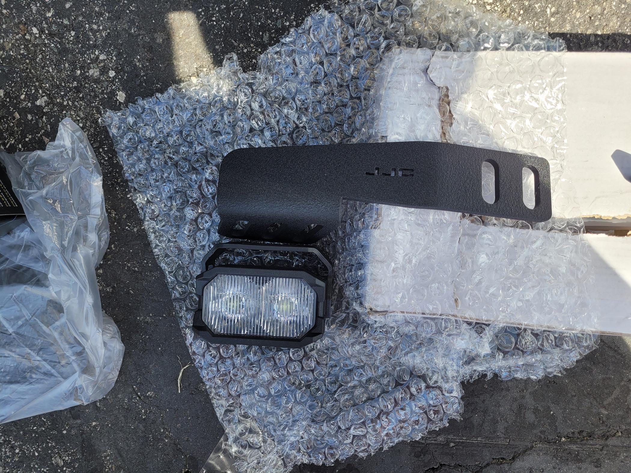

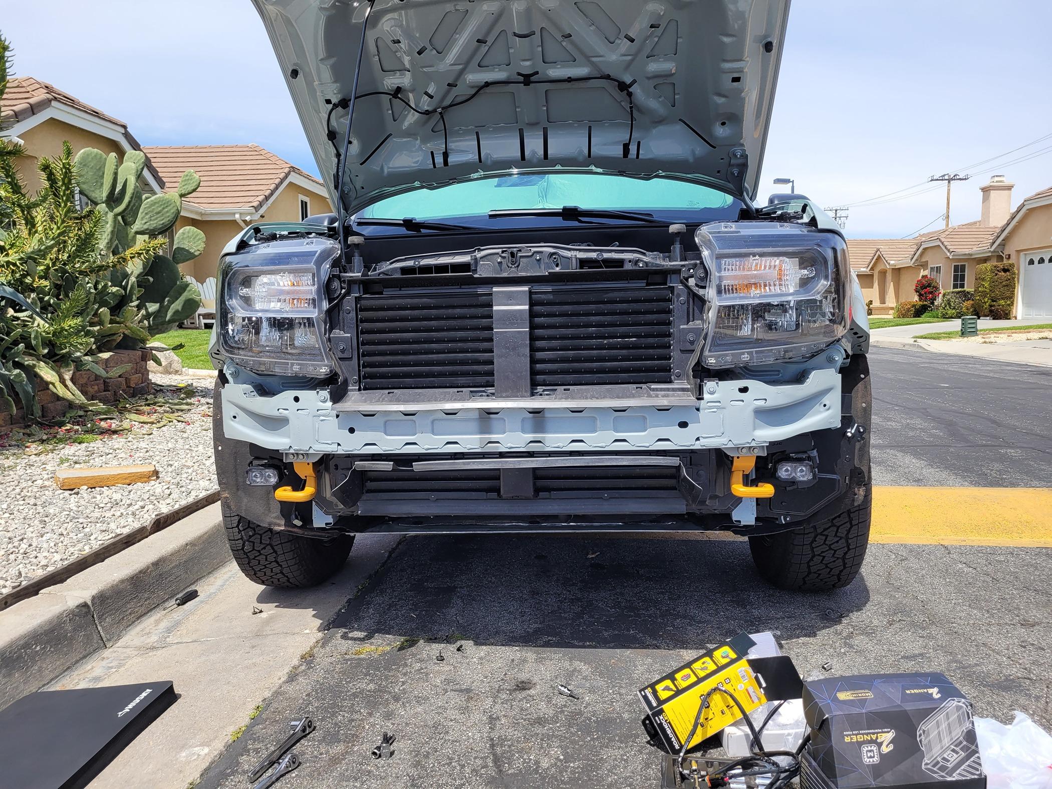

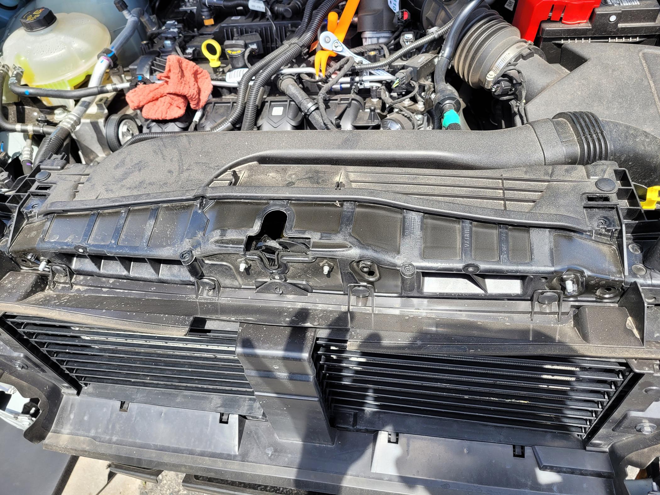

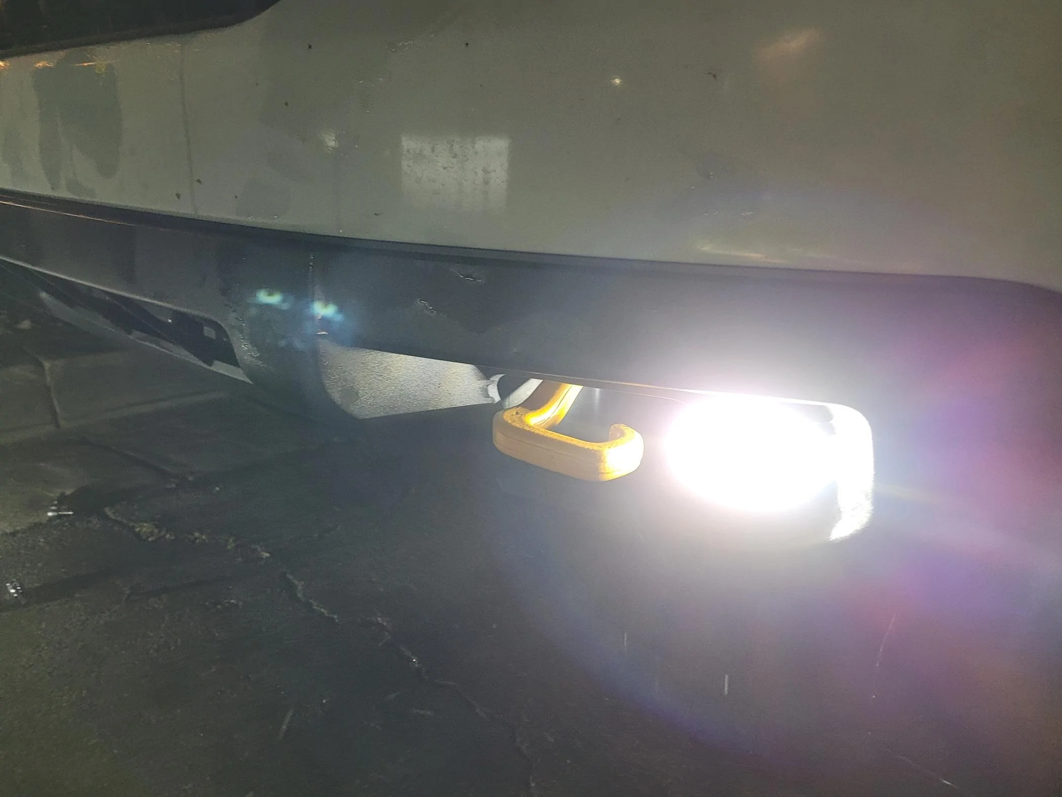

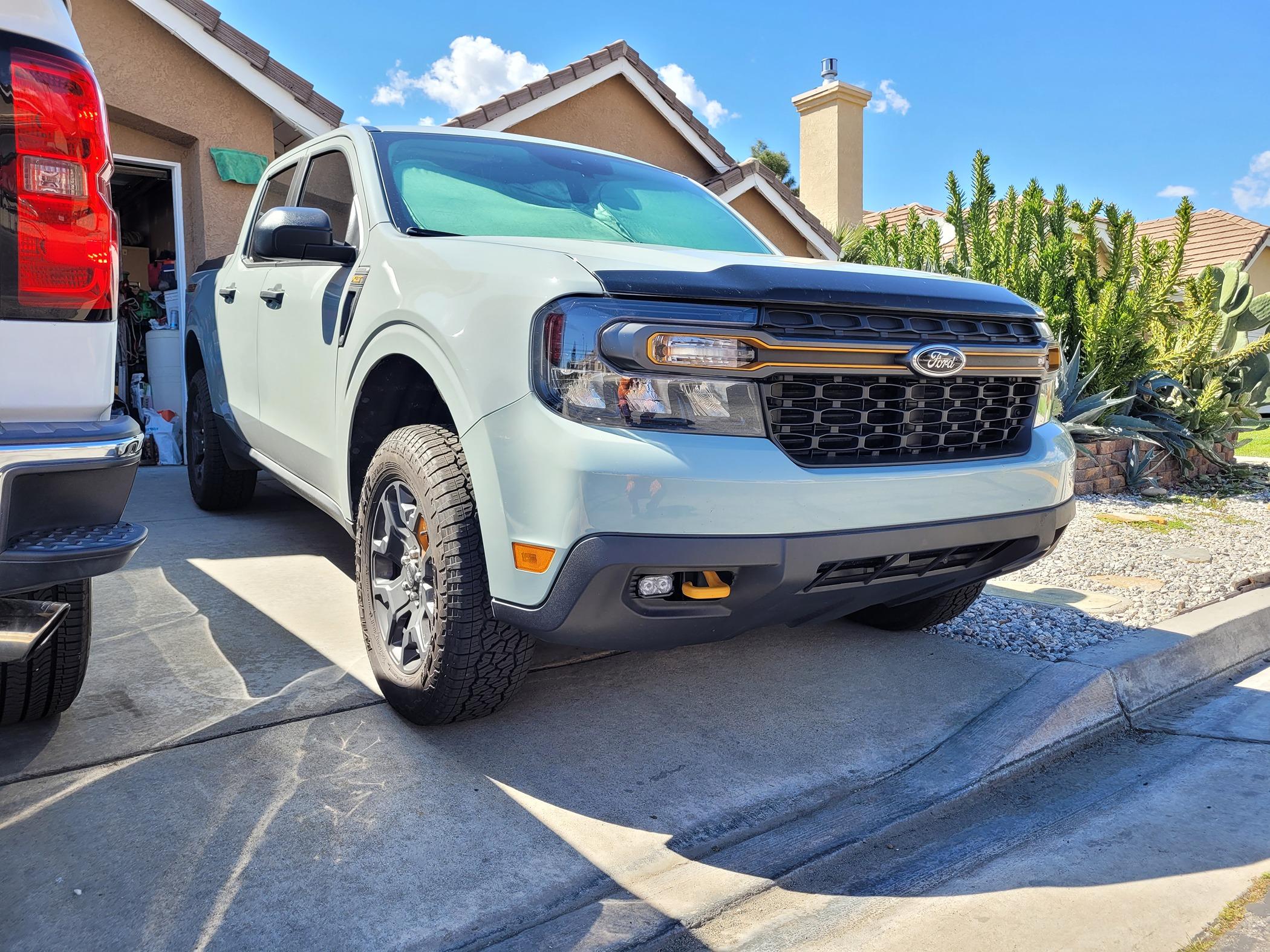

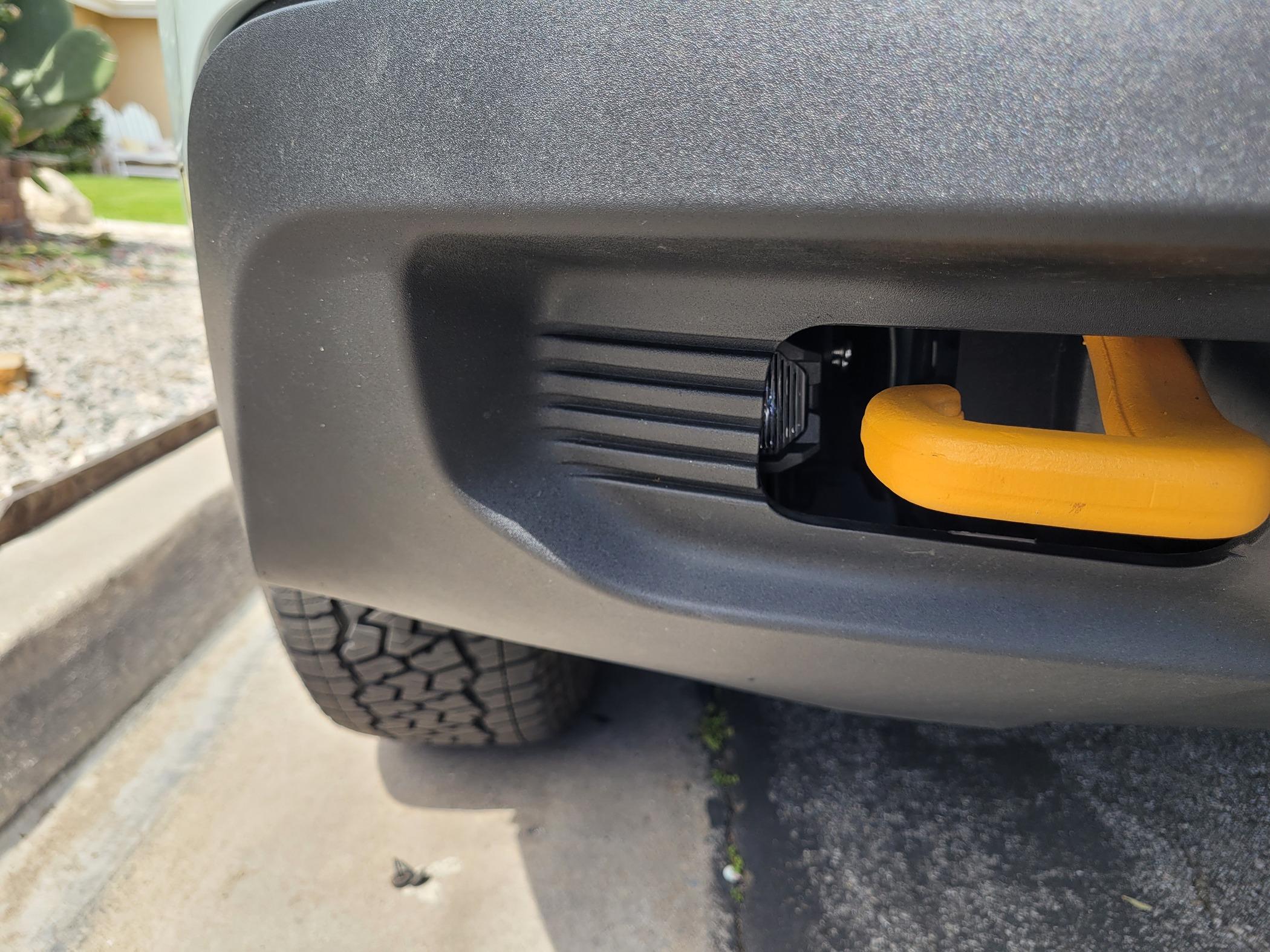

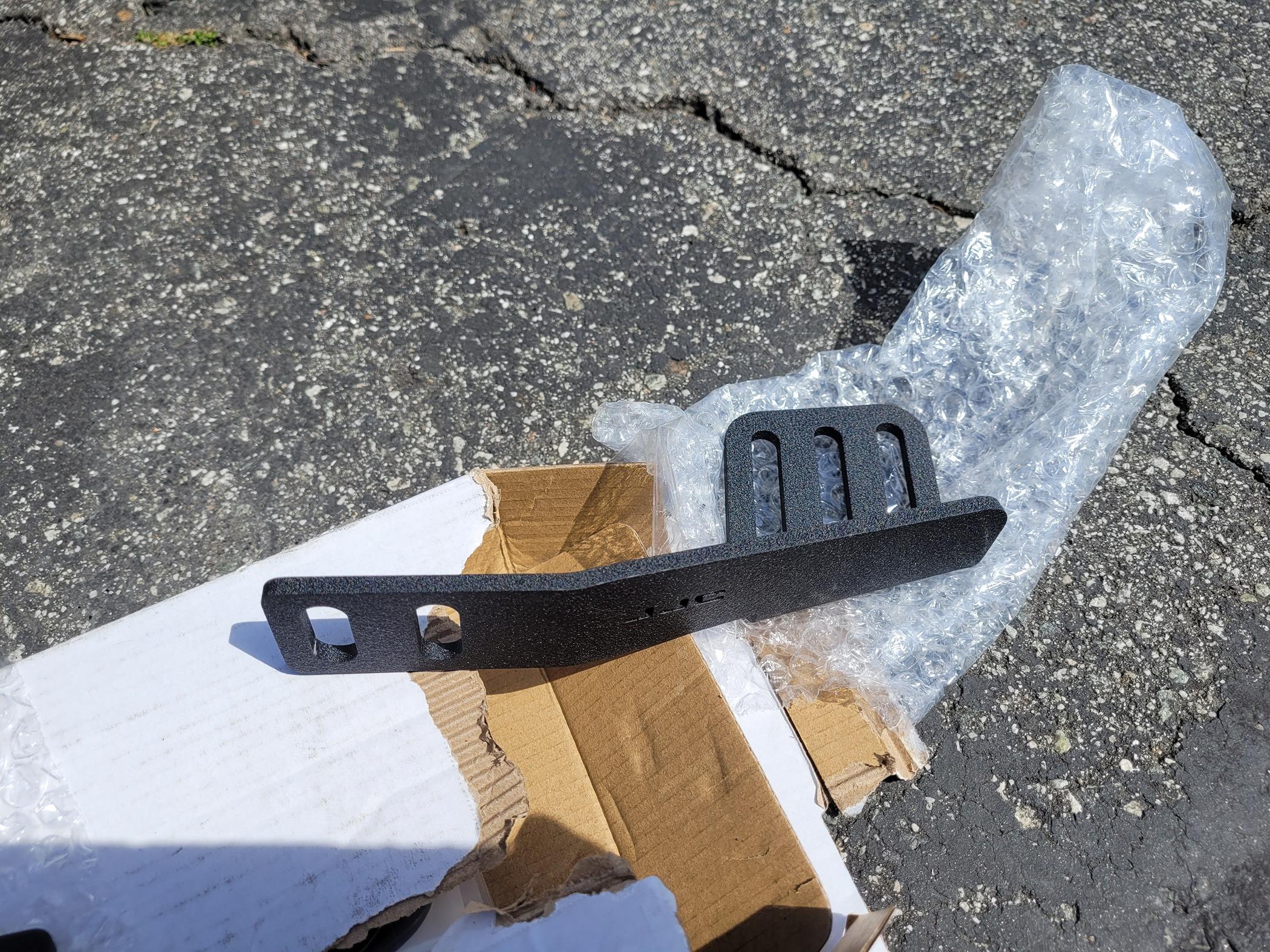

I just installed Morimoto 2Bangers WIDE beam HXB's on my Tremor using JJC-LLC.COM Brackets.
https://jjc-llc.com/products/2023-f...76590&pr_ref_pid=6943258542126&pr_seq=uniform
https://www.morimotohid.com/2Banger-LED-Pods-HXB-Wide-Beam?quantity=1
I have few phases of instruction and photos and more to come.
The install is 4 out of 5 wrenches 🔧. It's not a fast one but well worth it. There wasn't a pre-cut pattern to sketch out the lights, so I had to do some drawing on the inside of the bumper before cutting.
I did pre-fit the lights on the truck before tracing the 2banger lights on the inside of my bumper. I like the JJC-LLC.COM brackets because they have a lot of adjustment that allow for proper alignment and modifications.

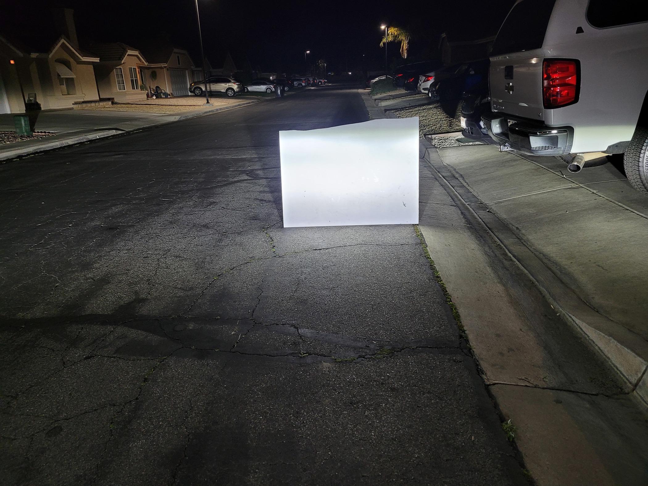

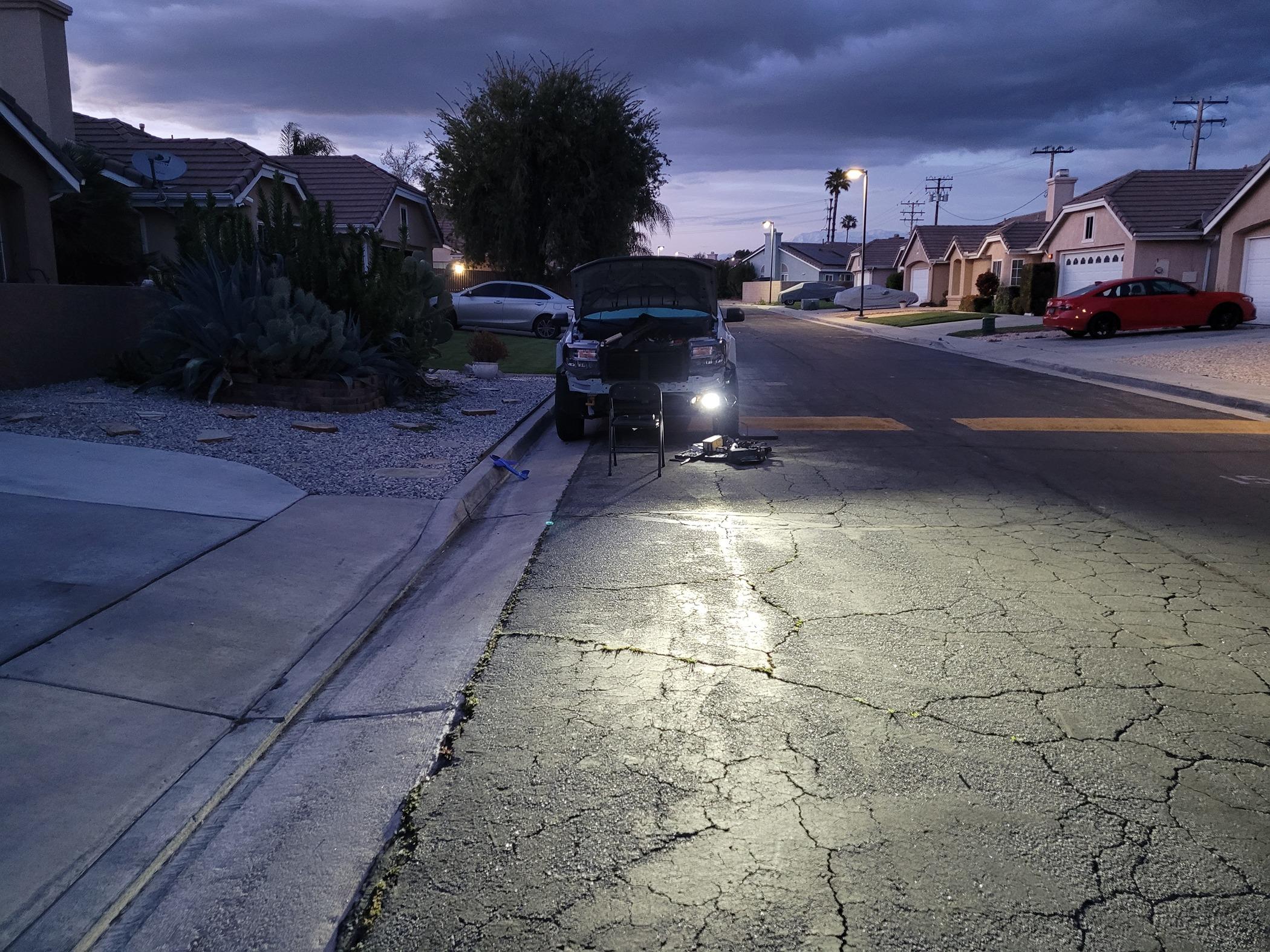

The Morimoto 2Bangers WIDE beam HXB's have a great pattern for foglights there are SAE certified and I'm glad I went with the HXB's. These lights are incredible. I installed the Diode Dynamics foglight kit on my Hybrid and they looked great off and were good when turned on or in park light mode, but these 2banger lights are amazing 👏🏽 when Illuminated.
The Diode Dynamics kit is designed for an easy and quick installation. This is a well thoughtout set of "Bracket's" that allows your imagination to run wild. You can use Diode Dynamics, Morimoto, Baja Designs, KC daylighters, or a no name internet special set of lights.
You will have to cut your bumper. You will need to remove your bumper. There are clips and screws in the fender wells, skid plate, and on the top of the grille that need to be removed to take off the bumper. There is a little trick you have to do with two clips that are on the grille assembly. You will have to push the two clips that are on top of your radiator to have the grille release. There are also a set of special clips on the bumper that go into the fender. The clip has tabs on both sides that need to be pushed in to allow the bumper to come off.
The is no cover piece that comes with the Brackets alone. JJC-LLC.COM has a few options to choose from and if you get a kit with lights from Justin you can get a template and facia cover plates.
JJC-LLC.COM has kits for Hybrids, Regular FWD Ecoboosts and AWDs, as well as for FX4s. Justin also has nefty grille light kits and ditch light kits, and even just ditch light Brackets (which are next on the list).
I attached photos and more photos will come tomorrow.
Booyah 👊🏽 😁 👍🏽 🇺🇸.
Thank You Justin from JJC-LLC.COM
