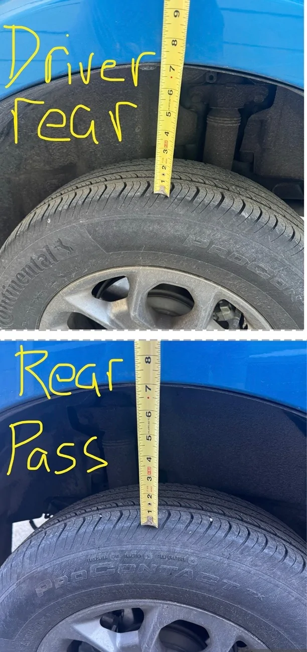

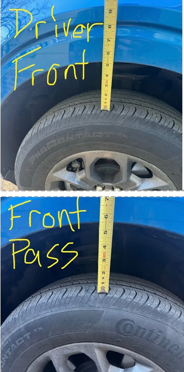

My truck is pretty level from left to right, with the front gaps at 5.5" and the rear gaps at 6.75"

Springs settle. Also you can bounce it up and down a few times and get a different measurement.

Perfectly normal. Nothing is perfect in life. There are manufacturing variations and actual weight differences of the truck load, uneven ground, and spring rebound differences. Any mechanic is going to tell you this is normal with steel springs.
If you want perfection for your truck, use adjustable coilovers to fine turn ride height.

Unless you measure height from the chassis components your measurements are meaningless.
one fender may be lower one may be higher. All within specs.
Put it on a frame machine… then you will have accurate measurement.
