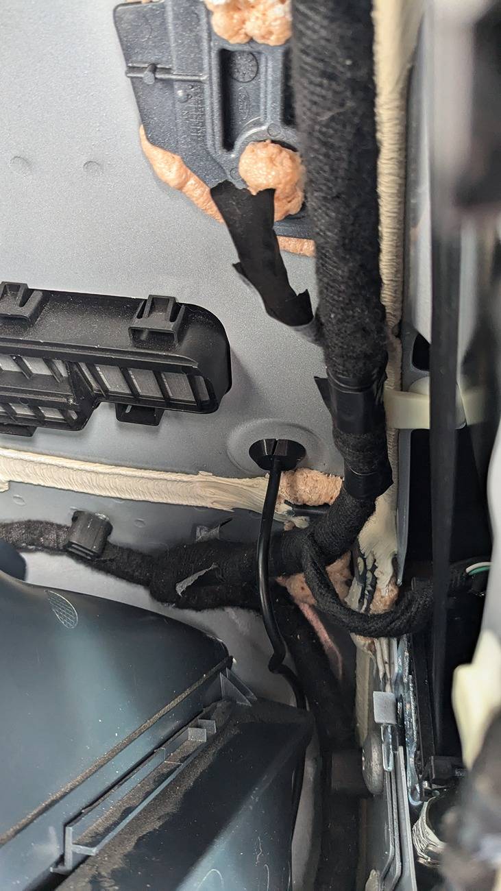

Ford Maverick Interior switch for bed 12v wiring? PXL_20250207_210435724
Pic 1: Behind door trim of the left side passenger door, there's a grommet leading to the bed.

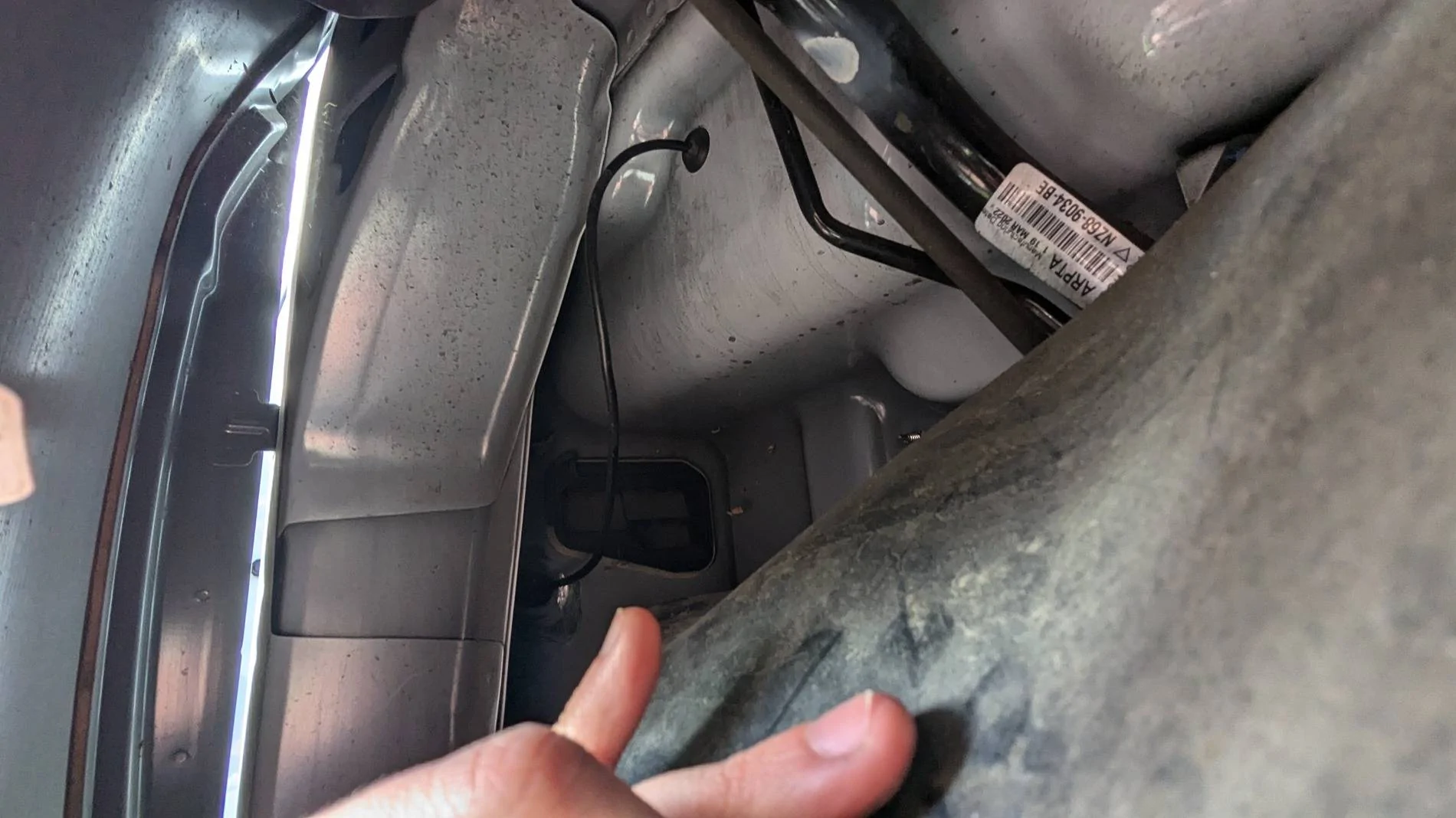

Ford Maverick Interior switch for bed 12v wiring? PXL_20250207_210534641
Pic 2: After removing the clips for the left rear tire well, you can bend the plastic and see where the grommet from the back of the cab is leading up to the front left grommet in the truck bed. Note, directly above where this photo was taken are the plastic clips for the bed rail trim. You can pass the wire through one of those clips and run it along the underside of the bed rail trim.
