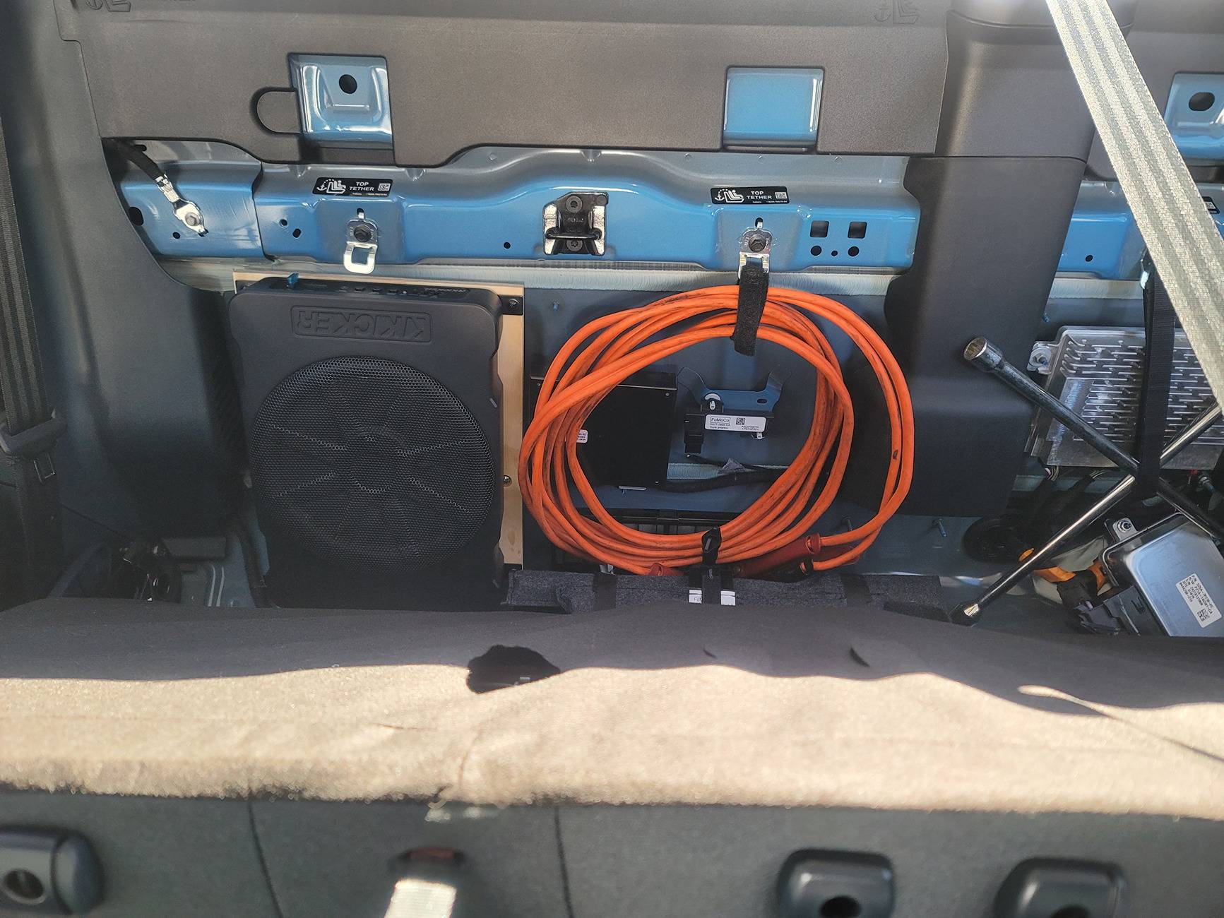

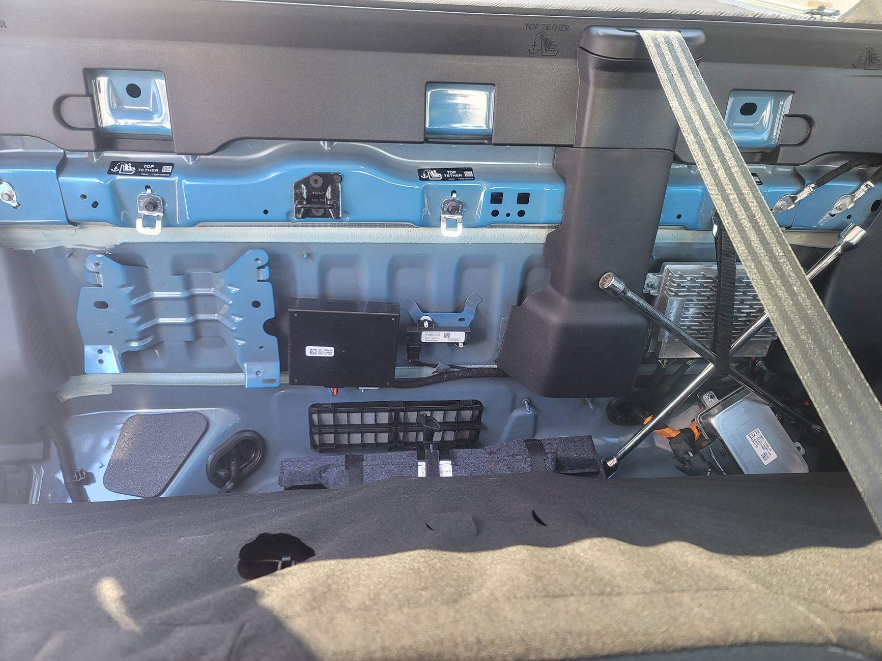

I think he means the Kicker 51HS8? I just put a Kicker HS10 in my 2025 Hybrid XLT w/ 4k tow and the lux package, and I had to orient it vertically because what I think is the tow break controller and the antenna controller were in the way (all the other pics I've seen in this forum folks do it horizontally). The HS10 is about the same size as the HS8 I believe, and I didn't have a lot of extra room.
You could scooch the control modules over a bit, but I don't think you could fit two behind the seats. Maybe if you don't have 4k tow you don't have to worry about the bigger control module? Maybe you could do one behind and one under the seats instead?
Ignore the jumper cables, I just like to keep my emergency stuff back there.
