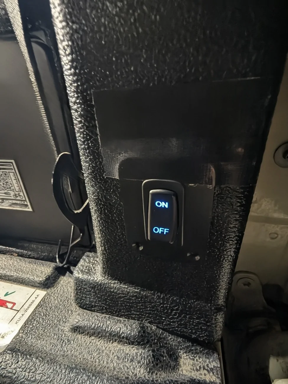

I’m looking for a location to mount a switch and considered using that same spot as you did, my one concern is snagging it when loading or removing something from the bed.
I had the same concern and mounted a surface mount switch up under my tonneau rails. This is the one I used: https://www.amazon.com/dp/B08YJ5VH4B
You'll want a smooth surface to mount it to. I used the top surface of my custom strut-channel rails.

The Pigtail cover is behind the "drop in" bedliner, which also is where i wanted to install the rocker switch for the LED's. So i had to cut into the bedliner to access all that.
Some dealerships take the extra steps of punching out the bedliner in the needed places, mine unfortunately did not.

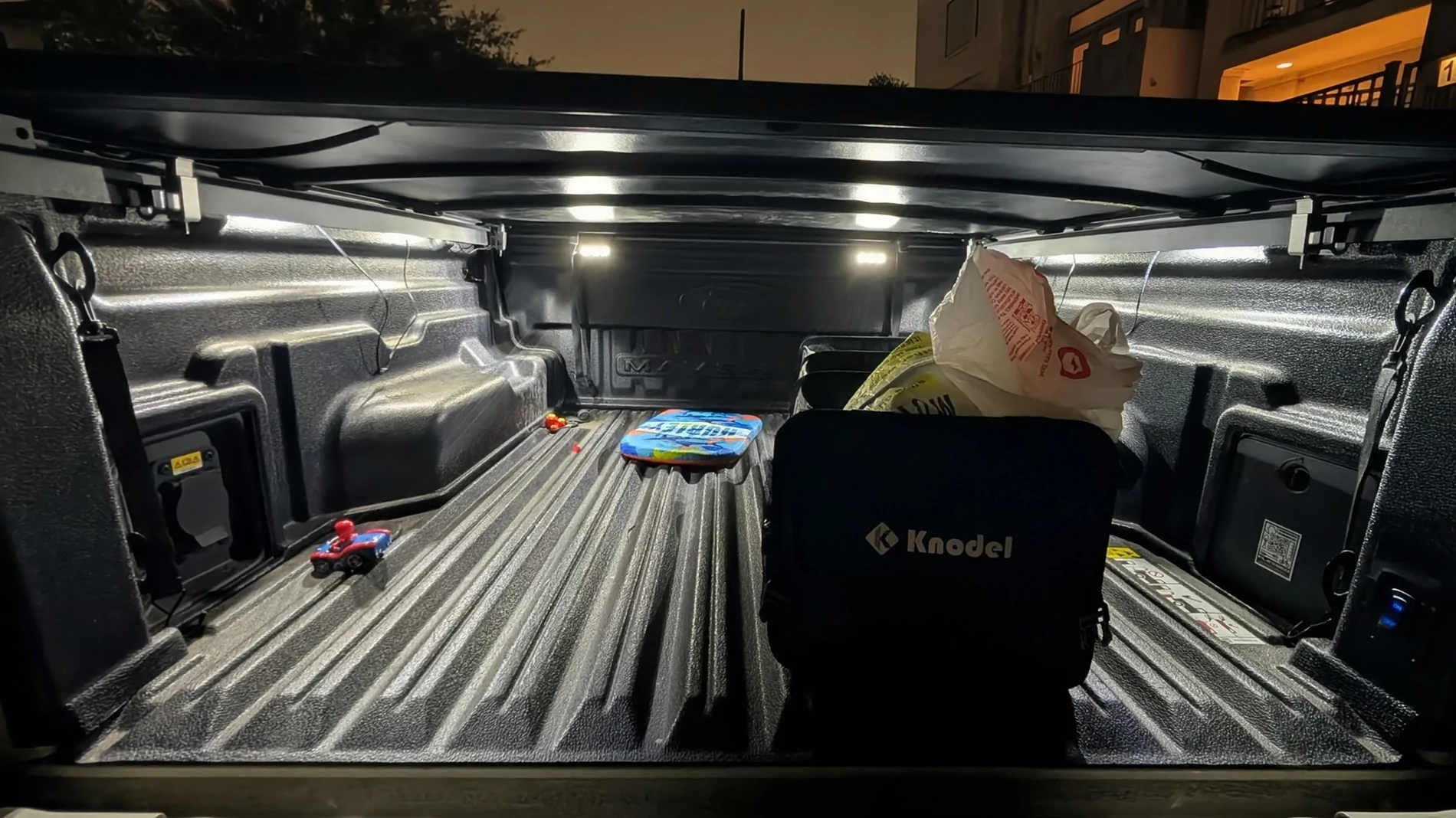

Here is my Version...
The Switch is really good quality, the illumination on "On" & "Off" is a plus when its really dark.
I opted for those Lights because they are easier to install and i spaced them between the gromets that hold the bed frame trim. Did not bother with the switches that came with it.
I still wish the power was always on instead of Ignition on though!
