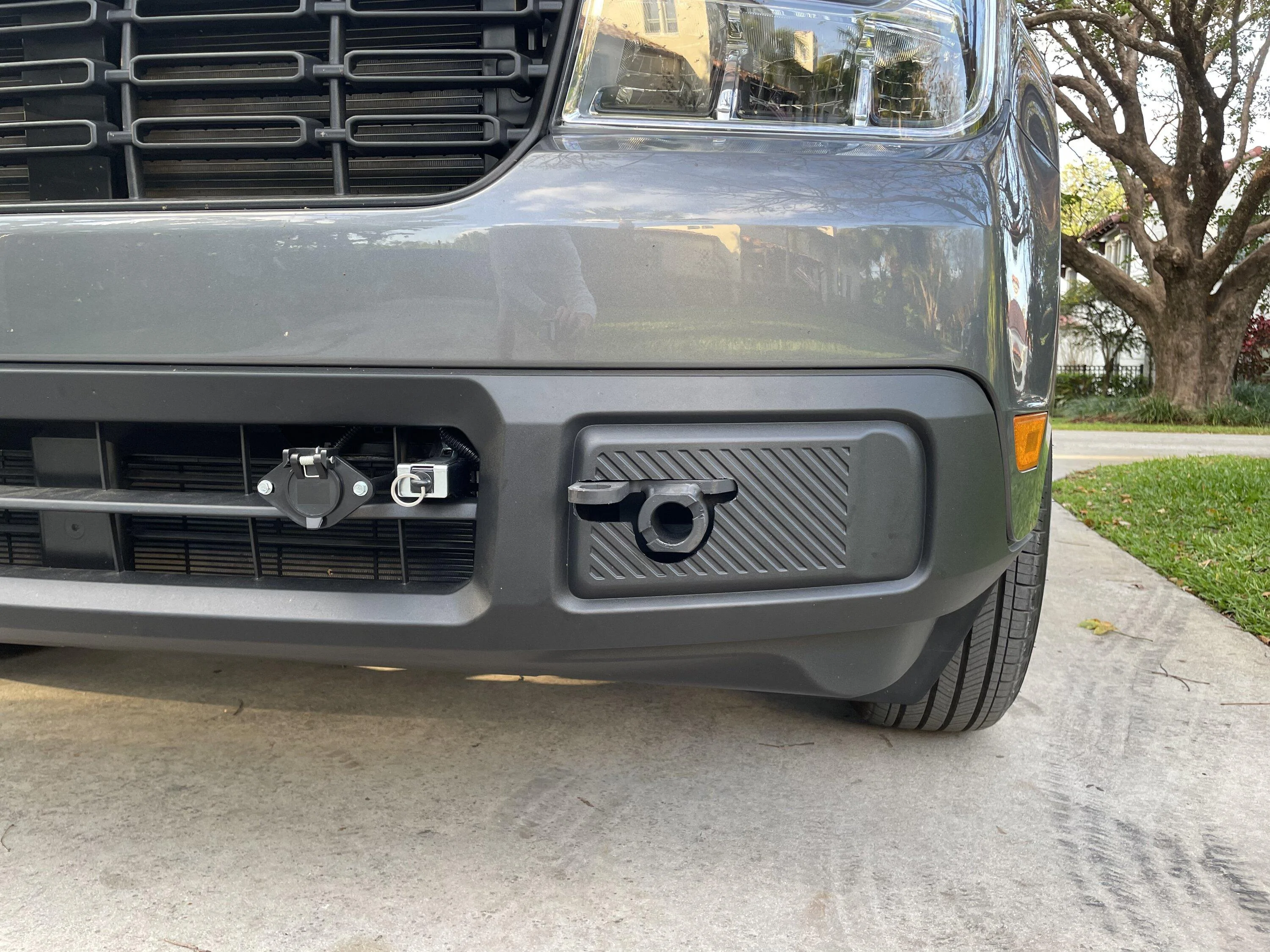

Hey, Sorry if i missed this in the thread, but if i wanted to add this to my awd xl (the bumper not the tow kit setup), it should just be a swap out with no issues in sizing or anything? I have truck ideas iin my head floating around, and this could help one. LOL

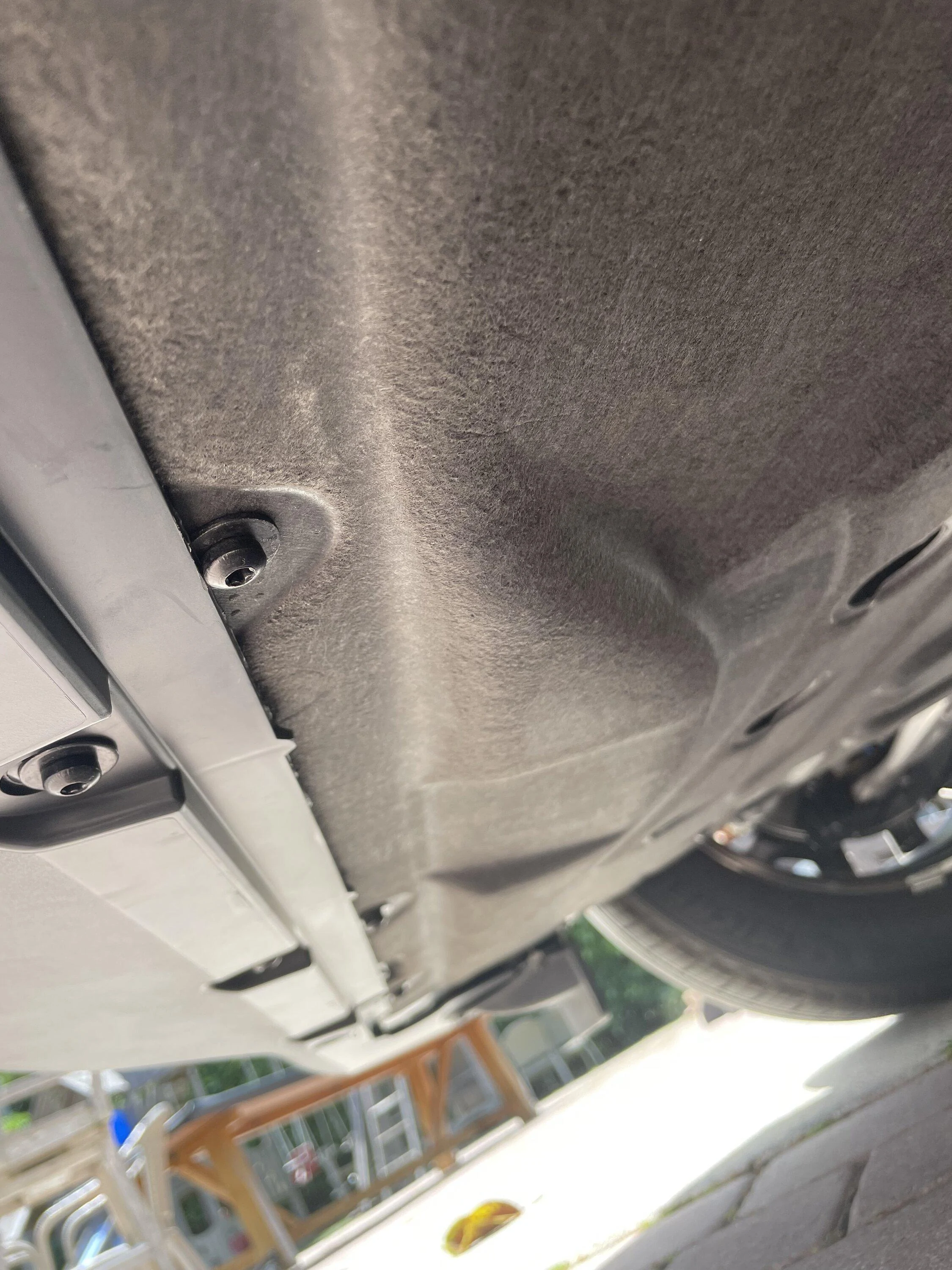

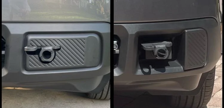

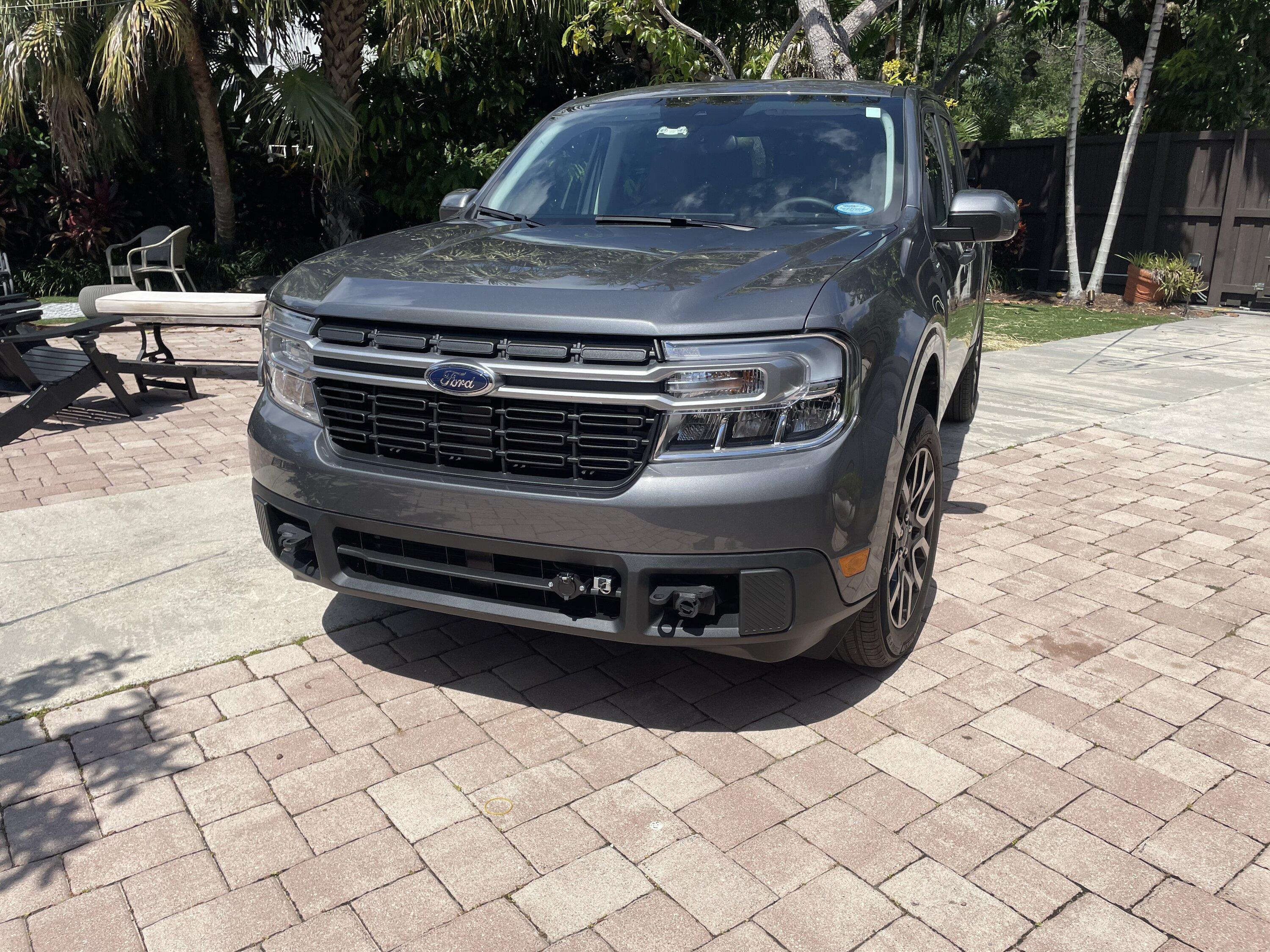

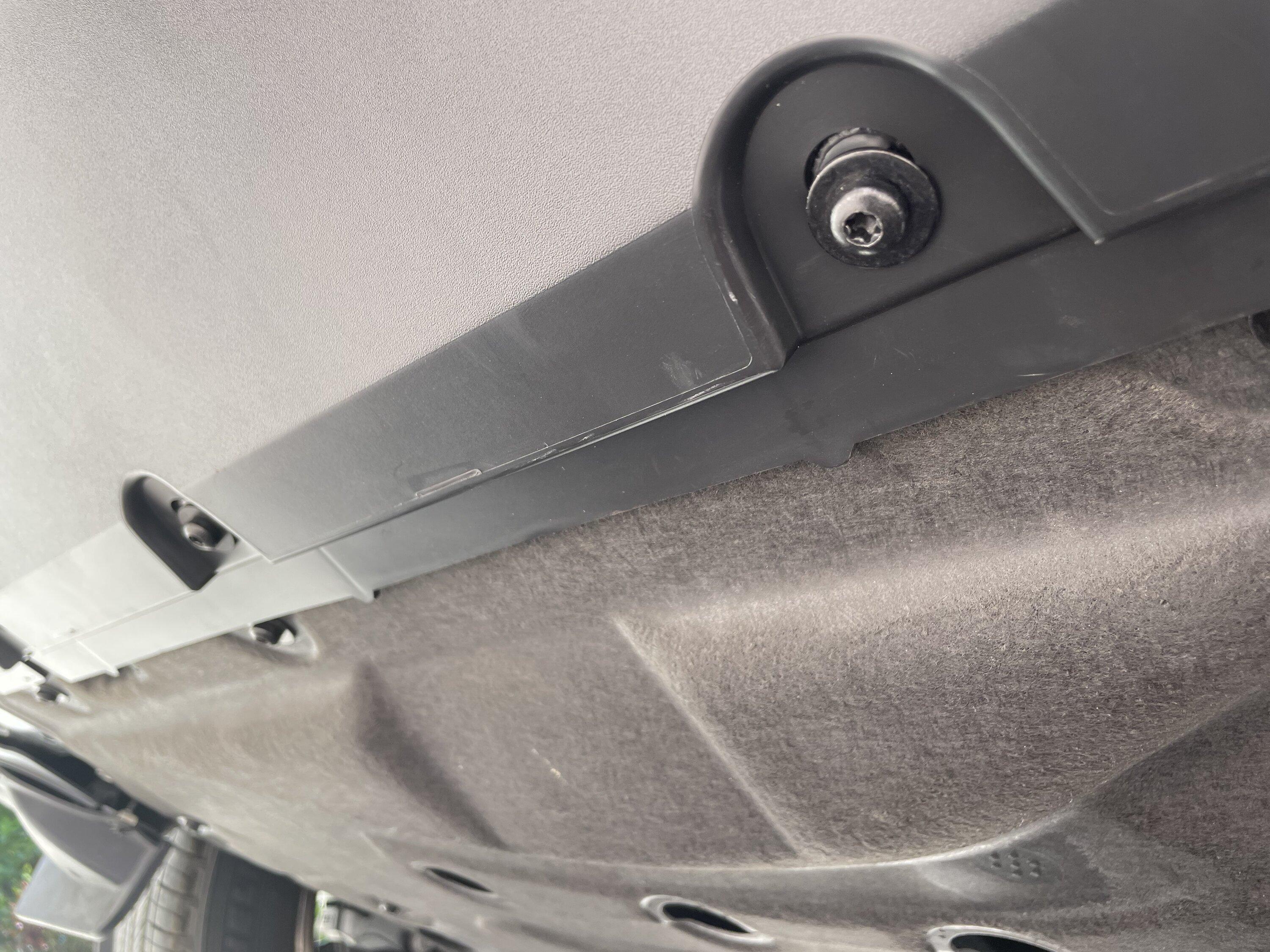

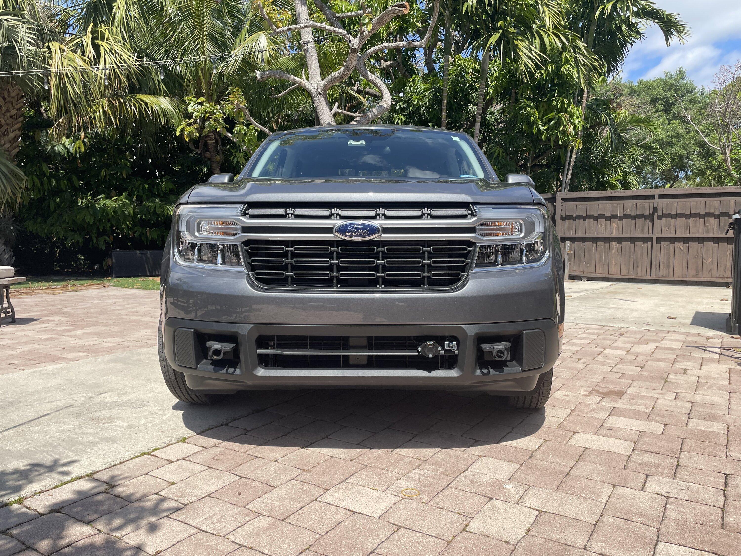

We had to add trim as the FX4 fascia is shorter and doesn’t line up with the under tray on the Lariat. Easy fix with patience and taking required material from original fascia.

Hi. Im thinking to do the same swap for my 2023 Lariat fir the space to add fog ligths. Any issue with the oil change at the time to remove the under cover?

Hopefully, you are not considering a Blue Ox baseplate...just a change of lower fascia. Be aware that it willnot match the exiating underpanel and you will have some modification to make to fill in the gap from the original lower fascia and the fx4 lower fascia. They are not simply a swap.

Im looking to install the fogligth without having to cut the fascia. Thanks you.
