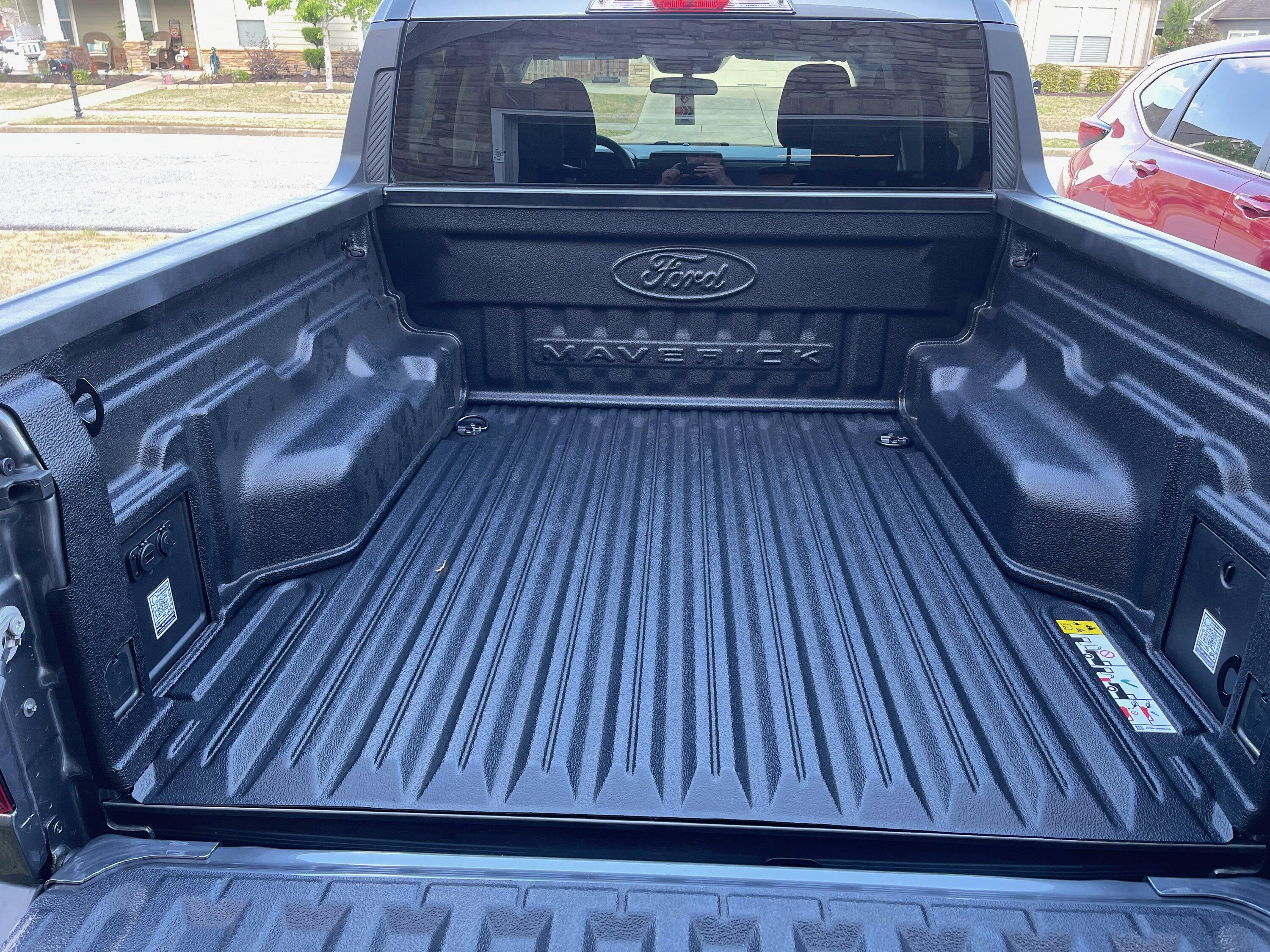

Hi all. I finally got around to putting in the Ford DIBL. Overall, not too terribly hard and I'm overall satisfied with it. I did have a couple issues: 1) the hardware kit was missing one screw and washer and 2) the adhesion promoter was not in the kit either.
As many know, the cutouts on the side pieces need to be done by the customer. I first tried an oscillating tool but found it hard to control and cut straight. I then tried a rotary tool (like a Dremel) with a cutoff wheel and that worked best for me. Also, all of the tie done anchors have what looks like red threadlocker. The D-rings on the bed were the hardest to remove and reinsert. It almost felt like I was cress-threading.

Great job and looks like it was factory installed.

Bang up job dude. Looks good!

Great job! I have it from the factory. Of course they didn't cut out the 12v taps on either side. I have a BedRug &/or Husky mat on top of mine. Your knees will thank you.

Thanks! Yes! My knees were NOT happy when I reinstalled all the cargo hooks.

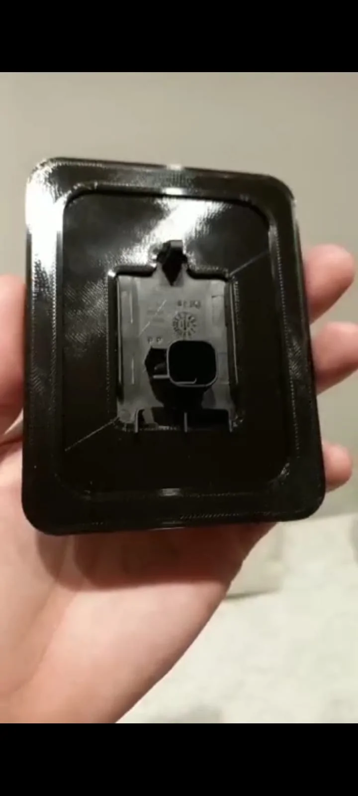

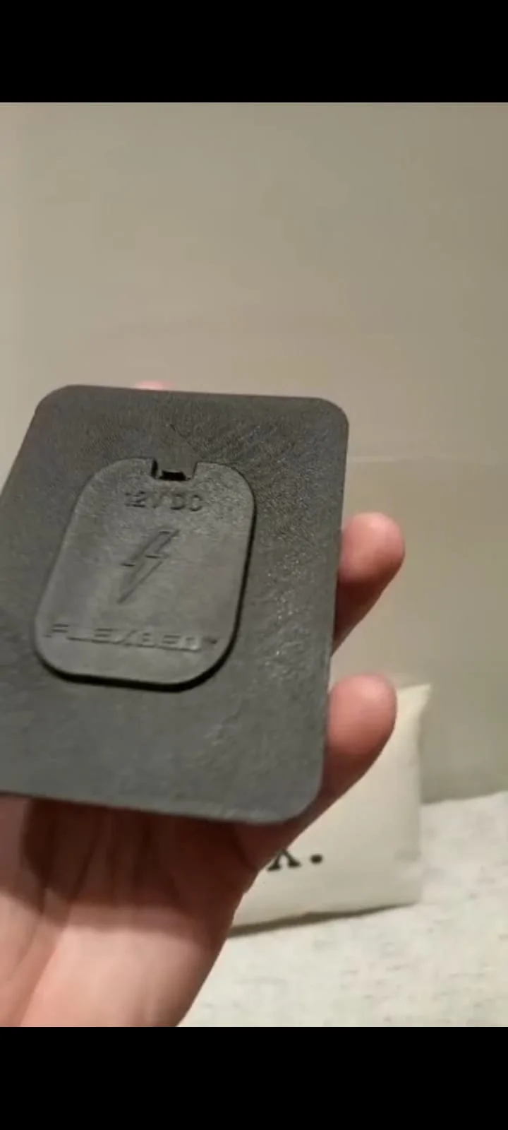

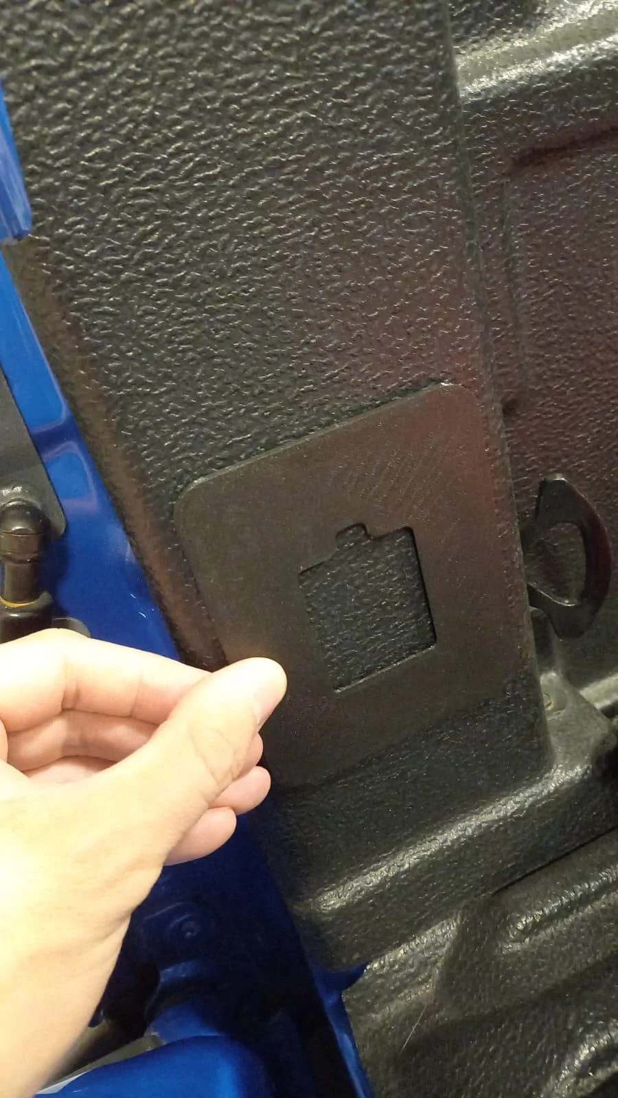

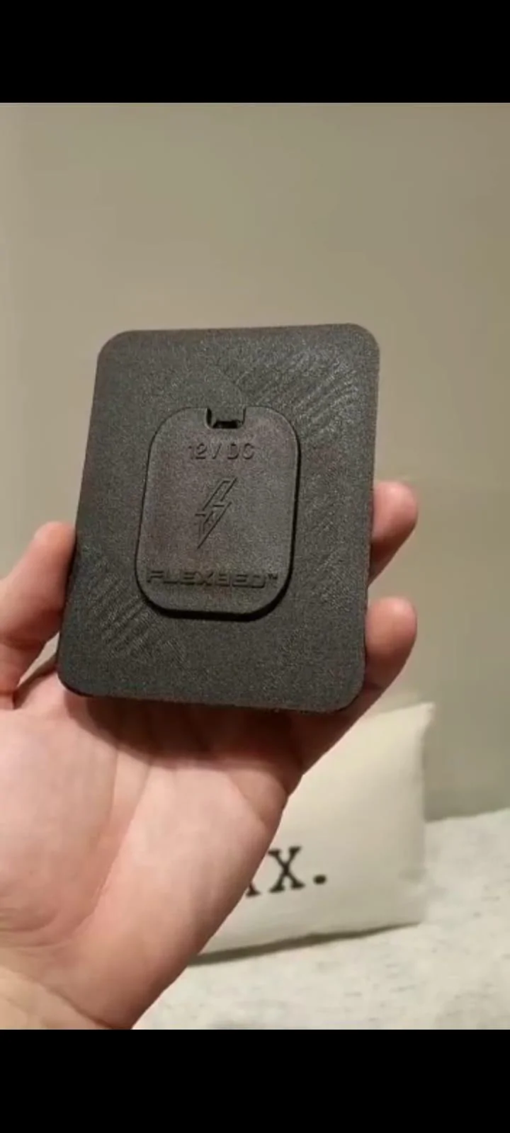

The other day a friend of mine cut his bed liner to reach the 12v outlet, unfortunately he did not do a neat job. So he asked me for help, I designed a specific part for that zone. In your case, you did a great job cutting the bed liner, but if you are interested in this humble design may help you to even look better.
https://www.thingiverse.com/thing:5933967
I will make a specific thread for this topic, just in case.
Have a great Day.

wow…that’s awesome! It just so happens that I got a 3D printera few weeks ago and haven’t really done much with it. I’ve got some PETG. Will that be good or do I need ABS?
nicobonis
Nicolás
Oct 1, 2022
107
115
Banfield - Buenos Aires - Argentina
Ford Maverick Tremor 2025
PETG Will be great, because it can handle UV rays Better than other plastics. Just remember to glue it right or add some screws.
