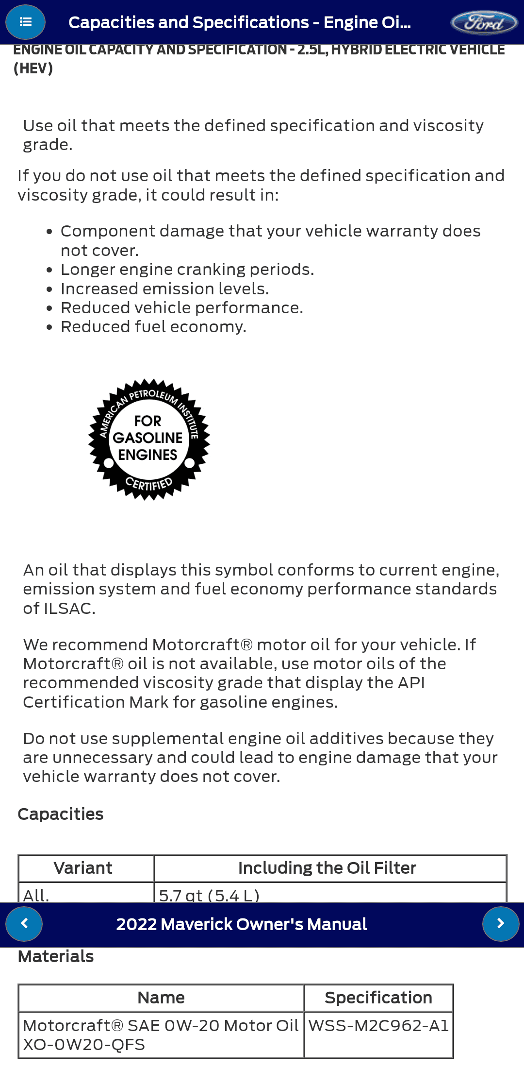

Yes. The manual specifies this. I'd get it redone on their dime.
Ford Maverick Initial oil change and tire balancing Screenshot_20230825-190215

Was it 0w20? Was it Motorcraft? Because Motorcraft no longer sells a 0w20 synthetic blend, only full synthetic.

i honestly dont know if it was motorcraft 0w20 full synthetic or a synthetic blend or not, i was told that it was a synthetic blend.
i have been getting mine and all my families Ford vehicles serviced at this dealership for many yrs now and didnt question my service advisers advice as to which oil & filter that he said was recommended for my hybrid. im pretty sure it was 0w20 oil that was used.
i dont want o go down the 'rabbit hole' here but if regular oil changes are done will it really make that big a difference full vs blended synthetic as regards long term engine wear/performance? especially for hybrids? which one would think would have much less wear & tear since they are supplemented by the electric drive motor as opposed to a ICE engine that runs all the time?
