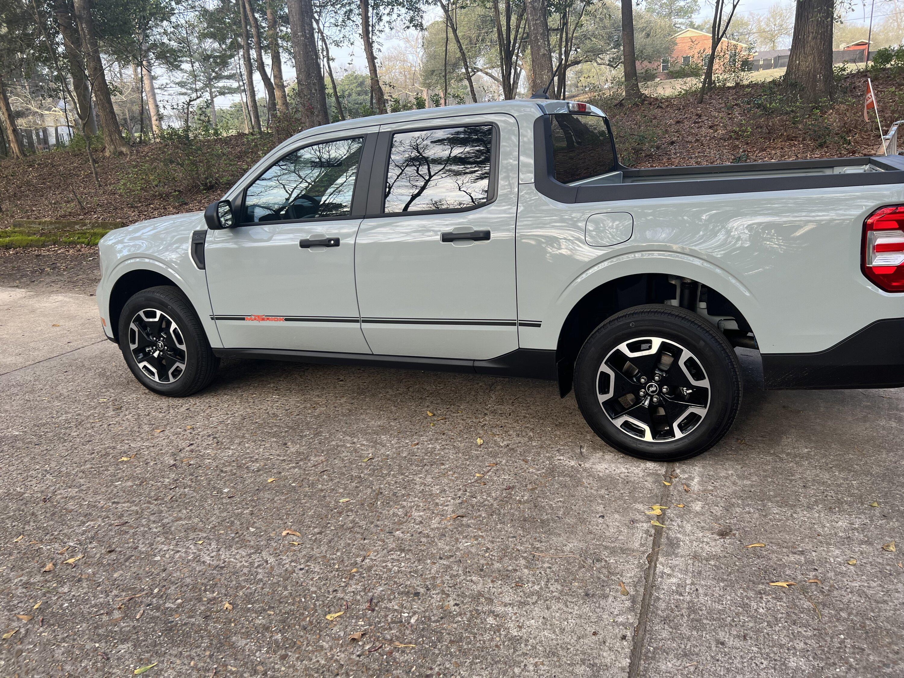

Impulse wheel buy…fair deal?

Maverick torque is 148 ft. lbs and Bronco Sport is 100. You don't want/need the beefier truck lug nuts? I'm sure it's covered here.
Bronco lug studs are 12mm. Maverick lug studs are 14mm, which can take a higher torque on the nuts. The lug nuts are not interchangeable. You can use the same wheels because the lug pattern is the same (5x108). Good Luck! 🤟

I’ll probably buy some new black lug nuts.

Good looking wheel/tire combo! ;)
Ford Maverick Impulse wheel buy…fair deal? IMG_5426
