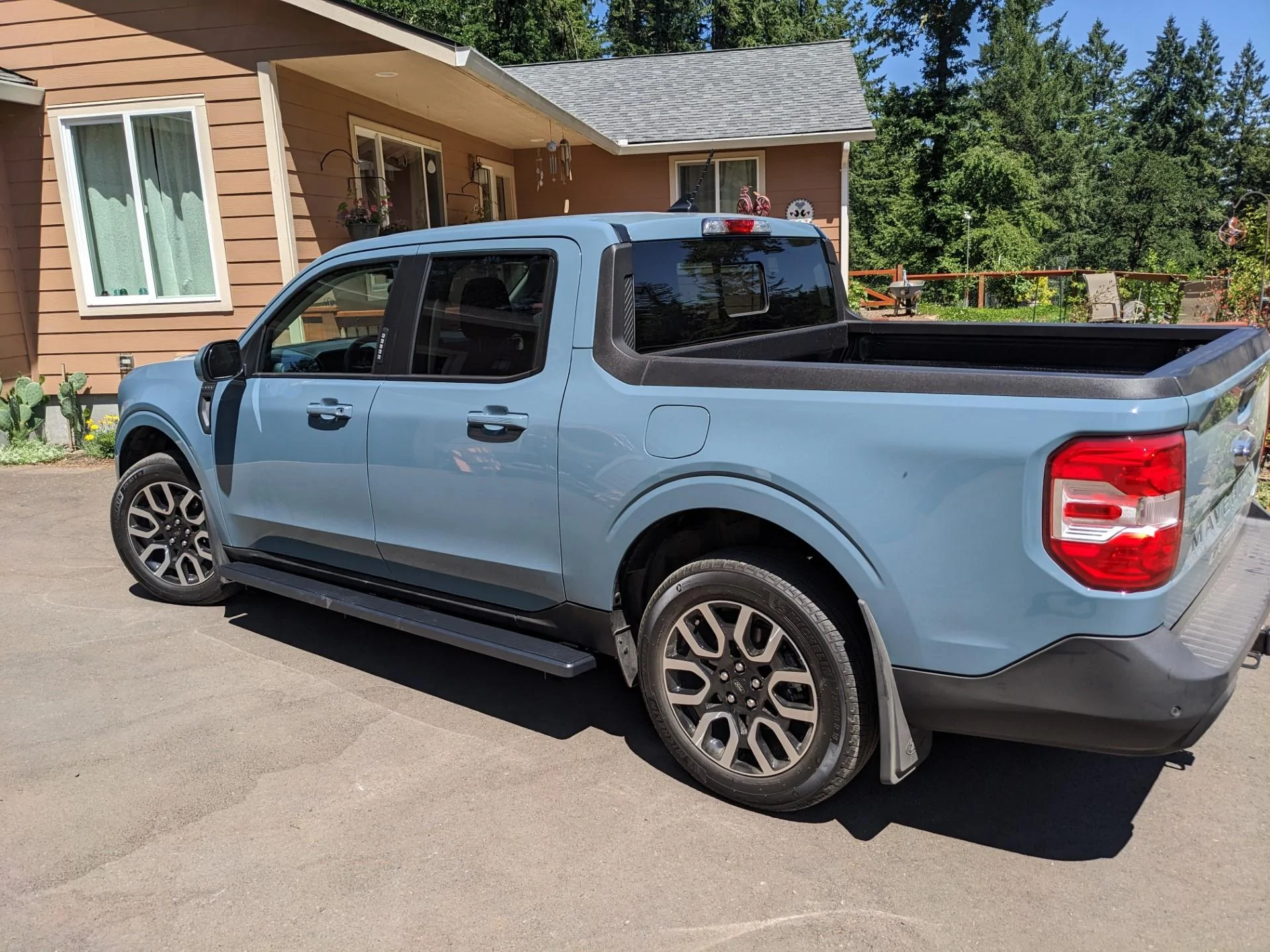

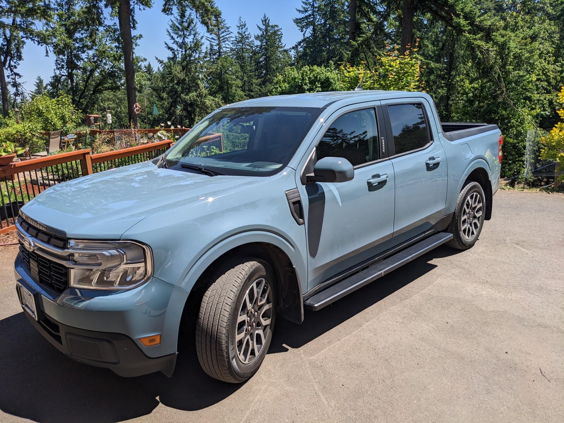

23 Lariat, Eco-Boost: I was given a new set of Six Inch iBoardauto.com running boards for my new Maverick (delivered by Amazon). My first impression was: Why? A Maverick really doesn't need running boards for the vast majority of owners and users. But since I had them, I decided to mount them and see what they looked like.
The kit has 146 individual pieces, it is a bit like assembling a puzzle. The instructions were marginally helpful but after reading through each step, carefully, I was able to figure out what they were trying to say. The instructions say to assemble all of the brackets before mounting them, but I found it was much easier to mount the brackets un-assembled. It was also really helped to have some sort of support under each bracket during mounting so I could get the supplied Spiral "S" bolts to line up properly. The "S" bolts move around a lot when loose. The "S" bolts are somewhat difficult to get into the predrilled holes in the truck body. It took some fiddling around to get them in correctly, but they will go in.
The rear bracket mounts to a supplied "Short bolt plate" which is supposed to fit into an existing hole on the vehicle body. The existing hole is too small to allow the bolt plate to pass through. I had to ream out (and repaint) about 3/64ths of an inch, of the existing hole to get the bolt plates to pass through the hole. On the passenger side this existing hole was clear of any encumbrances but on the driver's side there is a fiber shield of some sort (I assume a sound dampening cover). I had to cut out a small part of this shield to access the mounting hole and again, ream out the hole. The front mounting brackets use a "Long Bolt Plate" which fit perfectly.
The iffiest part of the install were the two-center mounting brackets. They are mounted using two "S" bolts that fit into existing holes, but the third mounting point is a pressure plate type mounting device that is forced up against the bottom of the truck using a long set screw. The problem with this is that the previously mentioned fiber shield covers this part the underside of the vehicle on both sides. The instructions do not mention this and do not provide any guidance on proper mounting techniques. I just left the shield as is and pressure mounted the bracket against it. I do think that it might be best to cut out a portion of the shield to allow the pressure plate to pass through and contact the truck body directly. I have tried to contact the vendor (APS Auto Parts Specialist INC.) to see if they could clarify the correct mounting technique. So far, no response.
All in it took me close to nine hours from opening the boxes to completion. The instructions say one to two hours to completion. That probably applies to someone who regularly does the job. If I had to do it again, I am sure I could get it down to under four hours.
Bottom line: They look okay but serve no useful purpose and actually make it harder to get in and out of the vehicle.

Good write up. As I looked at the pictures I wondered if the Maverick is too low for running boards? Looks like you answered my question. 😉
I feel as though I’d hit my shins all the time.
Are you going to keep them on?

I do hit my shins on them when entering and they rub against the back of my legs when exiting. Hopefully I will get used to it.

In reply to Oneeye's question: The top of the running board is at 11.5 inches from the ground. The sill of the front door is at 19.5 inches. The running board gains you 8 inches of lowered access. It might help in your situation. If you are taller this could make it difficult to bend over to enter the truck when standing on the running board.
The six-inch-wide board does cause some access issues. The company makes a four- inch and five-inch version which might eliminate the bumping of the shins and rubbing against the back of the legs when exiting.
I plan on using them for a while to see if I adapt to the access issues. The running boards look okay and even give the vehicle a "lowered" look. Right now, it is a toss-up on whether or not I keep them.

The install came out nice. How are you liking them?

The running boards look good but don't really provide any assistance for me when it comes to getting into or out of the truck. At first I bumped my shins on them when getting in but quickly adapted to that. Getting out is a different matter. The boards rub against the back of my calves every time I get out of the truck. If I am wearing cutoffs and have a need to get in and out of the vehicle several times over a few hour period, the back of my lower legs develop a mild rash. It is annoying. But I will probably adapt to it. These are six-inch wide running boards. The four-inch or five-inch versions would probably eliminate any issues I have.
I had a 2109 Ranger FX4 with running boards prior to this Maverick. I am 75 and needed them on that vehicle. Not so much the need on the Maverick.
I don't have any plans on removing the running boards any time soon.

Its been about 1.5 years since I installed these running bards. I quickly got used to them. No ongoing issues with bumping my shins when entering the vehicle or rubbing on my calf's when exiting. I will be keeping them on the ruck.
