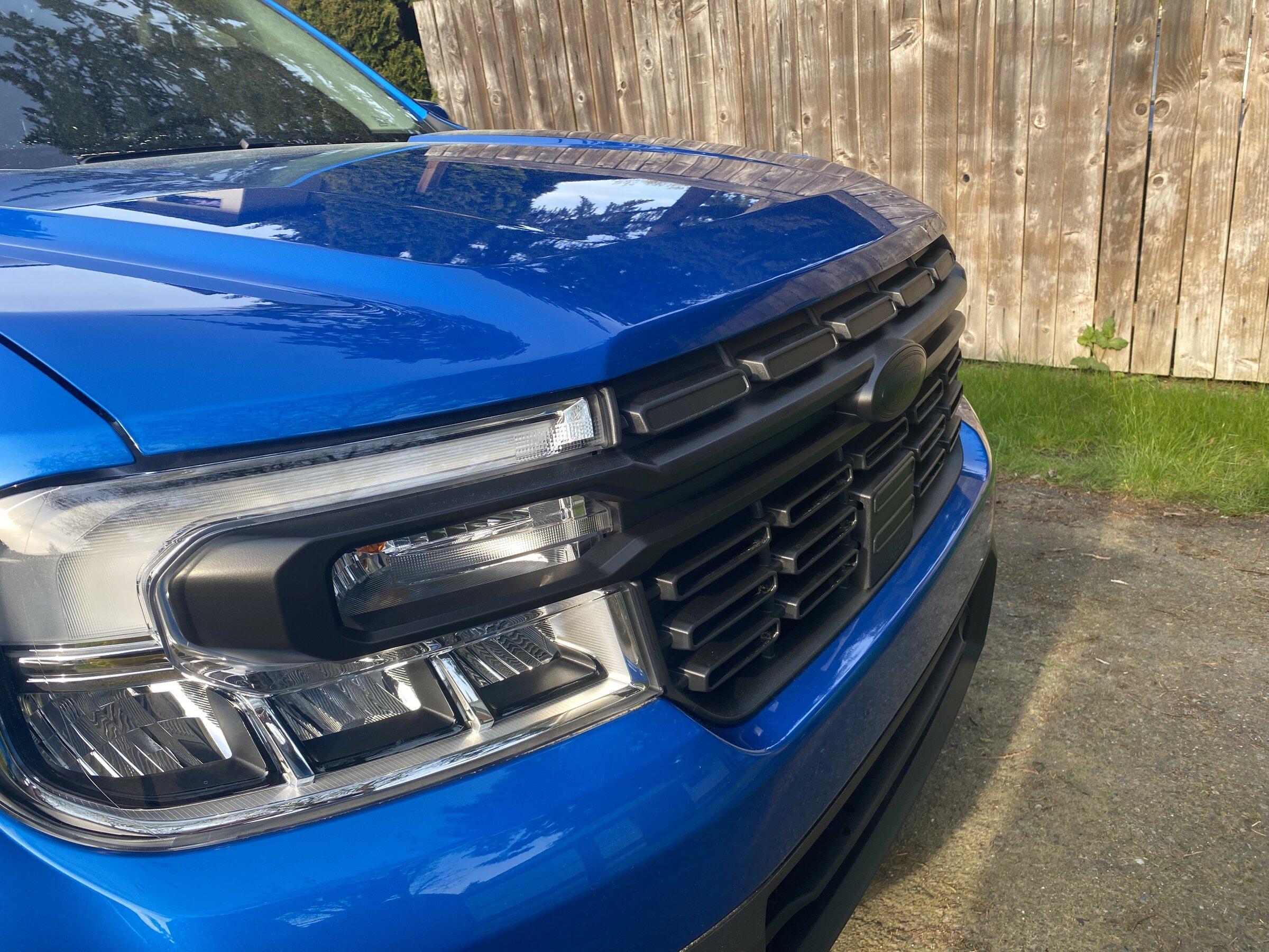

I’ve wanted to get rid of the silver Lariat grille bar since before I even got it and bought DipYourCar’s Hyperdip in the winter and have been waiting for better pnw weather to paint/dip it. After being without my Mav for nearly two months due to getting rear ended, I got it back and the weather finally cooperated!
I love the end result. I may remove the dip from the ford emblem but am leaving it as is for now. I also attempted the Lariat side emblems without success so I’ll do those again when I do the rear emblems. Dang those little letters.
I might have gone a bit overkill on the taping but this was my first time using plastidip and wasn’t sure about overspray. I did 2 very light coats, 5 min between, then 5 light coats 20 min between, and at that point realized I could have gone a bit heavier so did 4 more true wet coats, 15 min between (it got sunny out). I let it sit for an hour and began peeling, which was kind of fun. Very pleased with how it turned out. No more silver!
