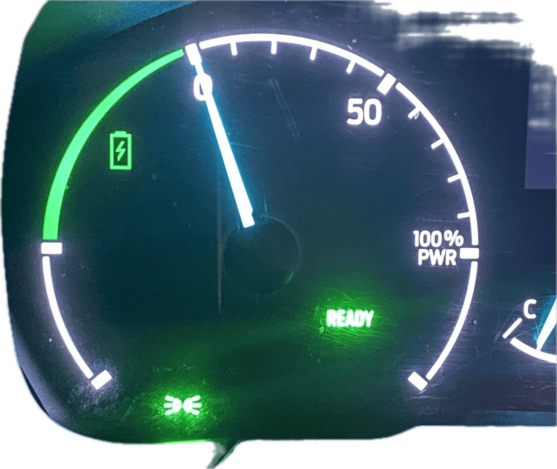

"a very odd thing happen with our 2012 Hybrid Maverick" :LOL:
Man, you guys are wet behind the ears with Maverick Hybrid. The battery is full, where does the energy go considering you refuse to use your foot brake down a mountain?
Don't just ride this ICE "air pump" all the way down. Do mix in some foot brake checks as well. You've got to produce brake dust in the mountains.
"Save the brakes"... :LOL: and instead ride your drivetrain all the way down???
I appreciate all of the responses and it certainly sounds like everything was working as it should have been.
Yes, I have a 2022 Maverick, not a 2012. Thanks for pointing out my typing error (I do re-read my posts before posting but missed this)
The mountain road I was on in the Smoky Mountains my be different that what you are used to. This is not a long downhill highway, this is a one-lane, one-direction, narrow mountain road where there is a turn every few yards and if you are going over 10 MPH, you are probably out of control. This goes on for about 30 minutes and, yes, I was on the brakes the entire time. That was why I was wanting a little additional slowing power from the engine.
