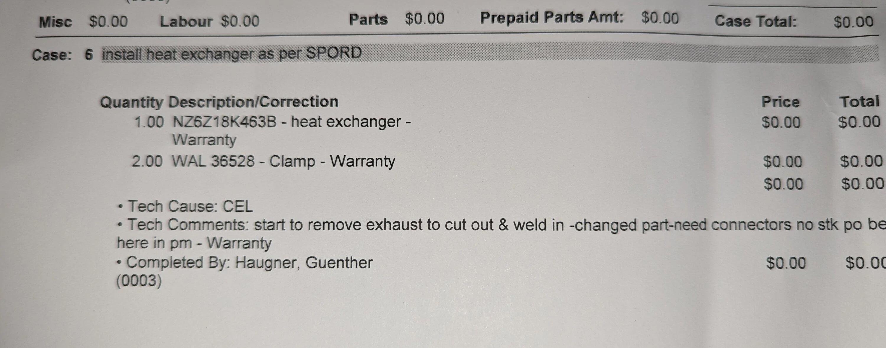

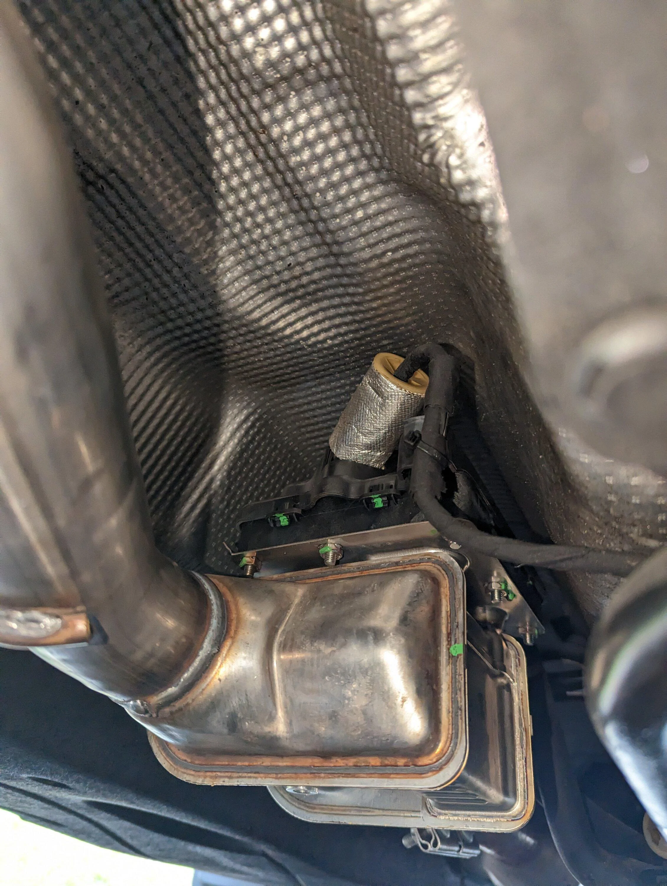

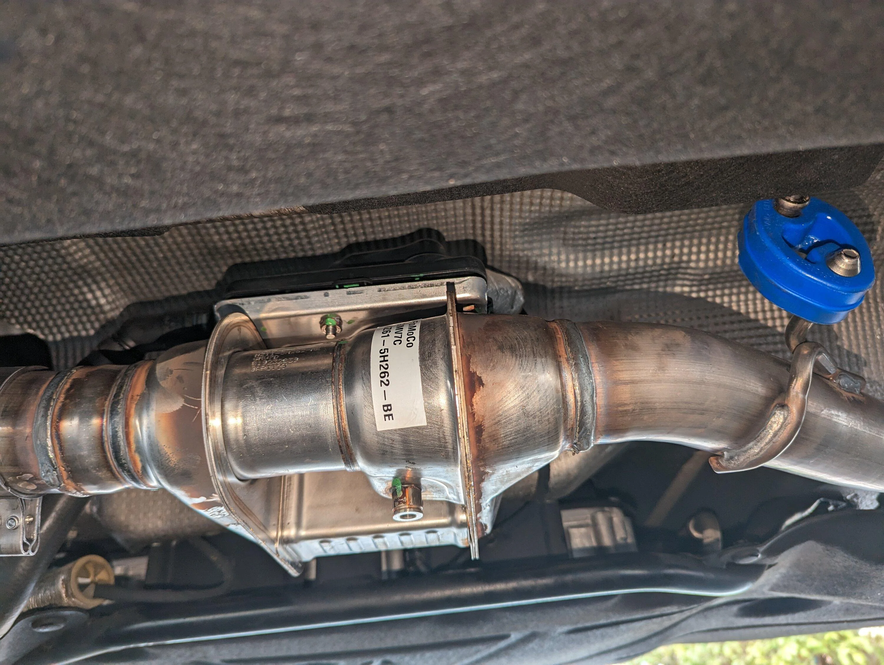

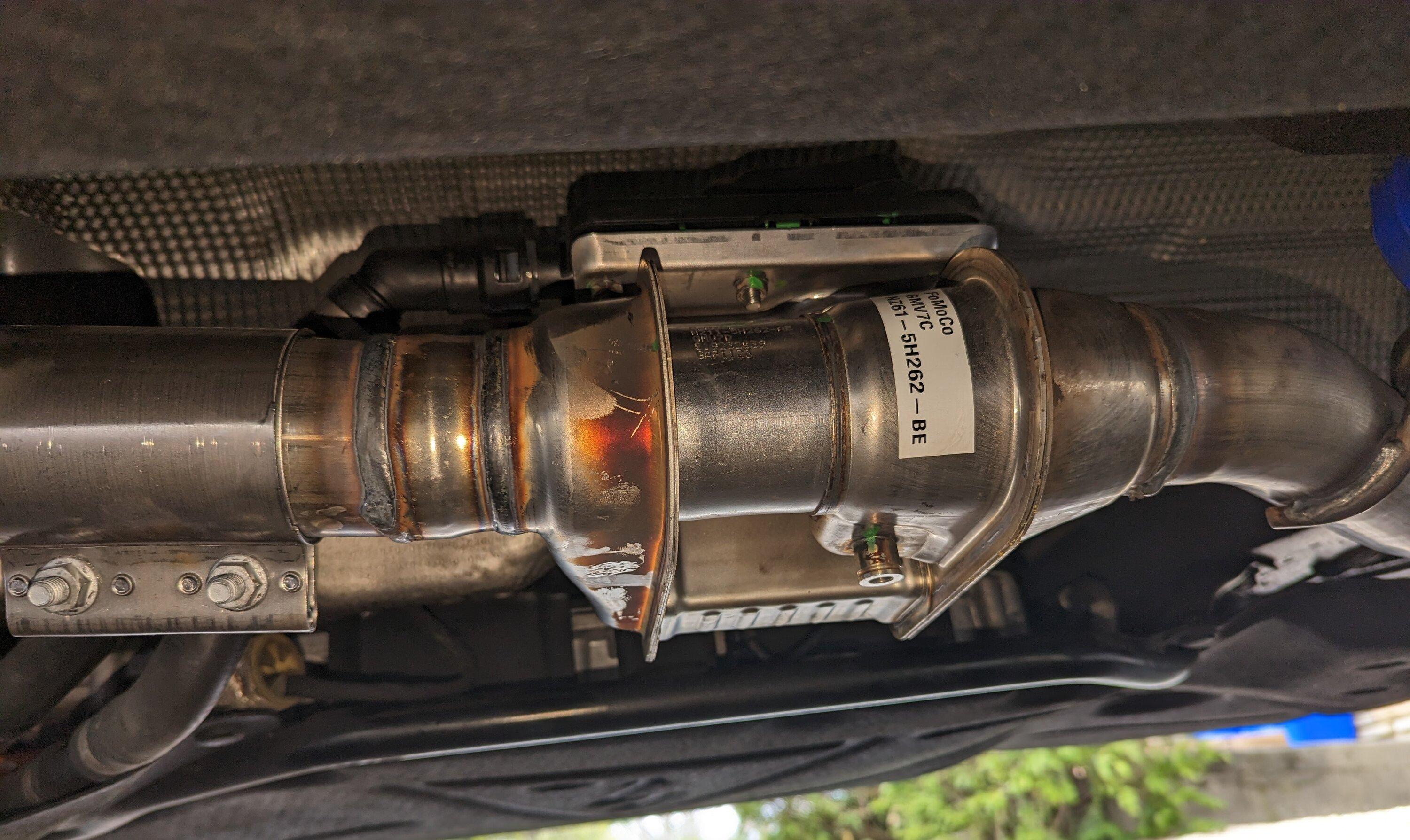

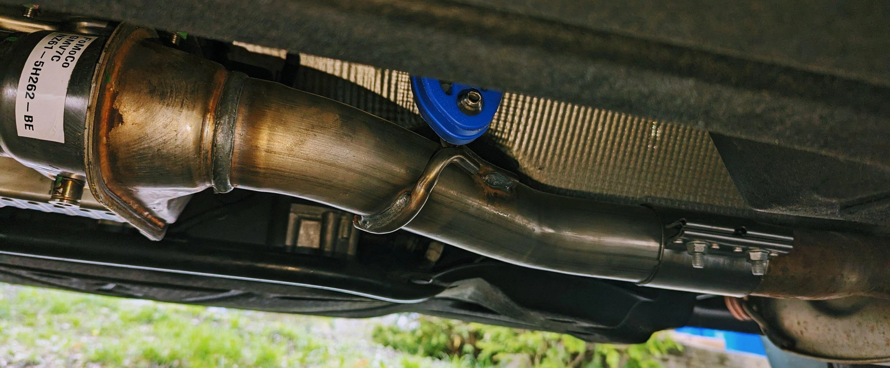

Check engine light appeared in January. Problem diagnosis: Faulty heat exchanger. Common Ford problem apparently. Here are the photos of the replacement unit and where they cut the exhaust and clamped new unit.
