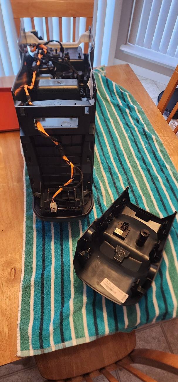

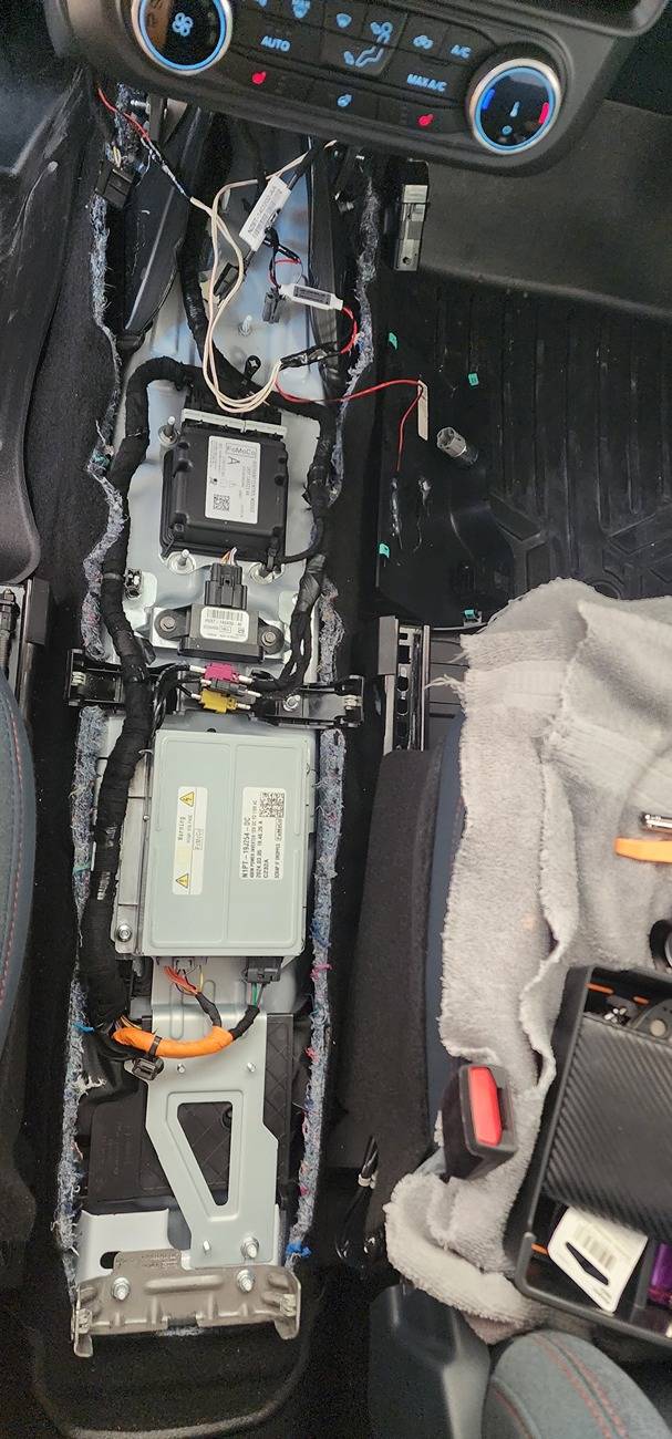

Total of 7 bolts and 2 side panels. Pretty simple removal process, I removed mine when I installed my ambient lighting in the front foot wells and the console area.
There is only one large wiring harness connector to undue at the front passenger side footwell area once you unbolt the top two bolts near the underside of the HVAC control panel
