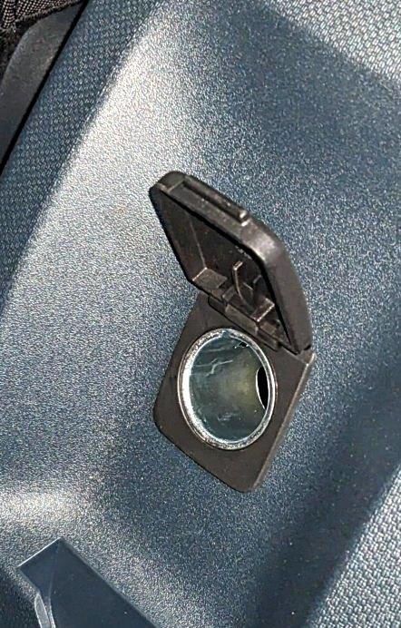

I grabbed these heated seat cushions right before a mountain trip for the rear seats. Only to find out they couldn't be plugged in the back, I thought there was a car lighter socket and 400w outlet in the rear. Whoops.
Ford Maverick How might I power rear seat heated covers? IMG_8116

My XL has a 12v power point in the rear of the console. I don't know the amperage, though.
Oh, that’s probably why I thought that I had that also. In my one week of shopping there was so much information to learn across all the models. Not all of us know every nuance of the truck we are getting especially when we are unfamiliar with the make and model, the irony is I have the upgraded luxury package and therefore cannot just plug in heated seats 😂
There's your solution. For the most refined stock look, get an XL.
Problem solved. Glad we could help.

My 22' XLT has a rear console 12v outlet. The owner's manual recommends a 15 amp, 180 watt limit since the fuse is rated at those thresholds.
I bought a Wagan heated seat cushion since I don't have a luxury package. It consumes 40 watts with 4 amps of DC current.
