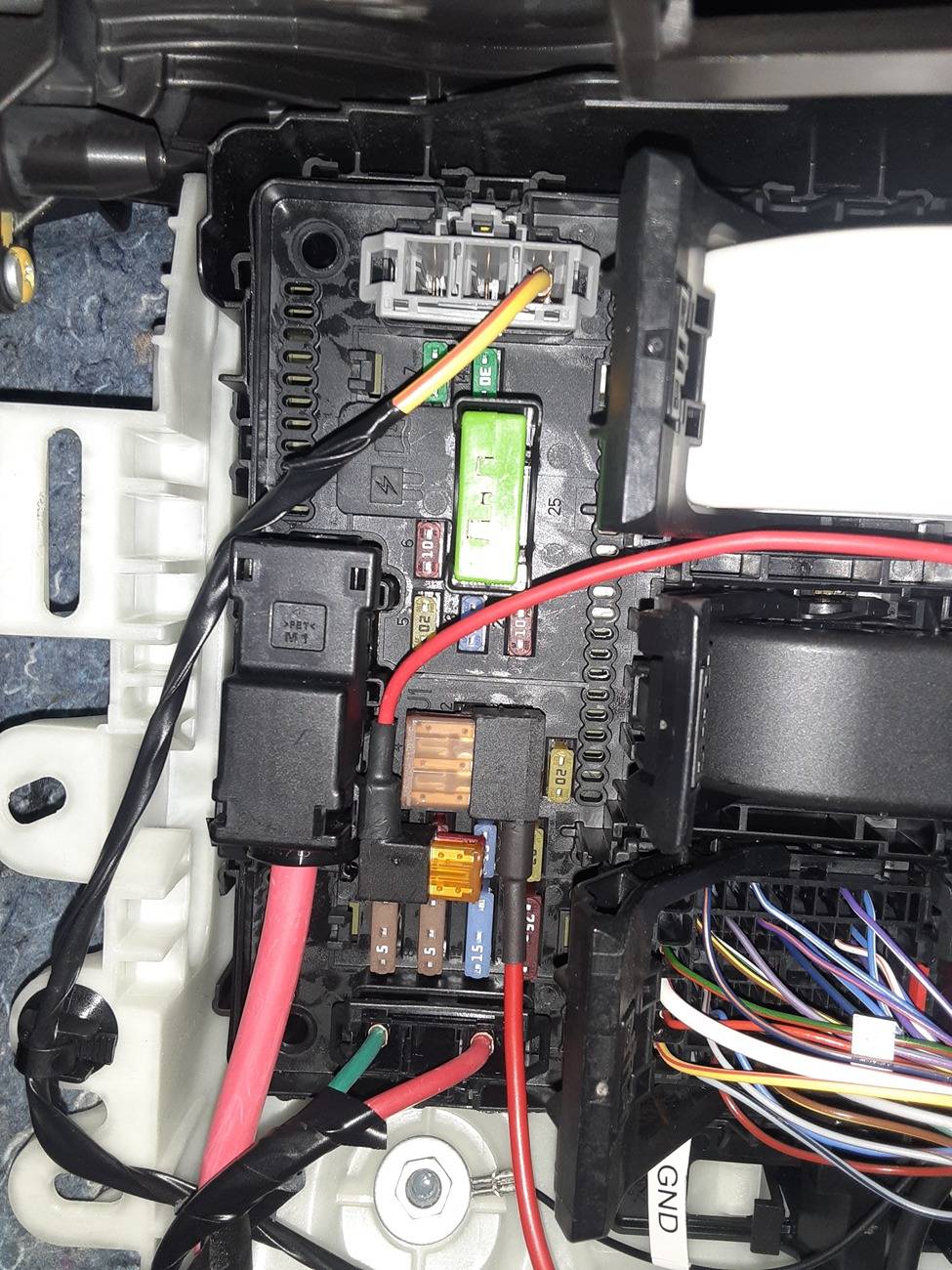

I checked the camera's continuous recordings and it apparently lost power about 3 hours after ignition was turned off.
I just went to the truck and when I opened the door, I saw the camera turn off. Now it refuses to power on from my tap regardless of the engine being on or off, but it works fine if I use the 12 v adapter. A test light shows power running to both fuses in the tap so I'm at a loss and just losing my mind here.
I'm going to check with a multimeter some time later today and try to figure out what the hell is happening.

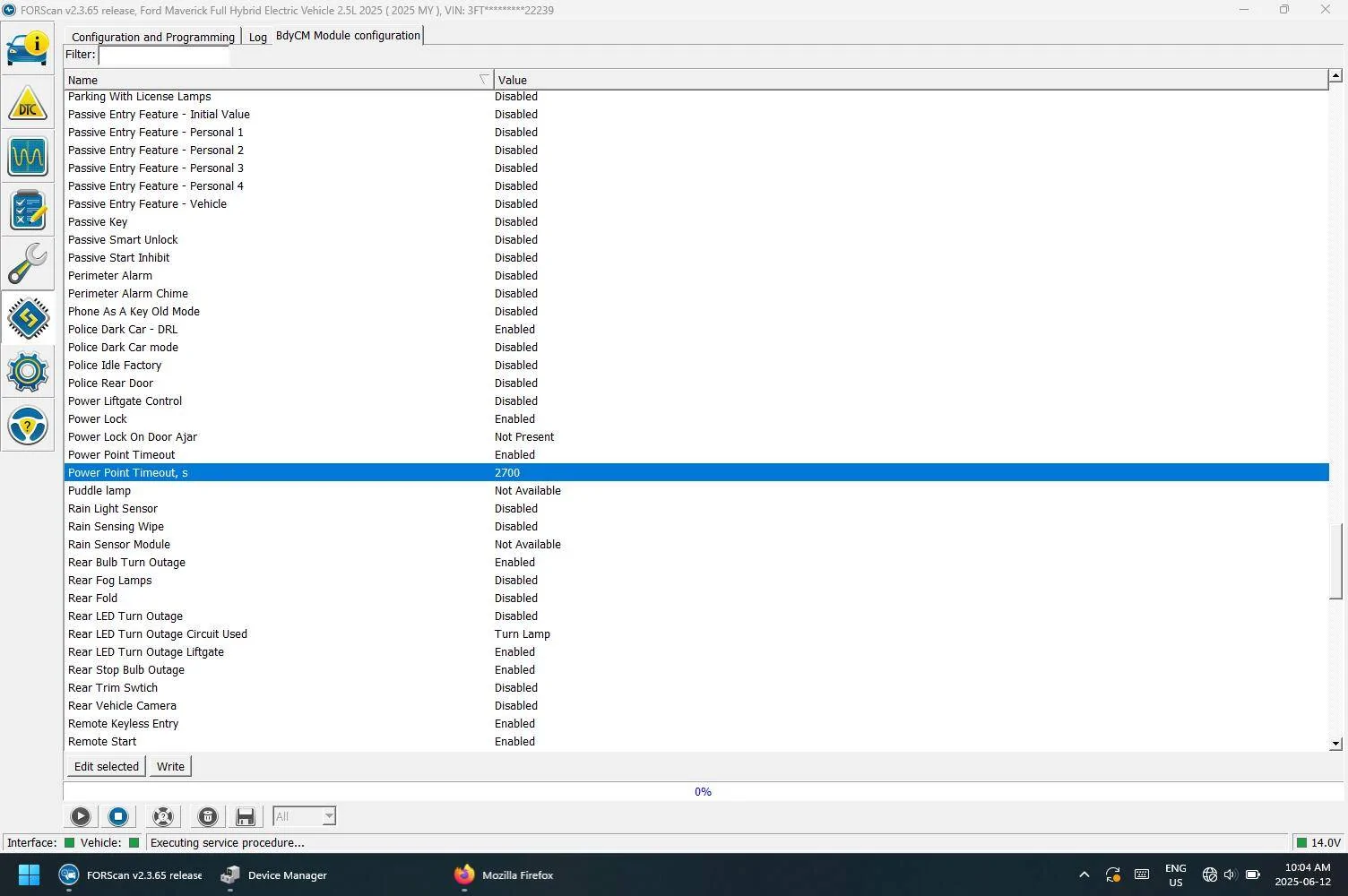

It was set to 2700 by default, yes. However, wouldn't that mean it would have cut power after 45 minutes? When I had checked whether the camera was still getting power, over 90 minutes had gone by.
I've changed the value to 300 seconds and checked 15 minutes later. It was still powered.
Surely I'm missing something here.
How about disabling the power point timeout and see if that makes it go off with key off????
What is voltage at the tap that doesn't work? Some circuits may have relay that disconnects if voltage drops below certain point (12.1v???).

Update: I gave up. For now. Needed the truck clean for the weekend and I won't have the time to chase electrical gremlins for a bit, so I tucked the 12 volt adapter's wiring where I could. It's not as clean, but at least it works.
To be continued.
