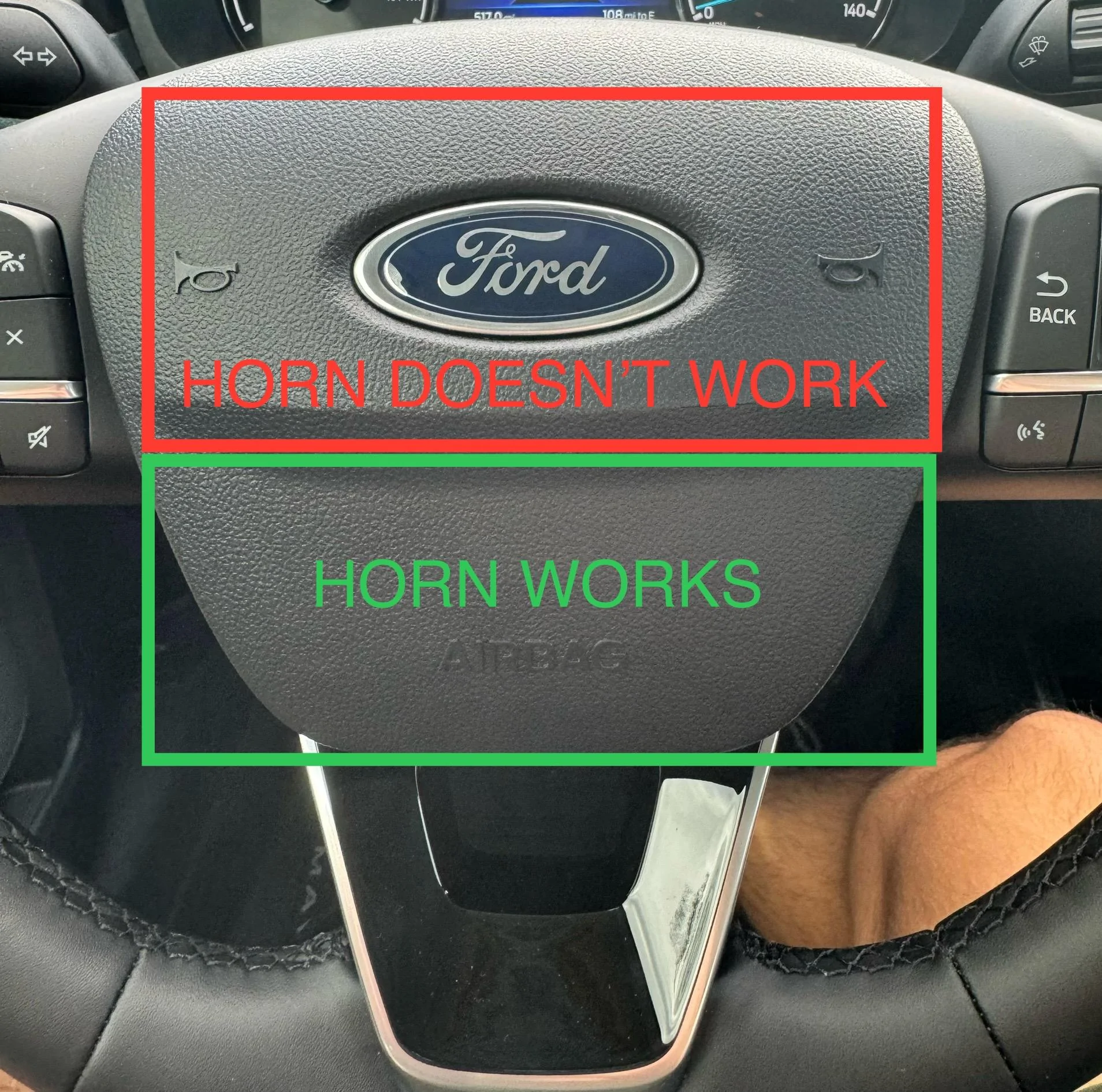

I have a 2023 Lariat Hybrid and horn works when pushing in green area…but doesn’t work when pushing in red area. Is this normal?
Just tried my22 Lariat works everywhere but no blow at the Ford emblem

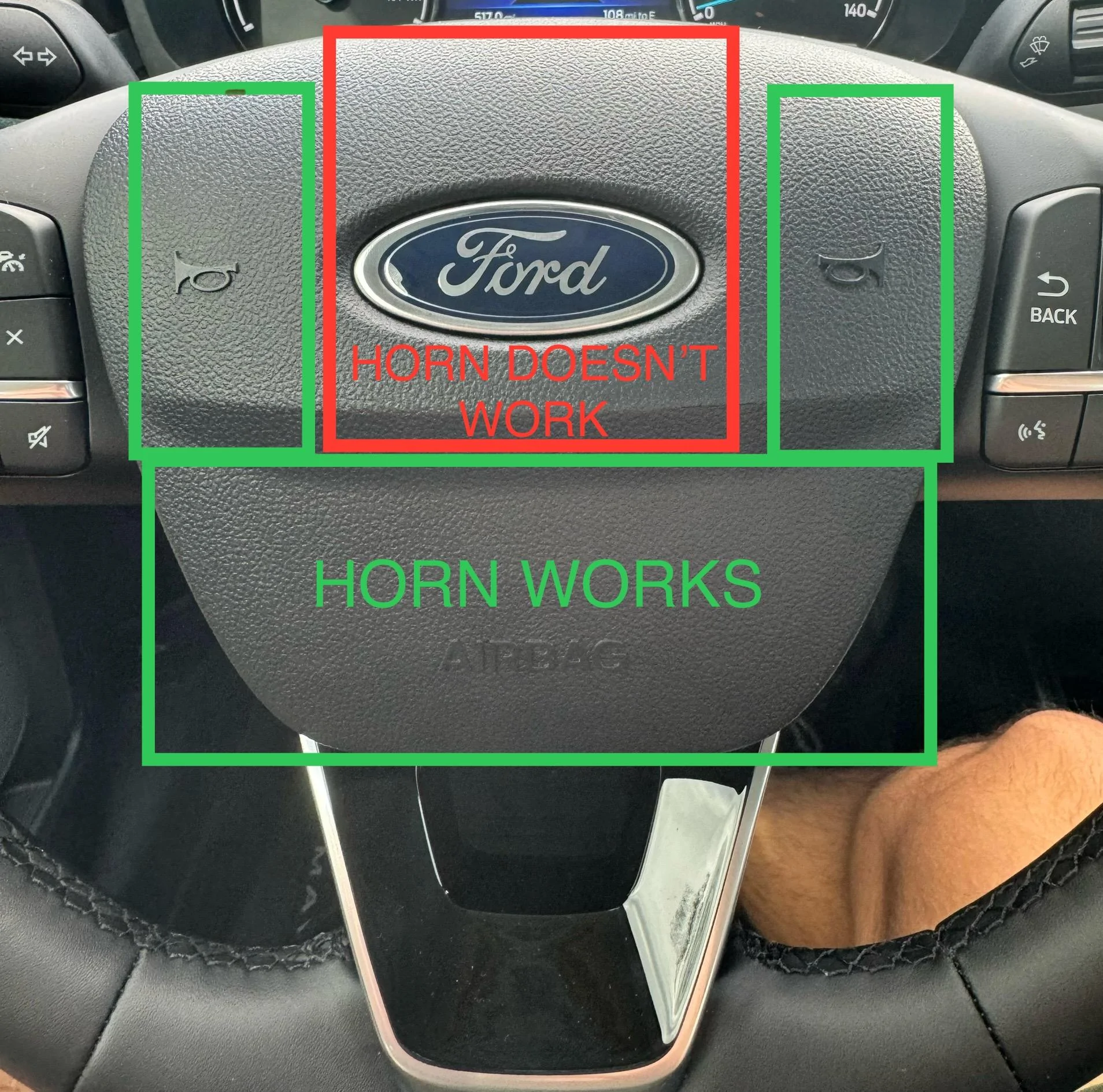

What do you mean? Like you push and nothing happens?
Try pressing on the horns, not the Ford oval.
Okay…so it does work when I push the horn buttons on the top left or right side. I get no honk on the Ford logo though.
Does yours honk when you push on the Ford logo?
My 22 is f’d like that too. Poor design I think
Thanks for clarifying that yours is the same as mine.
The top is just where it hinges I guess. Had a few other cars like that.
How is your Maverick? Does it honk when you push on the Ford logo?

I’m no expert, but I only noticed this because someone started merging into my lane and almost hit me. I went to honk and nothing happened. I instinctually pushed directly in the center (on the Ford logo) and it won’t honk.

Can you take a video of yours?
Can you take a video of yours? I updated my chart.
