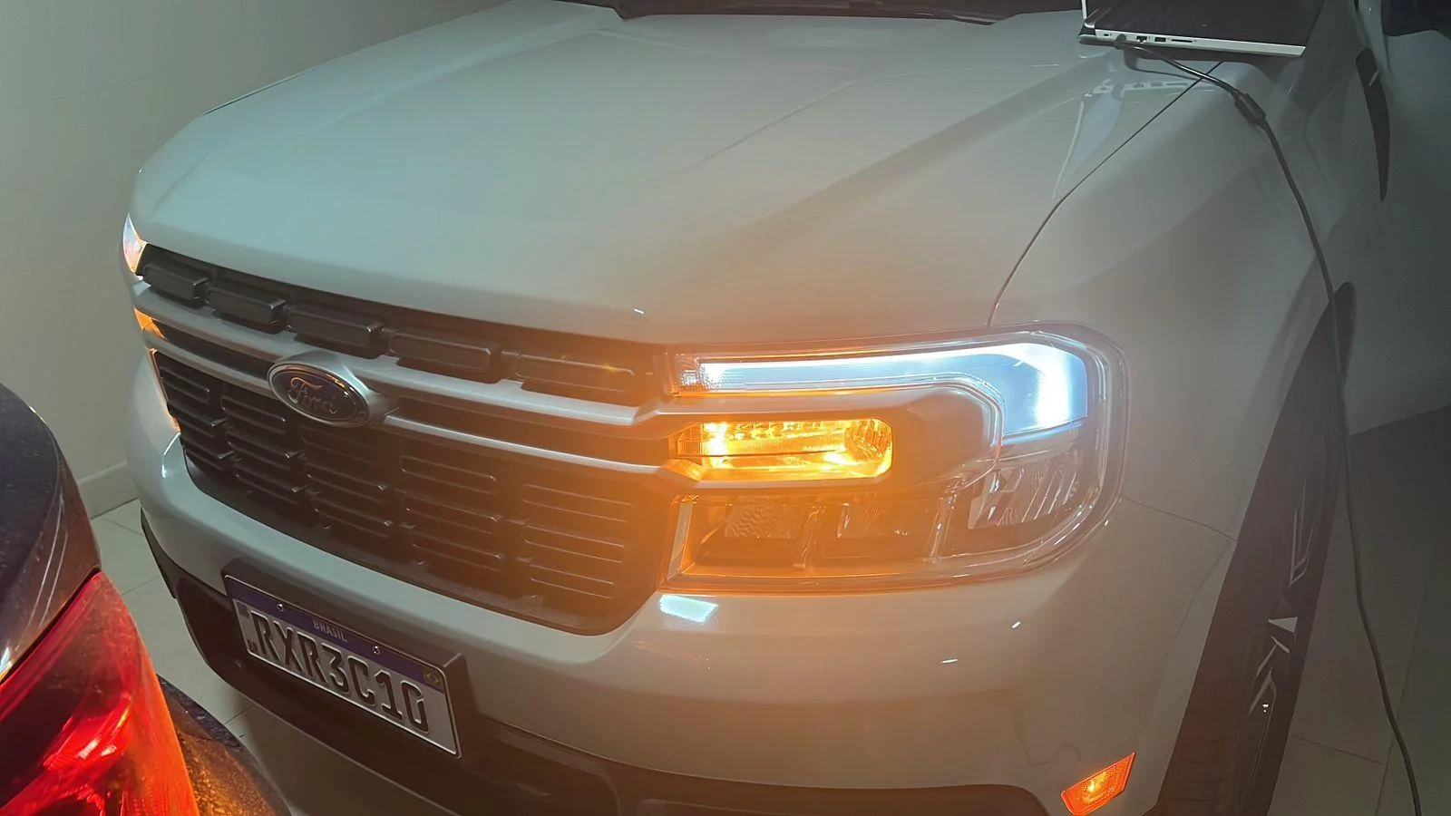

help!!! I have a ford maverick lariat fx4, I want to turn on the yellow lights through forscan, can anyone help me!!!

Which lights are you talking about?

I think he wants to turn the amber turn signal lights on as DRL's. Likely possible, but would involve playing around in forscan with the same settings as you would with an XL/XLT to use it as DRL.
But with the white Lariat signature LED...why?

Not sure it'd be possible on a Lariat as they don't have double filament bulb socket anyways.
One would probably need to get two dual-filament bulb holders, the two extra terminals for the sockets that connect onto the back of them, and then wire those to something like the marker lights or a key-on-hot. You wouldn't even need to mess with FORScan. Note: you can't feasibly tap the accent lights for running other lighting as DRLs; the lighting circuit gets unhappy with it eventually and stops working.
